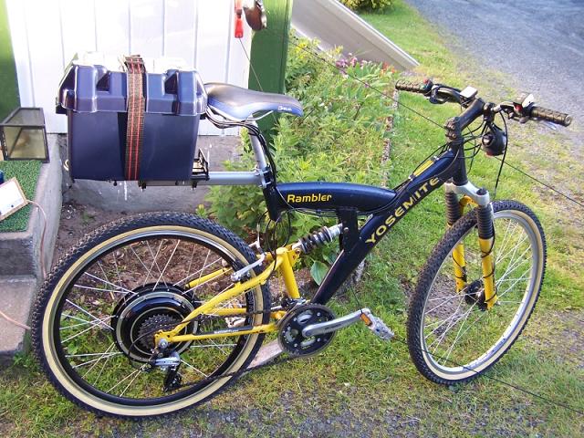

I received my hub-motor from www.goldenpower.com today, and have now mounted it on my bike. :D
The motor are 36V, 750W.
Everything worked perfectly at first test run. :D Top speed downhill was 50km/h; around 35km/h on flat country without any pedaling, and 25-30km/h uphill with light pedaling...
I'm using 3pc. 12V, 17Ah batteries, but alas, two of them seems to be more or less dead; they were flat after a 4km run... :( Though, they were old, and i had them laying around, so no great loss... ;)
More pictures in my own gallery...: http://mwlmf.net/gallery/ElBike

Looks great! I'd add a front basket for odd stuff, helmet, gloves, bottle-o-water, sunglasses, bringing stuff home from the store, etc...
You may even want to consider adding a 45-degree brace from the bottom of the trunk support rod to bottom of the seat tube, I have heard of the trunk pole clamps cracking over time.
I also lost my key and had to cut the lock off the cable, so I got a combo lock thats programmable to 4 digits I can remember.

Nice. Yeah, I would brace your backpack, too. If it takes the seat off, you could have some trouble getting home.
You have to baby agm's in that kind of application. The 1/2 U1's you are using are commonly used in portable auto jump-start boxes in case you have to get replacements.
They sulfate if you don't use and recharge them gently. They were not made to deep cycle.

 Those things are MUCH easier to install on a conventional type bike than my installation. I'm glad it all went smoothly for you. I went 1000w 48v app. You may consider the nicad, nimh or even the lipo options on batteries! Any type of lead acids just get too heavy.

Yes, i have to get a basket. One point of this 'motorizing', was to make it easier/more fun to take the bike; not the car to the store etc... ;)
I'm thinking of finding another way to mount the batteries. The box with batteries etc weighs around 15kg now; that luggage carrier says 'max 10kg' ;) No offroading with this bike now as it is.. ;)

How "strange" does the handling feel with 15kg of battery that high?
Looks good!

Actually, the battery box and the seat works fine as a mudguard. :) As for the front wheel... I just had a ride on wet road, and i'm still clean in my face. ;) The frame are rather thick on this bike, but i do see the need for a mudguard over the frontwheel in the long run...

As for riding on the road using the motor with light pedaling, the weight are ok. But as soon you stand up and realy pedal; wiggling the bike from side to side, it's like someone pushing the bike sideways... :D
Idéally i would have mounted one battery on each side of the rear fork, and one laying on top of the baggage carrier; that would have made it much more balanced. (But that's metalwork, and i'm not so good at metalwork... :-/ )
I also do see the advantage of not using a mountain bike with rear suspension. It's easier to mount sidebaskets to the luggage carrier on standard bikes.
Or preferably bought that 36V, 16Ah LiIon battery pack at 5.26kg from Goldenmotor... ;) (But that's $425 + $96 for shipping.)

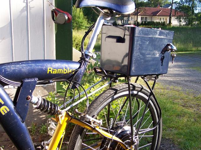

Maybe connect (somehow) the seat area fasteners to the bolt at the yellow end of the shock.  It wouldn't be dealing with a great amount of force, after the batteries are near the axle.
Bet the range would increase considerably with townie-type comfort-bike road tires.

 I went with a 6 gear cluster shimano 11-34 as it was the same in total range as my original 9 sp cassette. I'm not as concerned at mid-range positions since so many overlap and are nearly the same. front crank is 30-36-50.
 I really wish i could come up with a decently priced taller crank gear as at full speed, I can get very little pedal effort going! you may have to re-adjust your spokes a bit to get the wheel better aligned. I know with my 6-sp the chain is REAL close to my fork. I mainly just used some washers to get good wheel alignment.

Did you think of mounting two more luggage carriers with some L-brackets to the bolt at the yellow end of the shock absorber, and strap one battery on each? (And the third one behind the seat.)
I've actually taken your advice, and changed the tires... ;) I don't know about the range yet, but it's definitely a smoother ride. ;) I seldom use the bike for offroad, so i really didn't need those tires i had...

A rack like in the link, but where the factory intended it to connect near the seat,
run it down to the shock with extensions?
http://www.topeak.com/products/Racks/SuperTouristDXTubularRack
Not sure what the differences are between all the variations, so that specific one may not fit.
« Last Edit: June 19, 2009, 04:30:08 PM by ghurd »

This guy has a rear suspension bike and added aluminum braces from the rack to the brake arm pivots

This guy added an angle brace to his trunk pole which is similar to yours

That could actually work!
On 'normal' bikes, there are 2 holes at the end of the fork where those racks are fastened; i got the same holes on my fork, so adding 2 bars from the rack to the bolt where the shock-asorber are, should work...

Just mounted a new rack, suggested by you guys. ;)
The fastening at the end of the forks was purpose-built i think. The top-front support bars was two alu-bars just 4" short, so i (by chance) had a alu-tube with the same dimension; 8mm/2mm wall. I cut it to length and hammered one end flat and drilled a hole for the shock-absorber bolt; perfect fit!
