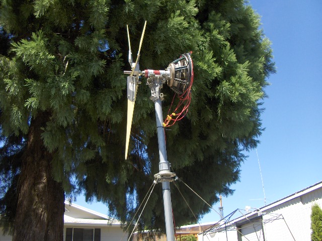

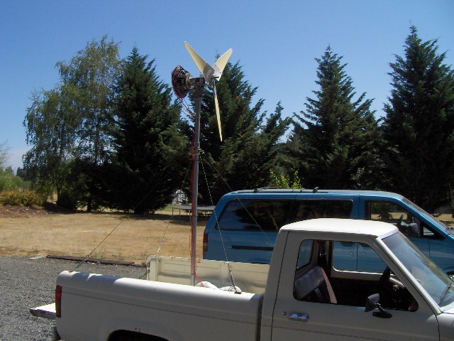

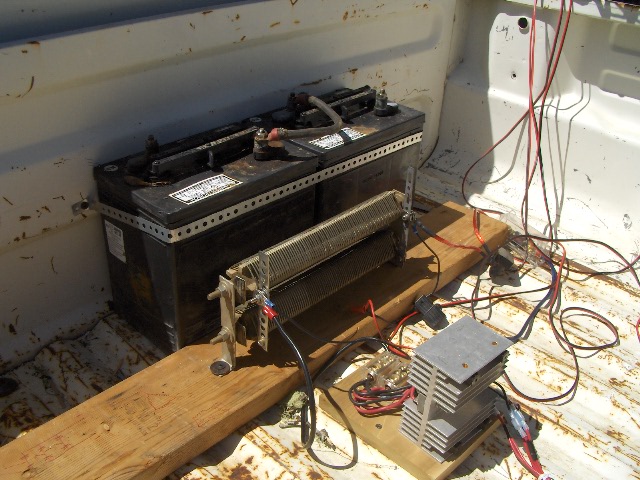

I've sold my old S-10 that I used for wind test.
So I set up my Ford ranger all electric truck for this test.

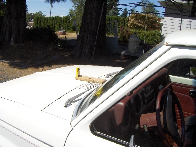

I mounted an anamometer on the hood just in front of the drivers wiper. The MPH readings on the truck speedometer were faster the the mph #s on the anamometer by 5 to 10 mph.
I'm sure the wind up at the blades was even faster yet?

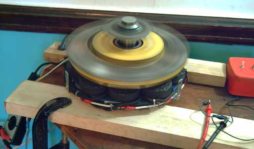

I used 2 diferant loads. 1 load was two 6 volt golf cart batteries wired for 12 volts.
The other was a 2KW 1 ohm resistor.
Here is the wind generator with my blades atop the mast in the bed of the truck.
Strange thing about the resistor load. The blades seem to be in bad stall  up to about 15 mph. There was very low power till then once above 15 mph they broke loos and power went way up way fast.
I'll do all the # crunching and report back.

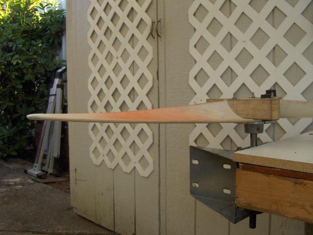

OK I'm sure this posting will stir up some dust. And the Sh%&*%$ will hit the fan.
Hugh Piggot wood blades.
I'll show the test #s for the battery load first.

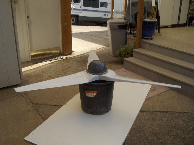

Now for the "Jerry Blade" battery load wind test.
 10  mph    51   watts
 15  mph    64   watts
 20  mph  119.25 watts
 25  mph   355   watts
 30  mph   562.5 watts
Now the "Jerry Blade" resistor load wind test.
 15  mph    5.6  watts
 20  mph    525  watts       that was 21 amps at 25 volts
 25  mph    780  watts       that was 26 amps at 30 volts
 30  mph   1050  watts       that was 30 amps at 35 volts
Keep in mind in the resistor test the voltage was alowed to klime as high as the resistor and the alt would could produce. Not so with the battery load. The battery load caped or clamped the voltage to 15 volts.
It was very dificult for the blades to break loose at low wind speeds with the resistor load but once the did the power came on fast.
In the battery load the alt was free wheeling until the alt hit 12.7 volts the the battery began to load the alt and blades.
OK guys I've got my armor on let the flack begin.

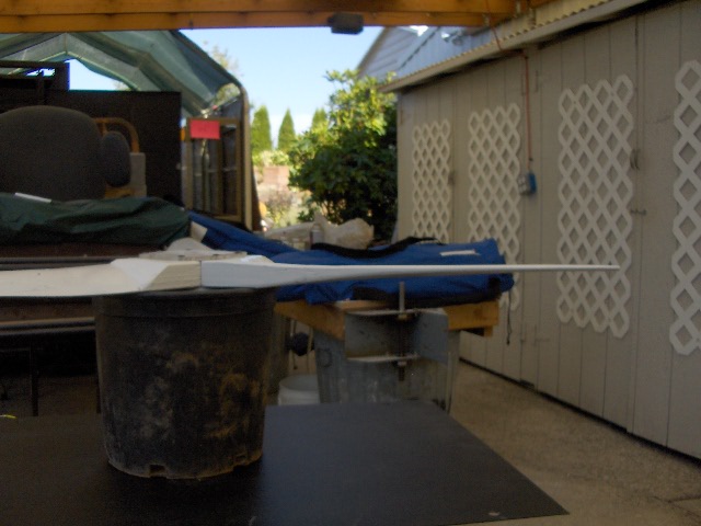

The "Jerry Blades" are in the first truck picture.

Re: Hughs 4ft truck wind test.
« Reply #2 on: August 10, 2009, 06:59:01 PM »
The nose cone or nestle was just setting there for looks. I did not have it on the blade during tests.
After looking at the test #s I see why the "Jerry Blades" Are a good match for my Garbogen. The Garbogens cut in is about 100 rpm higher then the rotor alt.
This allows my blade to ramp up some rpm befor loading. Even I'm surprized about the good MPH range on the foam pipe blades.
They definetly worked very well in the normal wind speed range. The 10 to 15 mph range.
The stator got slightly warm but nothing eccesive. This unit is Jerry rigged so heat was not an isue allthough the air temp was in the 80s during this test.
I was happy to see 1 KW without any stator heat damage.
I'll definetly be building the 8 ft diameter pipe blades for my NEO 14-11.
That will definetly slow down my e-truck.
« Last Edit: August 10, 2009, 06:59:01 PM by Jerry »

Well done Jerry this is all good stuff.
Any chance that you could repeat the test with Hugh's blades with a 2 ohm load resistor?
I suspect you have more twist on the tip of your blades than intended, you look to have done something strange marking out the trailing edge but even so I doubt that it is far off the mark.
It is normal with a resistor for the start up to be poor, ideally you need a different resistor value for each wind speed.
Ideally you need to run at a set speed and adjust the resistor for maximum output for each blade. That is the only way to be sure you are matched.
Certainly you have proved that your blades are a better match for those test conditions.
I would guess that the prop wind speed is above the speedometer figure by quite a bit. Sadly the anemometer reading mounted there is useless so ignore it. Take the spedo figures and they are fine for comparison.

I agree with Flux, that anemometer is in a bad place. The wind speed over a bonnet varies a lot, depending how far away from the nose your taking the measurements, and if the flow has seperated from the bonnet skin or not. At the back of the bonnet, and bottom of the windscreen, is a high pressure point. Thats why the air vents are there, the air is forced into them.
I would trust the car speedo, so long as your not driving into a head wind. Or mount the anemometor on a stick a couple of feet above the bull bar.

« Reply #9 on: August 11, 2009, 08:30:37 AM »
Hi all.

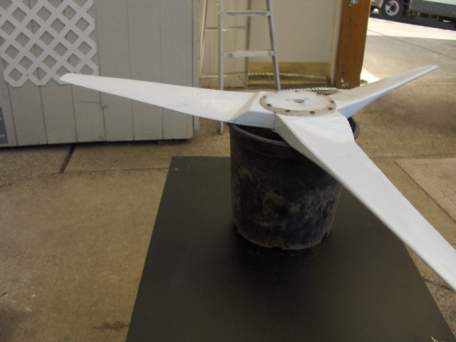

I suspect the problem with the wood blades is my wood carving ability.
The were made in haist. Althogh I atemped to follow the book and they looked the part I'm still not sure they were close enough.
This is why I asked the question and hoped Hugh would take a look at the blade pictures.
I know it would be hard to tell but he is the master blade builder and they are his design.
Well at this point it dose not matter. On the return trip there was a big bang.
My Hugh blades are no more. I had used a thin  pice of plexy for the front round and it broke just above the 30 mph mark.
The bang was vey loud the truck shook vialently, nearly went in the dicth.
If someone has a good set built to Hughs specs I would be more then happy to test them and then return them.
I do know for my preferance I'll be building more pipe blade for the disc rotor type machines.
Even with the 100% perfect wood carved blade I'm not sure they'll be better, but hey thats just my opinion.
It was fun and intresting. One thing for sure there was over 1 KW comming out of the littel alt on a warm day for a short time and it survived just fine. Even the big bang did not hurt it. Scared the $%^T out of me though.
Thanks for all the input guys.

Yes the wood blades were (RIPices) but I don't think enough to effect the flywheel aspect much.
I think its the big scoop at the root, The steep root angle and the quick  but smooth transition to flat  towards the tip.
I think the wood blade presents more of a flat surface to the wind and the scoop of the foam pipe blade just extracks more root power.
I'm not sure of the angles on the wood blade. The "Jerry Blades" are 23 degrees at the root and 2 degrees at the tip.
I don't know how you could or what you would call the angle of the foam pipe blades at the root scoop. I just know it looks very steep.
I'm thinking this is where all the startup touqure comes from.
« Reply #13 on: August 12, 2009, 01:23:54 PM »
How about putting the anemometer all alone on top of the stand to calibrate it?  You could drive around with a friend watching the anemo while you maintain at a constant speed, then relate the numbers later so that you can make the correction.  Try driving into the wind, then against the wind and taking the average, even if it is a calm day.  Does the Ranger have cruise?
Probably doesn't matter for comparitive numbers you want, but then OZ comes along and starts working out the aerodynamics...  I would have, too if he hadn't beat me to it!
Wait a sec, that's your electric Ranger, isn't it?  You could tell the neighbours that you've invented a machine to charge its batteries while you drive.
Infinite range is yours!
Admin!  Kurt!  Tom!  Delete this post for claims of over-unity!
« Last Edit: August 12, 2009, 01:23:54 PM by SparWeb »
« Reply #14 on: August 12, 2009, 08:28:12 PM »
Thats my most aked question when the see the wind genny in the bed and I tell them the truck is electric.
« Last Edit: August 12, 2009, 08:28:12 PM by Jerry »
