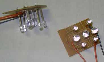

Those LED's on the lights I sent Bruce are 107 lumen per watt or better at 350 mA  They are being driven a tad over that, but they are rated to handle up to an Amp if properly heat sunk, which they are.  They are rated for at least 50000 hours at 700 Ma and a junction temperature of 130 degrees Celsius, and it the lights Bruce has, they are way under at about half on both counts.  Credit where credit is due, the driver circuit IS Commanda's Circuit 4, with a bit of assistance with the values from Commanda.  Even with the inherent inefficiencies of the variable resistance driver, the whole package should give an efficiency of over 80 Lumens per Watt from a typical 12 Volt battery.  Rich
A re-post of a couple of pictures of the original prototypes for reference.  These from last year had LED's with only 86.7 Lumen per Watt or better, as the new ones for this year are 107 Lumen per Watt LED's:
« Last Edit: January 11, 2010, 07:08:32 PM by richhagen »
