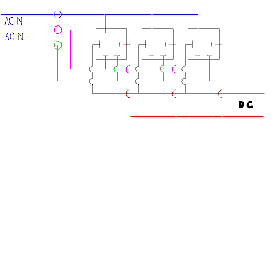

The benefit of building a custom PMA is that the resulting wind-gen will extract the best possible amount of power from your wind. I think converting a garbogen or ECM motor into a generator looks like a good starter project (Use "Google search the board" and save links you like in a file)
http://www.fieldlines.com/story/2005/4/13/33217/7314
"...Hi ghurd, These PVC blades are perfect for the GE ECM motor. I'm flying 4 GE ECM motor conversions with this blade its a real good match.
I see around 250 watts out of the ECM at 30 mph. Seeing over 100 watts at 15 mph.
This is the the 1-hp unit with my coil reassignments. Also have 36 5amp diodes on this conversion. This conversion was covered in a post a while back.
Not bad for a motor pulled out of a dumpster and a hand full of 25 cent diodes, 3 $15 blades and the rest made from junk..."
