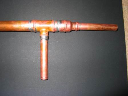

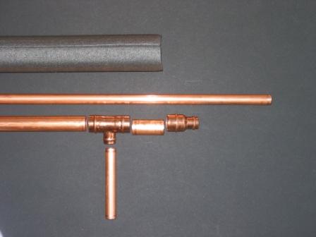

Hi John,
Here is my prototype. It is a single tube in tube unit but I have not had a chance to test it yet. I was going to run several together depending on efficiency.
Here is a kit of parts:
I have soldered up each end (OK I'm no plumber!)
and the whole thing slips into an insulating jacket
I have used 22mm and 15mm pipe (24mm ish to 1"?). I have since found that I can get a 22mm/15mm/15mm 'T' fitting that I can use to replace the 22mm/15mm/22mm and reducer that I used in combination.
My plan is to build a prototype solar water panel and then run a couple of pumps with some hose and monitor temps in/out for both circuits. It will, of course, run with counterflow to get as much transfer as possible.
« Last Edit: June 06, 2006, 03:36:00 PM by stevesteve »
