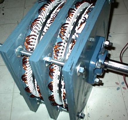

Is it possible to stack two or more stator and rotor assemblies on the axial flux
alternator? If so can the back disk of the first unit also be loaded with magnets on the backside to be used as the front disk of the second alternator? Thanks, Walt

It's ok to stack the rotors and stators along the same shaft but do not place more than one set of magnets on each rotor plate for each generator stack...this has been tried before and doing this is will cancle out the magnetic field for the inside plates.

  I built one up about a year or so ago, I didn't give it a thought about the magnets pulling the flux toward each other through the steel disc.  I calculated it would produce around 5kw and it only made half that when completed.  If you use separate discs for the magnets then it will come out ok.
  It has 2 discs with magnets on both sides and 4 stators.  Works but not real well...

   I can get more power from a single rotor/stator unit than this one produced so basically it was simply just a fun project, disappointing but fun none the less.  Dan is right if your not pressed for space a larger diameter with more poles will do the job.  I've built up to a 3.5 Kw unit on an 8" disc platform but after 2.5 Kw they tend to get hot and need external cooling.  It really depends on the amount of power your looking for and the space required to achieve it.
    Spacing the discs even slightly will break the flux path between the magnetic discs and cure the problem.

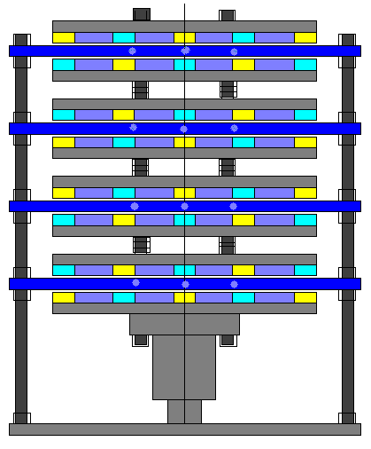

I am new to this board but I have built a single stack system with 24 mags and 9 coils for a VAWT System it works great. I am looking to try a 4 stack system. From what Ive gathered from other post the spacing between  rotors are key. I drew out a diagram of what I understand should work, the center rotors would have about 1" clearance between plates do you think this would still have a flux problem?
