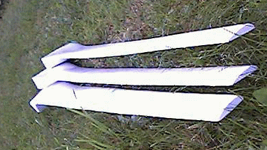

I am finishing carving my blades and have a question on what to do about the tips. My rotor dia. is 10', a varible pitch hub, startup at 45 degrees and feather to 0 degrees, 150 to 250  rpm's, blade tip width is 3.5" , 3  blades , simple airfoil on backside,flat on front,no twist or taper. My question is should I round the tips or just leave them square? I still can't find any info on carving a blade that uses a varible pitch. Can anyone help?

I'm not sure which surface you want to round.
My understanding is as follows:
When you view the blade tip "face on" you should leave the profile essentially intact to the end of the blade.
When you view the blade tip "edge on" this should be rounded.  This will slightly affect the "face on" shape.
Any time you have a wing that generates lift you have higher pressure on one surface than on the other.  At the tips, this pressure differential is trying to equalize by way of the air under the "wing" trying to rush around the tip to the top.  This is largly responsible for what are called "wing tip vortices" (sp?).  A wing tip vortex is a cylinder of rotating air at the tip of each wing (you can see this when a plane flies low over the water or dusty ground).  The energy it takes to disturb this air is lost in the form of additional drag.  I don't know how significant this is for turbine blades.
You can see the general shape by looking at the end of an airplane wing.
Hope this helps,
If I'm all wet, someone please straighten me out,
-Dan M

Thanks Dan for the info. Would I round it off from the side that has the airfoil? approx how far back do you think?

I'm trying to recall the shape of the end caps on small aircraft wings.
I think the radius on the end is about 1/2 the thickness. Slightly larger toward the low pressure ("airfoil") side, slightly smaller toward the high pressure (flat) side.
This is just from memory.  You may want a second opinion before taking a belt sander to your blades.
Good Luck,
Dan M

Remember the British Spitefire.  It's wings were oval shaped to reduce the tip vortices.  Also, an airplane propeller has a rounded tip and these things can be 80 percent efficient.  So in general a rounded shape at the tip (as viewed from above the blade) should be more efficient.  Think this way: Each blade should avoid the wake of the previous one.  Reducing the vortices reduces the wake.  As you round the tip feather it down to the end.

I think rounded tips generate much less noise. My 11ft dia mill is actually very quite even in high winds. Whats really strange is that if you stand directly under it there is almost no noise. RobC
