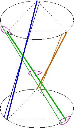

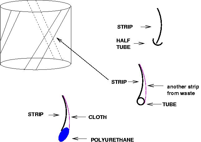

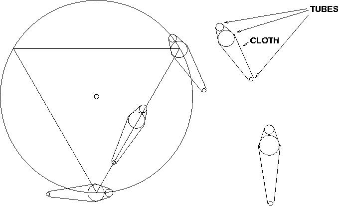

here are some ideas
how to make a 'gorlov type' turbine.
The first pictures illustrate
the idea that the blades
are made using metal or plastic tubes.
Airfoil shapes are formed
by covering the tubes with cloth.
If tubes cannot be bent, the airfoil sections will
be longer on the ends of the turbine wheel.
But if the tubes can be bent easily it might
be better to bend them to follow the same
outer circle all the way from one end to one end.

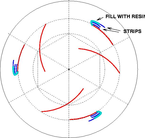

The second construction starts with a drum.
The drum is cut open so that only three
rather narrow 'strips' are left from the surface.
These strips will work as the blades of
turbine.
There are in the picture two ideas,
how to make airfoil shapes of the strips.
With the first construction the other ends
of the strips are bent piecemeal. The result
is a J-shaped airfoil, quite similar
as with 'Lenz' turbine.
(www.windstuffnow.com)
With the second construction
in this picture
a metal or plastic tube is fitted
on the leading edge
of the blade strip.
Then the outer side of the blade
is covered with cloth.
I think that the air pressures
will form the airfoils perfectly...
« Last Edit: July 04, 2005, 06:16:38 PM by hvirtane »

my next step will be to apply
the tubing to the out side
edge as you have depicted.
what are your thoughts
on solidity as a percentage?
I think that you could start with
a similar solidity as used with
Darrieus machines. There is available
one really good web page:
http://windturbine-analysis.com/index.htm
In his prototype the guy is using a rather
high solidity Nc/D = 0,42
the airfoil profiles you
have drawn look "right".
This is where the real science
is required, to produce
the optimum ratio between
vain thickness and vain width.
You are considering using cloth
as a surface, to allow
the airfoil to form itself?

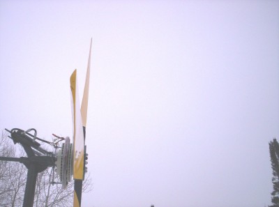

Yes, if you'll use a tube on
the leading edge, I think
that cloth could be a good choice.
I think that the airfoil
would form itself quite well.
One of my friends In Finland
has made HAWT rotor blades
using a tube in the thickest
part of the airfoil, polyurethane
on the leading edge, a steel wire
on the trailing edge and covered the
blades with cloth. They are working
really well.
consider this, if the sections
of the surface removed to
form the rotors (waste)were
reapplyed along with the tubing
over the remaining sections
it would create a profile
similar to that which
you have drawn.
I think that would
be a good idea.
Do you think to use a tube
on the leading edge?
One more drawing with also some
new suggestions. You might try
using polyurethane on the leading
edge and cloth to cover the vanes?

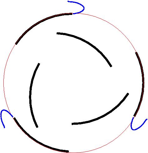

I made yesterday still more
drawings.
This draft above is quite similar
as I made earlier, suggesting developments
of 'WindstuffEd's 'Lenz' turbine. But if
you will make your machine with skewed
vanes like in 'Gorlov' turbine, you can
using waste materials from the bucket,
make 'the crossflow turbine' inside
skewed, too.
Then still another possibility would be to use
waste material from the bucket to fill
the vanes outside with strips. I'm not
sure, if it is necessary to fill the
leading edge rough shapes
with some kind plastic.
The vanes might work well without
filling, too.

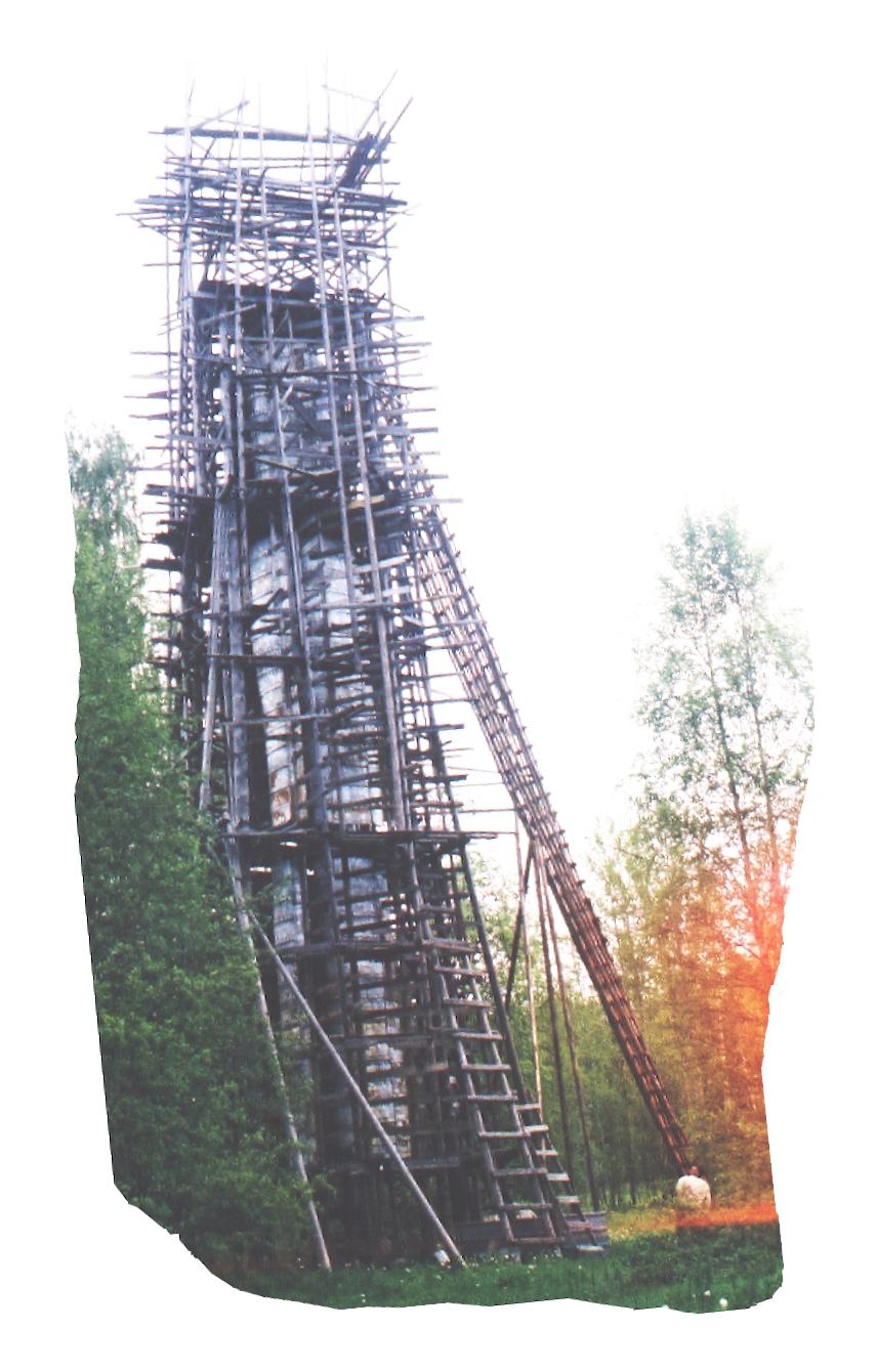

One of my good friends
here, Erkki Nousiainen
has built maybe
the biggest Savonius of
the world using old
paint buckets.
But he opened them and used
the metal plates by bending
them into new shapes.
Please see an old picture
of his Savonius below.
It is about 15 m tall...

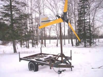

i like you friends big windmill. does it make electricity?  it might not be good for urban use !!!! ha!
« Last Edit: July 08, 2005, 08:15:09 PM by electrondady1 »
