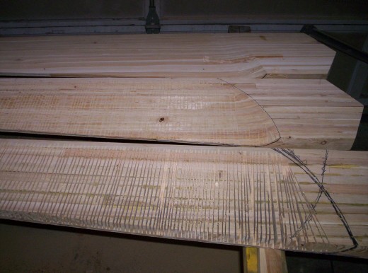

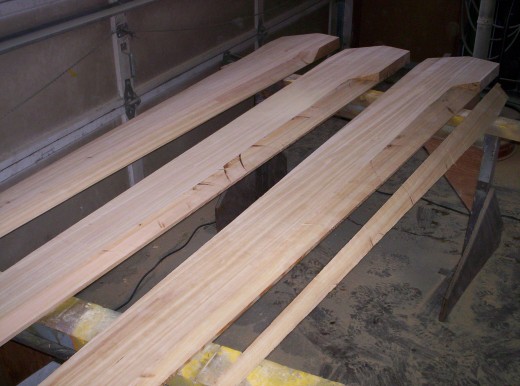

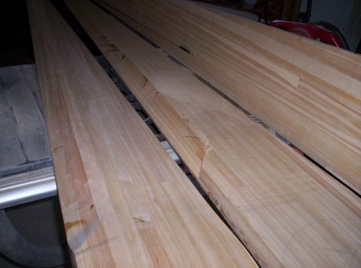

I plan on doing a complete post on this turbine, when I get done with all the testing. So far, it seems like its going to be a dandy. I just decided to throw this picture in now, thinking that DanB could view the extra support for the stator. The angle Iron is 3/4" X 3/4". I think it gives the flat stock alot of extra strenght.
And yes, it is another tilt back furl.
Great Fun, Harrie

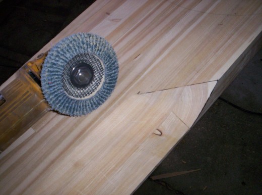

Damn i could cry that looks so sweet..
you do nice work ..
i have a lot of questions too but i'll wait , just one for now ..
what type of tool is this?
it looks like it really tears into  the wood..
http://www.otherpower.com/images/scimages/1412/100_0093.JPG

« Reply #3 on: March 12, 2006, 02:38:25 PM »
angle grinder with a flap disk. they come in several grits, but they are basically a fiberglass disk with pieces of sandpaper stuck on them, though i also have one with bits of scotchbrite pad for cleaning machined gasket surfaces.
allan
« Last Edit: March 12, 2006, 02:38:25 PM by kitno455 »
