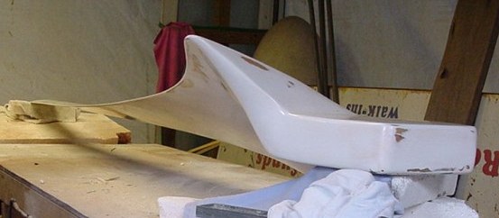

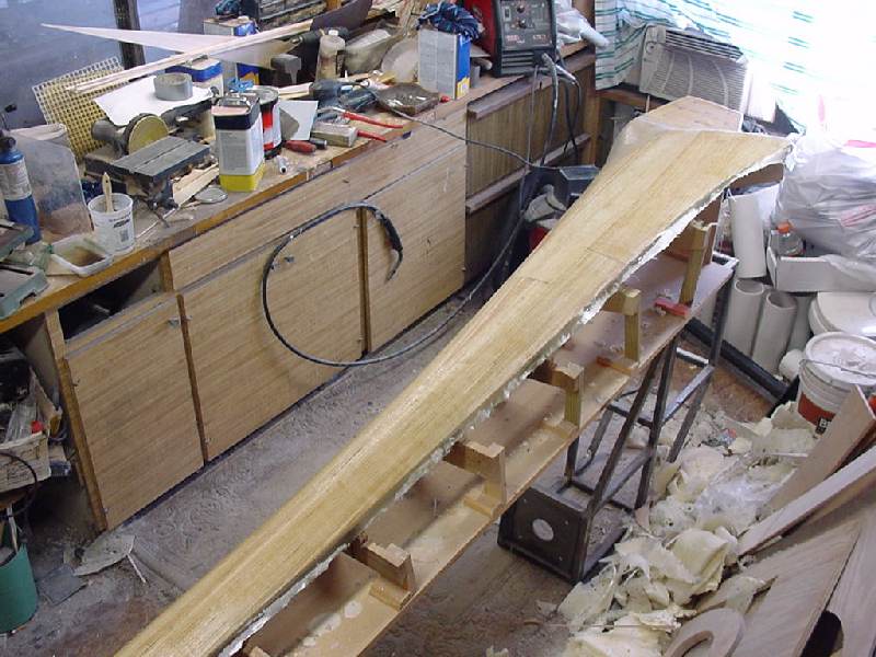

After sanding and filling, I got busy with the fiberglass and resin.
Starting to look like something now.
Lets skip ahead, past all the itchy fiberglass sanding, messy gelcoat applications
and dusty gelcoat sanding and go right to the waxing. Ooooohhh!
Twist & taper...

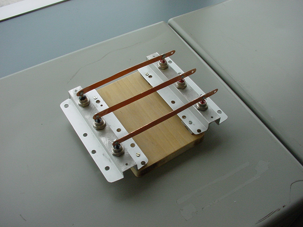

Homade 3-phase bridge rectifier from 6 50A/600V stud diodes and some shop scraps

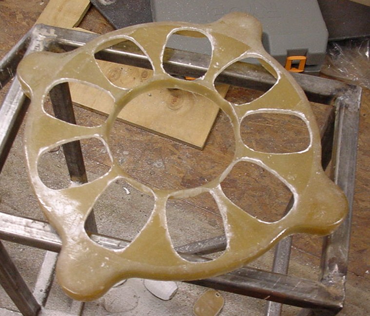

Coil cutouts in the stator plate

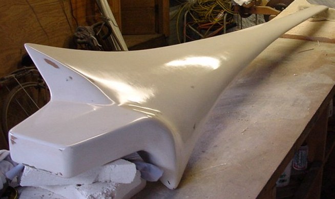

The plug is finished and waxed. I am now making the flange or "shadowbox" that goes around the entire periphery. When the gelcoat for the mold proper is sprayed, it and the fiberglass to follow will overlap onto the flange area and be trimmed along the outer edge of the flange. Doing this automatically provides a flange surface for the opposite half of the mold when it is layed up.

Awesome work there clflyguy
what is going to be the dia of the blades ?
nice work on the bridge rectifier

I commend your willingness to not become one of the sheep and fall into the "cast stator" mold (pun intended).
I predict that your risk of stator burn-out will be substantially less as long as you get some air moving past the coils.
I also hope you broke the mold (I gotta stop this) and used a "real" airfoil on that lovely blade.
In any case, congratulations again on the great work. Looking forward to further reports.

I'm shooting for 18' plus or minus a couple of the little marks on the tape measure

Hey Samoa,
 Yes, yourself and a few others caused me to give a lot of consideration to the
overheating issues. If I can think of a way to design a thing to last longer,
then thats how it will be made. I'm a belt AND suspenders kind of guy. As you can
see in one of my earlier posts, I didn't fully encapsulate the magnets, there is a
1/8" lip on the rotors for retainage and the resin only comes as high as the lip.
I'm counting on the exposed bodies of the mags to keep the air stirred up in that
area. -The airfoils; I saw in your photos that you also fly R/C, nice bipe hanging up there by the way.. Anyway, the root is a NACA 8413 @ 24.5" chord which continually
and painstakingly morphs to a NACA 4312 @ 4.5" chord at the tip. What airfoil is that on the blade in the rack in your garage? With so much undercamber I assume I'm
looking at the root end? I have a really fast airfoil for tips if you want it-
I didn't use it on this one though.

The blade a master piece
The rectifiers block, DOES need additional surface area for proper cooling and I presume that one set of three are with the diodes Cathode connected to the bolts and the other set with the Anodes connected to the bolts, otherwise you will a just a 3 phase half way rectification.
You did not indicated what the current is going to be, though you said that were from a 50 A, 600 V
If you are going to have around that amp level, the expected dissipation looks close to 40 to 50 watts dissipation which demands close to 60 square inches of surface for proper cooling.

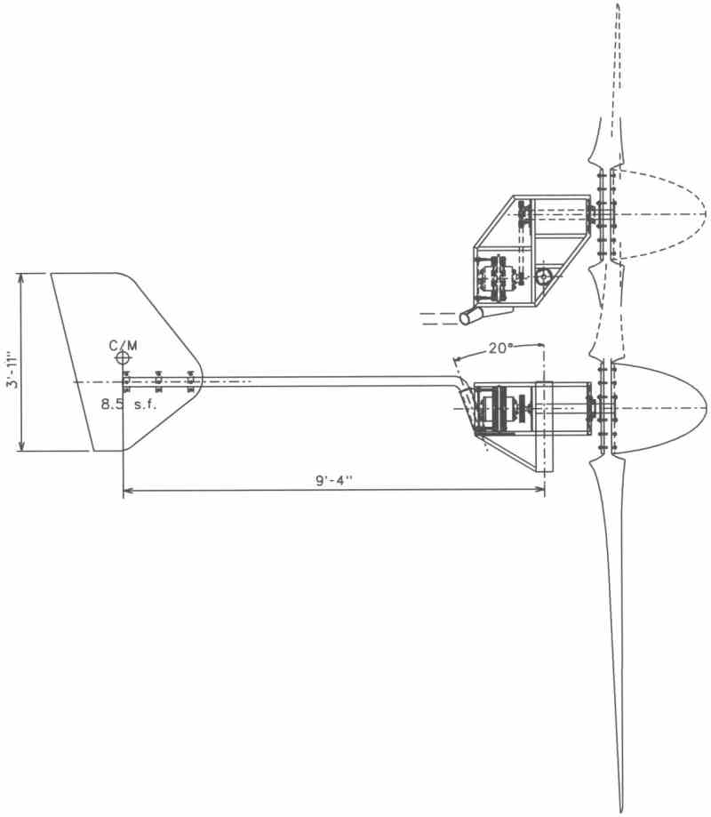

Amazing work, really impressive.
Is this a two or a three blade machine ?
(I couldn't tell from the drawing and I only see the one blade)

Hello Nando,
Thank you for the compliment. The diodes are anode mount on one side and cathode
mount on the other. The cooling area of each side of the rectifier is 55 sq. in.
for a total of 110 sq. in.. I hope you did not mean 60 sq. in. per diode, if so
then a re-design seems to be in order.
« Last Edit: April 04, 2007, 08:43:43 AM by clflyguy »

Hello Jacques,
Thank you. This is going to be a 3 blade turbine, and what you are seeing is
actually just the original part or "plug" that the blade molds will be made from.
When the top and bottom molds are completed, only then can I make the actual
blade parts.
« Last Edit: April 04, 2007, 08:53:19 AM by clflyguy »

What is the peak operating expected current ?.
You need around 3 square inches per dissipating watt .
For practical purposes each block can be assumed that dissipates current * (diode 0N voltage) = watts, so if the current is 50 amps and the Diode average voltage is 1 volt the dissipation would be 50 watts or around 150 square inches per side.
Make sure you are using Aluminum heat sink material with long Fins, if possible.

Yes, those were my thoughts too - I think you need a lot more surface area.

I would be a bit concerned with the losses in the steel blades on the rectifiers. Not the best conductor. Copper strip or even small diameter copper pipe would be much better.
« Last Edit: April 04, 2007, 09:57:16 AM by MaryAlana »

MaryAlana-
Perhaps the photographs lighting was inadequate to really make it out, but the
blades are copper. As to the insufficient heat sink area, I am ordering one of the
Dan's aluminum heat sinks this afternoon.

I love the blades!
I'm with Nando on this.  The half wave part.  And Not enough surface area.
It also looks like the AL thickness is kind of "thin".
For heat dissipation, surface area will be related to thickness.
ie: 100 square inches of AL foil is not the same as 25 square inches of 1/2" thick AL plate.
Just a thought.

The blades are copper and usually coated with silver or tinned with solder. Most Integrated Circuits are coated with silver. That's one of the reasons after a period of time the IC pins turn black from silver oxide.

Thanks for sharing your progress.  Your blade "plug" is truly impressive workmanship.  Please contribute updates when you can.  Great stuff.
I have one question.  Back at the top there are a couple of drwings that appear to show a belted, or chain-driven alternator, but down further down it appears you're looking at an axial flux alternator.  I'm confused.

Hey Kitestrings,
Right on both counts, it is an axial flux alt and it is gearbelt driven at a
step up ratio of 2.33:1. I went with larger blades to sweep more area and
"regular" size alt geared up due to being in a low wind part of the country.
I use the gear pulleys and belt to get away from maintenance issues with chain
and friction issues with vee belts. I'm doing a lot of things different from
most of the folks on the board. Most people are using resistance elements of
one form or another as dump loads, in my system anything from 1.2v to 23v is
channeled to electrolysers to make hydrogen for the stove, when the battery
bank is full (hard to imagine) the dump load goes back to the electrolysers.
Most folks are casting their stators, my coils are exposed to the air. In no
way am I saying they are wrong, I just think about things a little differently.

jacquesm
  • Posts: 467
Re: Progress Report
« Reply #25 on: April 09, 2007, 07:12:35 PM »
ah ok, I get it now, that's your master.
very very impressive.
if you can find the time please document as much of the process as possible, you are doing an exemplary job and it's very easy to miss a step that to you seems obvious but that for someone trying to replicate is very hard.
Unfortunately I'm not in a position to do anything with RE right now but that blade...
Maybe you could get it on the centre-fold of playboy :)
j.
