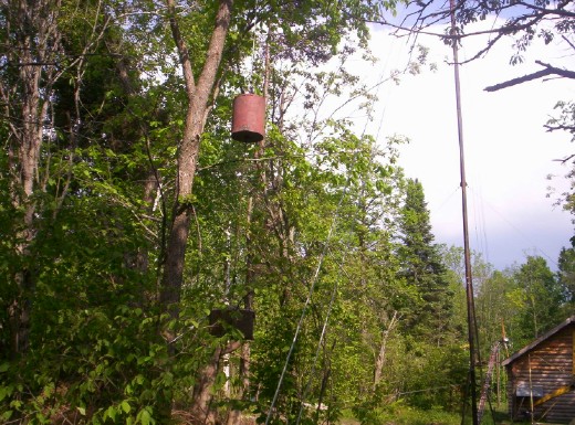

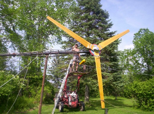

The winch had no problem bringing it down, I think it will be ok, because of the worm gear reducer. I agree with dan, that the winch alone, is not really what you want for this application.You can also see how I beefed up the unguyed area, and added more guys, I now have 12 guys at the top of the tower, I think this will do the trick.  I also think the counterweight system in the next picture I installed takes alot of strain off the winch.

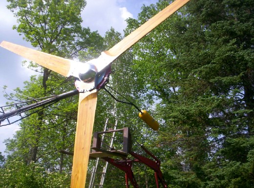

I took the vertical tail I had off, and replaced it with a cylinder tail, made out of a fiberglass resin tank out of a water softerner. I was able to balance it to the turbine by placing sand in the tank. With the tapered roller bearings I have in the yaw system, I beleive the tail will still have enough surface to turn the turbine. this is pictured below.
The next picture shows the yaw motor, that engages by a cable that runs down the tower, and is powered with a 14/2 115 volt wire that also runs down the tower. It is a 2 RPM motor that is geared very low.

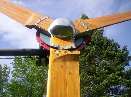

I had to put about three pounds of lead on the one blade to get it into balance as shown in the next picture
I thought I would show a different kind of cable clamp, that we used for rigging on construction projects, OSHA requires this type when they are supporting people in their work area.
Ok, I need some help from you guys that are up on electric problems. When I had the mill up, at 15 amps, it started to make a terriable loud noise, like it would if you thru the short switch at high RPM. than, it would quiet down at 20 amps and made no noise at all up to as high as I let it go which was 40 amps. I also while putting the mill together, before the blades were on, wired it to my battery bank and spun the rotors as fast as I could by hand, and noticed a noise comming from it like sticking a wire into the spokes on a spinning bycicle wheel. I than checked my battery bank, and discovered I had not closed the knife switch on the battery bank ground. I closed it, and the noise went away. Is this a normal condition, The only other thing i can think of is my rotors are not running as true as I would have liked them to be.the run out may be as much as 1/16 inch. would this effect the frequancy and cause viberation??? Thanks in advance.

 It looks like you drilled holes at the root of the blade to put in lead for weight? I hope they aren't to deep or that blade will break. A definite weak spot there. You need the root to be strong. If it breaks it is going to break there. I had a problem with mine. A couple of months after I put it up I had to rebalance it. I had to take weight off the side I had put it on the first time and put it on the other side. Well, I am sure you know what your doing Harrie. I just thought I would add my two cents. I need to do that bracing method to my tower too. That's some wind farm you got going. I wish I had a better spot for a larger turbine.

No, I totaly disagree on the saying I have weakend the blade, that is the thick part of the blade, and if anything to epoxy a diffent substance into it, will make it stronger! IM not worried!

Yes, I have saw this done also, and yes I thought about pouring the lead in, but the hole was so close tollarance that I coated the entire hole with the epoxy, and than had to pound the lead in. I poured them in peices of copper tubing first.
