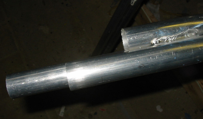

elt
  • Posts: 328
Re: Freestanding aluminum tower?
« Reply #14 on: July 19, 2007, 07:22:44 AM »
I'm really encouraged by my tests so far -
I brazed three of the tubes together with 9 one inch spots, three on each end and three in the middle. I suspended the beam across saw horses 4 feet apart and hung almost 300 pounds in the middle of for 10 seconds (about as long as I could hold on.) When I took the beam into the shop, it was still straight ... it's definitely not flimsy!
My original idea was to hang one piece out a few inches so two beams could be welded together without additional parts ...
... but I think that I may get a stronger union if I stagger all three.
This was my first shot at aluminum brazing and I think it was pretty easy considering that I had to do the heating with only MAPP gas in a propane torch... it just took a long time to heat each joint.
I do want to weld the poles but my flux core/MIG welder isn't set up for gas yet. My local welding supply wants about $200 USD to get me a regulator, a 40CF tank and my first fill of argon. OUCH! It looks like regulators go for about $25 shipped on ebay and I'm just going to have to keep my eye out for an good deal on a small used tank before I can move this project forward... (I can trade lots of alu tubing if anyone is interested in a trade!)
 - Ed.
« Last Edit: July 19, 2007, 07:22:44 AM by elt »

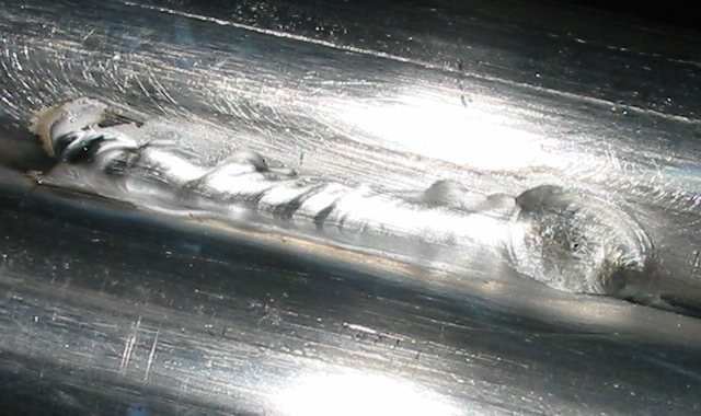

« Reply #17 on: August 14, 2007, 04:12:45 PM »
Kevin L wrote:
You should try super glue, I hear it works well in these applications as well.
Well, I tried it and want to warn any readers of this thread to not follow Kevin's advice. I superglued three pieces together, supported it on each end and went to stand on the beam. It broke apart and I fell on my! But the braised beam was not only strong enough to stand on, I also jumped up and down on it with my considerable overweightage and it held together just fine.
Still, braising was pretty slow so I got set up my flux welder for MIG and got a bottle of argon and went at it... Now this is just my second welding project; the first was the tail for wind mill. It took a lot of fiddling to get all the settings right but I think the welding is going pretty good now. Here's a pic -
There are three roughly two inch long welds on each of the three sides for a total of nine welds per leg section.
I changed the the overlap pattern slightly that I'll be using to join the sections. Previously, I only had one tube staggered, now they all are. The notion is that I'll insert a short piece of (steel) tubing into each end to enable bolting the legs sections together without any bolts interfering with other bolts. Here's a picture of the end of a leg section -
As far as designing a windmill tower, I've googled and studied lots of pictures of windmill towers. I've gotten a notion of generic proportions and bracing from them. One question the pictures left me with, though, was whether to make a three or four sided tower. And what's the difference anyway? Well, I think I found the answer!
This page: SIZING CONCRETE PIERS FOR TOWER LEGS is a real goldmine. (Basically, you'd need twice the shear strength in the legs and twice the diameter in the footings for a three sided tower that you would need in a four sided tower. Even so, I'm leaning towards a three sided tower. I don't pretend to follow the "soil science" but I can do the math and it tells me that I can do the footings for a three sided tower (and have a nice safety factor) with a the 12" auger that I can rent from the hardware store down the street.
 - Ed.
« Reply #18 on: August 14, 2007, 04:32:08 PM »
"I've gotten a notion of generic proportions and bracing from them."
Have you gotten this notion for steel towers or for aluminium towers ?
I don't have to tell you that steel has very different material properties from aluminium. Compared to plain steel, aluminium has very low tensile strength (depends on the exact material and the heat treatment), much lower elasticity modulus (E) and of course much lower density. Unlike steel which suffers only from fatigue when the stress cycles have a certain minimum value, aluminium WILL fatigue even when the cyclic stress is small. The fatigue limit/strength of aluminium is zero; given enough cycles, aluminium will fatigue even at 1 N/mm^2 stress.
When welding aluminium, you will change its properties even more. If the aluminium was originally, for example, -T6 quality, by welding it you will in effect undo heat treatment.
I'm no expert on towers or on aluminium. But I would do some -very- thorough research before welding my own aluminium tower.
Plus, I wouldn't even dream of welding a tower without being -very- proficient at welding. From your experiments I deduce that you are new to welding aluminium.
Then again, perhaps Zubbly is right and I worry too much...
« Last Edit: August 14, 2007, 04:32:08 PM by dinges »
« Reply #19 on: August 14, 2007, 04:37:25 PM »
I forgot:
If you don't know what grade aluminium you have, you will NOT be able to select the proper weld filler material !
I assume the shop where you have bought your aluminium wire had a choice of -at the very least- two materials/wires (AlMG and AlSi, perhaps with varying amounts of Mg or Si).
They are NOT interchangeable; well, at least, not for TIG, which is the only aluminium welding process I'm a little familiar with.
« Last Edit: August 14, 2007, 04:37:25 PM by dinges »
« Reply #21 on: August 14, 2007, 06:25:34 PM »
Sorry for the 3rd post in a row, but I realized only later an important detail:
You have switched over your machine from steel wire to aluminium wire. In that case it's important to exchange all feed components of the machine as well (rollers, liner, nozzle). Steel welding wire is coated with lubricant. This lubricant has found its way onto the feeding components and will contaminate your aluminium welds. Therefore you must install new feeding components that you will only use for aluminium.
Just something that I thought of later.
The more I think about it the worse I feel about your project. I know this is not what you wanted hear... I think you lack in 3 important areas: material knowledge (material characteristics of aluminium), tower design knowledge and welding capability.
There's a lot more to welding aluminium than meets the eye.
BTW, you might want to work on your technique; there's an end crater in that weld. With aluminium (TIG), I find that stepping back (1/2 cm) before finishing the welds reduces most of the crater. You might also want to try to keep the bead as constant as possible, if only to prevent stress concentrations.
« Last Edit: August 14, 2007, 06:25:34 PM by dinges »
elt
  • Posts: 328
« Reply #22 on: August 14, 2007, 08:10:04 PM »
I confess that I did search ebay for hose clamps before I went to welding! Forty or so would have done it and they were going for about 1/3 price.
The main thing that the welds do is keep the legs from twisting until the cross bracing is put on... I think that the welds will work a little better at that then hose clamps though I honestly believe that hose clamps would be viable in this application... I just think that it would scare the neighbors to see them on the tower! (BTW, I do use hose clamps to hold the tubes together while I weld them. )
 - Ed.
« Last Edit: August 14, 2007, 08:10:04 PM by elt »
Super glue and aluminum poles, I cant think of a better application for a wind tower installation.
If you did really jump on this you should think about application of some basic safety practices in your shop.  Some weights a 1/2" of the ground tied to some rope would have worked just as well.  I wish you the best of luck with your tower, but advise you to keep it clear of areas where people or property exist, or someone may end up with something worse then a scratched bum.  Oh and to apply a accurate test to your weld, you should weld the two 54" ends together and then support the 108" length ends with the weld being in the center.  Apply the weight to the center joint and test for weld yield strength with weights.  When your done, if the weld doesn't break, let us know how straight the length is after the test, as it will not flex back to its original as steel would have.  I really do wish you the best of luck.
I can always add enough weight to permanently bend the aluminum poles. In fact, I can always add enough weight to permanently bend steel poles too. Unless you can tell me how much lateral force a freestanding tower leg should withstand, there's not much point in doing any test... what would the result mean?
Even through I'm using different materials, I'm engineering my tower to be the structural equivalent of this tower ...
http://www.universaltowers.com/pdf/HD_models/01-model%23-hd-35-40.pdf
Did you think I was just winging it? And "no" I wasn't stupid enough to take your suggestion literally. I recognized your sarcasm; I guess you didn't recognize mine.
 - Ed.
