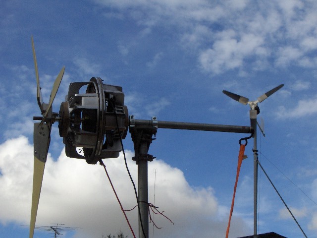

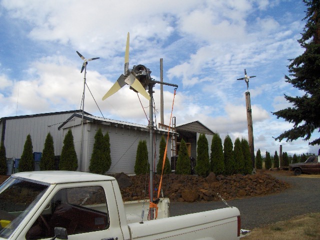

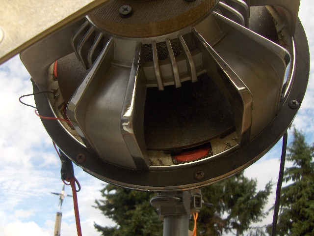

don't have time to comment right now, but here's what I rigged up.
http://www.fieldlines.com/story/2008/10/5/235214/518
Bonz
« Last Edit: August 10, 2009, 04:09:08 AM by FishbonzWV »

I've done several run-up tests using a lathe at work.  You can see details at the backshed's forum Here
(there is a similar thread on fieldlines with a different discussion Here).
You can see my spreadsheet plots are curvy lines, but acually there was scatter in every single number I measured.  Torque load was +/- 1 or 2 pounds due to vibration (or more), current varied by an amp or two at high speed, and the voltage was constantly creeping upward, even with rotor speed running constant, due to high charging current and gassing electrolyte.  By using a lathe I had fairly constant RPM, but even so, I was checked it with a bicycle speedo, and at high load the slow-down was several percent (AC slip in the lathe's motor).  Relying solely on the speed setting of the lathe would have compounded my errors.  Note that the lathe has a 5HP motor, and at times I was loading it beyond 5hp!
By the time I was finished the tests, the generator was too hot to hold comfortably.  This temperature rise would affect resistivity of the wire.  It took 1/2 hour to cool down enough that I could carry it out of the lathe chuck onto the table (didn't matter because you can see all the other paraphernalia that I had to take apart before getting to take Toshi out of the lathe).  I don't have a rational way to deal with the increase of temperature, so its effect is just there, whatever it is.
A lesson learned early on in experimenting with PMA's was that the low frequency causes many multimeters to LIE.  I bought a true-RMS meter and I've been crossing my fingers ever since.
One last comment: after you've collected a bunch of numbers, you should sort them, plot them on graphs, look at the results, and then consider every "outlier".  Think about what happened at each one, and eliminate the ones you think are bad.  You are allowed to fix erroneous numbers in your calculations as long as you can justify the method of the fix.  I did a fix on my Toshi numbers to account for wildly rising voltages, so that they wouldn't exaggerate the output power.  Do this before posting to the forum because glitchy numbers can lead people astray while they are trying to learn about what you did.  Then if you want to post about the fix itself, the subsequent quetion is asked in a clearer context.
