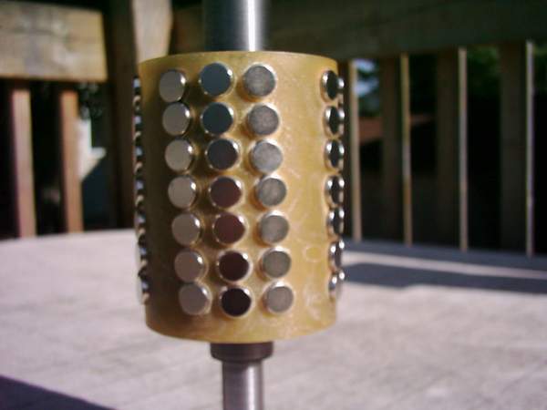

There's nothing really unconventional about it - it's a simple 12 pole, 9 coil generator wound with 44 turns of AWG 14 wire, two-in-hand.  At lower outputs, under 15 mph wind speed it groans so loud you can hear it from a considerable distance and it makes the tower "buzz" - you can feel the vibration in the tower.
As it picks up speed it quiets down some but the groan changes to more of a whistle or a high-pitched moan.  I used to have an 18 coil generator in this turbine with 12 poles and I uploaded a picture of that stator taken when I was winding it:
The 18 coil stator, although the phase timing was off with 12 poles, was one of the smoothest running generators I've ever seen.  But wound with only a single strand of AWG 14 the smoke escaped out of it one day in high wind.  That smoke was what made it work, because after that leaked out it was done.
Back to the noisy nine coil - this thing vibrates so bad I had problems with the stator bolts coming loose.  I finally used stainless steel locknuts and those have stayed tight.  The stator makes tremendous power - I had it hit 2.0 kW once when I discovered my furling calculations were bogus, and it didn't hurt the stator.  I took a picture of the turbine when it was spinning at almost 900 rpm that afternoon (which I think I posted here once) and I should've taken a movie of it so you could understand the noise - at that speed it was actually making a howling noise.
I don't know what I did wrong in that stator but I know I don't have any coils backwards in it and I know all the phases are wired right because the output between legs is dead even between any pair.
I got a 16 pole 12 coil in my 10.8 footer and that's a sweet running generator - it's as smooth as the old 18 coil stator used to be in this one.  I just wish I could come up with a way to make this 9 coil run smoother.

When I designed the 18 coil stator I had it worked out in my head how it would work with 12 poles.  You'll notice from the photo that it was not a conventional stator - it was hand wound on a machined stator plate and winding it was a very tedious job due to the small amount of room I had to work with in that homemade plate.
After I got it wound I did some thinking about it and the story of what I figured out is outlined in this set of photos, starting with this one and looking at each subsequent photo to the right of it.
http://picasaweb.google.com/christopher.w.olson/76FtWindTurbine#5430081286999881970
After I got it wound I realized I should've either overlapped the coils between phases to provide 120° separation, or wound one phase counterclockwise.  I didn't think it was going to work but I decided to try it wired star - and it did work only that the phase separation was 180°. I hooked a scope up to it to check it just to make sure.  It wouldn't run a three-phase motor but for battery charging the rectifiers didn't care.
The reason it ran so smooth is because of the coil to pole ratio - way more coils than poles which makes maximum use of the magnets and eliminates any hint of cogging under full load.  It was actually the smoothest running generator I've ever built.
Part of the problem with my 9 coil is that it is a large diameter generator - 12" - which left a small amount of room between the coils when laid out in the mold.  I suspect that could cause some of the vibration because the magnets aren't busy all the time.  I should've reduced the diameter a bit (probably) so the magnets would always be crossing a coil leg.  When I went to 16 poles and 12 coils in the generator on the 10.8 footer, that genny is the same diameter (12") but because of the greater number of coils the legs on adjacent coils are touching each other so the magnets are always busy.
That's the only explanation I ever really came up with.  My rectifiers are all good and the output is too even to conclude that it has a winding fault.
