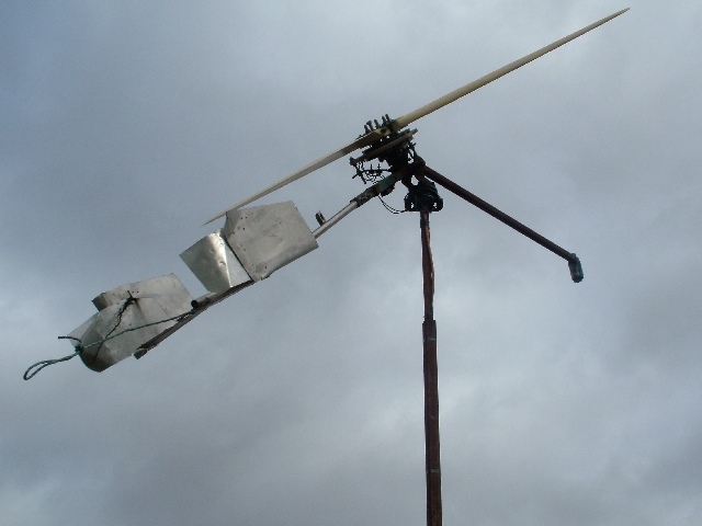

Here Is my down wind turbine -
Its been running without any maintenance or problems for more than 2 years.
Mick S
