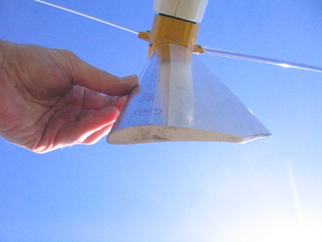

« Reply #7 on: April 13, 2007, 11:32:33 AM »
Samoa
 Did you ever test the blades you made awhile back?
 I thought they were cool.http://www.otherpower.com/images/scimages/5176/Blades1B.jpg

I am almost ready to fly a 10+ footer with two rotors and 6 blades. I will update my progress when I have some data to publish.
I have some photos listed in my profile including most recently the finished blades
