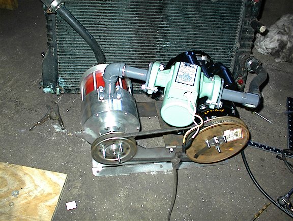

Here is the test frame I made to hold the 1 HP EMC Motor / Gen.
I know it would not last but I will paint it good and use it to see what power I can get.
[ Specified attachment is not available ]

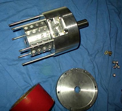

Here are 3 runners I made for testing. Not going to buy a real one until I set the camper up.
I missed placed the 6 inch runner photo.
Next is the nozzle and mount. Nothing more than a 3/4 cap and nipple.
The best part is I took three 60 watt light and hooked them up Jerry rigged.
The gen is just laying there and does not try to rotate until it gets above 70 volts.
Then I have to hold it lightly to keep it from turning when it is at 120 volt. All there lights are at full power.
I checked the RPM and it was at 416 rmp at 120 volts, 180 watts AC.
