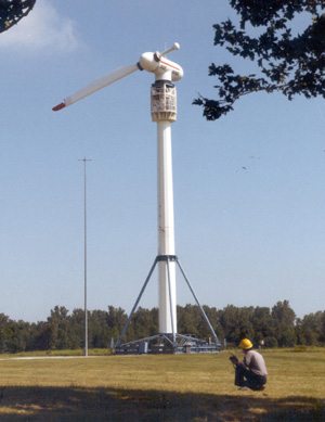

You want to build one of these?
 8)
Sure, bragging rights aplenty.
The aerodynamic loads are balanced when you have 2 or more blades.  With one, the loads aren't balanced, so the thrust and centrifugal forces aren't just loading the shaft axis, they are bending it too, and that's what drives the complexity up and up.
You can balance the CF load with a counterweight, like in the photo, but the thrust, pitch, drag...  oof.
My cousin built one of these in the 1970s.  He had me carve the blade.  It's very important to have a teetering hinge that allows the blade to 'cone' backward until the centrifugal and thrust forces balance.  This eliminated thrust as an out of balance force.  However you can't eliminate the tangential, 'cranking' force even though its a lot smaller.  In successful products this is dealt with using a soft suspension like a spin drier.
The reason my cousin did it was that it can have pitch control without the need for a thrust bearing that handles the centrifugal force.  The whole blade pitches, weight and all.   It chugged along like a lister engine.  The pitch control was a nightmare though.
Another reason given is that it runs fast (high tsr) and it's light and hence cheap, but in the end the noise levels work against that, and of course the wobble is a hard thing to live with long term.
Similar arguments are given for a 2-blader but it tends to have out-of-balance forces too (in wind-shear or during yaw movements).  I never built a VAWT (except just one) but I spent about ten years building 2-bladers when I needed the rpm.  Since I learned to make permanent magnet alternators I can stick with 3-bladers and that's nice.

Re: One single blade ?
« Reply #27 on: November 30, 2011, 08:03:20 PM »
Interesting thoughts above, its good to see the range of opinions.
Based on our results and analysis, RP has got it right with understanding the balance physics. There is some furling effect from coning when the machine is running partially stalled, but the main effect controlling power above design wind speed is still stalling.
We are certainly not putting the effort into the development and engineering of this product that we have just for novelty's sake, or to create a pretty gimmick, we are doing it in response to our discussions with both experienced small turbine users and aspiring windmill owners who tell us they want products that are quieter, more reliable, longer lived and more economical.
We won't claim to have 'cracked it' at this stage of our development, but we are seeing some very encouraging results, and getting good feedback from people who see it running.
I welcome any ideas and developments that can help make small turbines contribute positively to a better, more renewably powered world, and acknowledge that there are some very good products out there, particularly for me the Skystream. Now is the time to be developing and innovating to make sure that small turbines become appliances of the future (for suitable sites), rather than staying with a niche of enthusiasts.

Thinair

« Reply #28 on: November 30, 2011, 08:26:42 PM »
Apart from sharing the downwind, stall regulated approach our turbine is very different to the Skystream, but I think anyone who is thinking about designing a small wind turbine to be an appliance like product should look at that machine as a benchmark.

« Reply #29 on: November 30, 2011, 08:48:59 PM »
I'm thinking that you can only get so much power from a certain area.....so ooo
.....since a two blade is easier to make and design than one blade.....why not
just make a 2 bladed HT?
If the 2 blades will only go x speed in a y wind whereas a 1 blade will go
2x in a y wind....then hook a 2 blade to a alternator or generator with a geardrive
to turn the alternator at 2x .
  I see nothing at all to be gained by a 1 bladed contrivance other than
attention or novelty.
  I think a large majority feel the same way as I do....
   anyone wanna start a poll ?
Norm.
Thinair
  • Posts: 6
    • Powerhouse Wind
« Reply #30 on: November 30, 2011, 09:12:32 PM »
Norm, It might be time for me to stop posting on this conversation as it is starting to go round in circles.
Our machine does not turn at twice the speed of a two blade equivalent, we have optimized for a TSR of 7, and get a benefit in a much wider blade chord and consequently high flow Reynolds numbers and good airfoil performance.
The teeter bearing does not introduce instability, but allows the blade to move with gusts and de-stress the blade root. Incidentally, many two blade machines also use a teeter bearing to lower root stress.
If we were going to change from the single blade design, we would go to three not two, as two blade free yaw machines have some terrible dynamic problems as they yaw and couple motions between the two axes.
A poll won't change the physics, and there is no cost to keeping an open mind to new possibilities.
