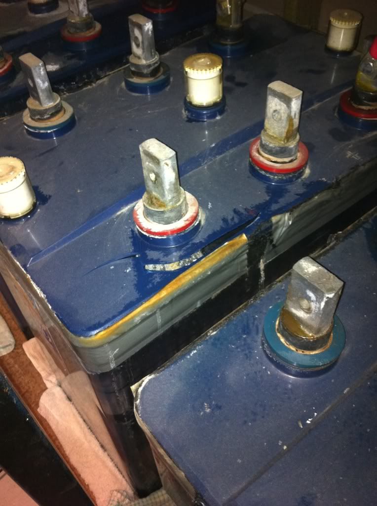

This is an example of an early battery using zinc and copper plates.  In this battery the metal plates would be suspended in a solution of Potassium hydroxide.  Cells of this type were used in the railroad industry for many years in the early 1900's.  This item was for sale on the E-bay website, although no longer listed, and the photo is used with the permission of that seller.  Incidentally the battery pictured was made by the famous inventor Thomas Edison's battery company.
Various variations of these voltaic piles were made, and different designs using liquid filled containers to hold the electrolyte were tried.  All of these batteries were not able to be recharged, only to have their metal plates replaced once they deteriorated.  In 1859, a fellow by the name of Gaston Plante invented a battery which could be recharged by reversing the electrical current across the battery.  He used lead and lead oxide in his battery, in an electrolyte of sulfuric acid, and to this day, batteries using the same chemical components, and known as lead acid batteries are made and used as starting batteries in automobiles, among other things.
