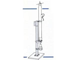

Rather than highjacking @MBouwers thread I think it is better to just publicly explain my situation.
I am looking for a way to connect a 1.32m diameter disk perfectly level (perpendicular) to its central column.
I have found things like this
But I can't push the column through without machining skills as these are meant to serve as a foot rather than somewhere arbitrary along the column.
To give some context I have a few images I'd like to share.

Now to the question at hand.
What is the best way to attach rather large rotor to the central column. Especially when the column becomes of serious diameter.

« Reply #6 on: October 08, 2023, 09:07:13 AM »
Most people on that style will brace the top by running a beam over it.  You may want a cross-brace.  While solid beams are generally very sturdy, your diameter is at the point you might want three poles and run guy wires from the poles to a top mounting that floats above your central column / device.

« Reply #13 on: October 08, 2023, 03:18:12 PM »
Maybe he can use a splined shaft connection, like borrowing the strut off of an automobile.  This would allow for play in the rotor while keeping the part hooked to the generator in the same spot.

interesting idea this splined shaft
