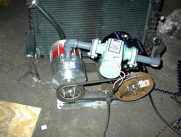

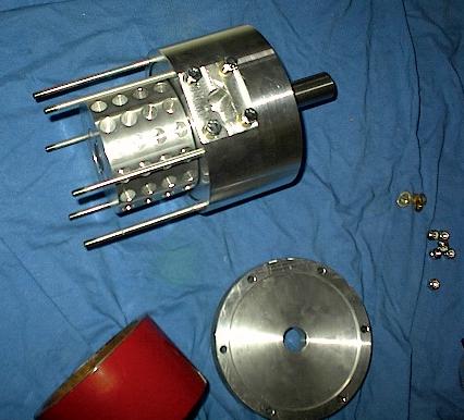

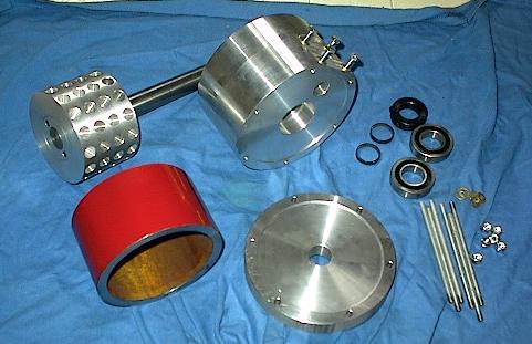

  I've been looking into alternatives to heating water as well as adding a bit of heat to my house.  I ran accross the ole Griggs patent (1993) and it's simplicity caught my eye.  Basically I want to drive it with wind but in the test platform I'm using a 2hp compressor motor.  Below is a picture of the parts machined and just before assembly...
  It's a small version of patent, sporting a 4 inch rotor with 60 1/2" holes drilled 3/4" deep to create the cavitation.  Although its called a hydrosonic pump it really doesn't "pump" and I added a small Taco circulator to move the water around.  Below is a picture of the pump partially assembled...
  After assembling the pump unit I was pretty head strong about getting it together for some testing so I cobbled together some adaptors to fit an old S10 radiator and plumbed it together with anything I could find that would work...
  My initial tests were pretty impressive for such a small unit.  The water temp was 69 degrees(F), I fired it up and had my hand on the pump and instantly could feel the change.  It was at 80 degrees in the first min and within 15 minutes was sitting on 172 degrees.  After which I turned it off because I was having problems with my breaker because of the long extention cord ( which was also getting hot ).  It averaged 7 degrees per min rise in temp and there is a gallon and a half in the system ( about 12 lbs of water ).  A little over 5000BTU per hour.  It was pulling 1800 watts according to the watt meter or about 81% efficient through the conversion.
  I found a newer patent a couple nights ago (1999) and found there are some things that could make it a bit more efficient.  All my holes are bored straight on center and some of the others are boring them at 15 degrees toward rotation.  I'll be making up another rotor for the unit with all the updated modifications this weekend.
  I've read some claims of 130 to 170% on thier units although I'm a bit skeptical on that account.  I'd be quite happy with a 90% conversion for my project.
  Lots of fun as always!  I spent about 30+ hours of pure enjoyment building it and I have a larger one in the plans...

 I figured you were up to something!  81% with a heat tape(extention cord) is quite good! (no clue on the correct spelling of extention) Have fun!  Gary D.

super workmanship ed , as usual!
is it your feeling that by converting the rotation directly into heat.
there could be an advantage ?
« Last Edit: October 03, 2007, 03:46:24 PM by electrondady1 »

Man thats nice machine work!
Why use the taco?  Seems like a few well placed angular cuts would do the same thing?

Ed nice work
 I have some concerns though.
Wouldnt the rotor suffer from the same effect has pump impeller thats run into cavitation.It doesnt take long to damage it.Well i guess you couldnt classify this has impeller but the same thing could happen dont you think?
 Also,If used on a wind machine wouldnt you have to gear it up?I know anything spinning in water will do a little.
 Just thoughts.
« Last Edit: October 03, 2007, 04:36:16 PM by vawtman »

Hi Vawtman,
  The cavitation bubbles are formed at the bottom of the holes, more of a controlled cavitation.  This keeps it from eating the metal..
  As far as using it with wind I'm tossing around a few different idea's.  If it's directly linked to a turbine then it will need to be geared up, similar to an alternator the speed is linked to the diameter.  It would probably be much easier to build a high voltage turbine and store some of the energy to offset the variations in wind and run the motor with the unit.  Even without any rotor mods this unit would heat my house much cheaper than any other method ( except wood - if you don't count the labor ).
« Last Edit: October 03, 2007, 05:03:53 PM by windstuffnow »

  Your right, I'm sure some grooves on the end of the rotor would move the water.  I really didn't give it much thought in the above design and my outlet is in the center of the end cap.  I could run the flow in the other direction although the bearings and seal would run hotter that way.  Probably not that big of difference on the heat though.. maybe a 20-40 degree difference.

Hey Ed whats the clearence between the rotor and the casing.
« Last Edit: October 03, 2007, 07:43:33 PM by tecker »

  In the patent they specify 0.1 inch all the way around the rotor but mine is actually .070, Their building 6 to 10" diameter for making steam.  I'm not sure what, if any, difference it would make by moving it out another .030.
« Last Edit: October 03, 2007, 08:07:31 PM by windstuffnow »

 Hi Ed, I'm wondering if your thinning of the water gap clearance is enough? If you aren't producing steam as the patent suggests, the aluminum rotor won't expand as much? I think you took it the right way, the grooves sound neat but if you could do more like rifling maybe it would pump also? Just a few dumb thoughts from a thinker ( disclaimer - this thinker isn't usually a doer...). Couldn't find a patent with no ones help if my life depended on it! I think as it is the unit works great!

Just a thought.
I wonder what would happen if the outer sleeve were not smooth in the inside, but had holes in it that met up with the ones on the rotor?  Would you get twice the effect?
« Last Edit: October 04, 2007, 09:28:50 AM by Capt Slog »
Re: Making hot water with cavitations...
« Reply #27 on: October 04, 2007, 09:33:00 AM »
  I'm sure it wouldn't take much to design the machine to circulate the water as well as heat it.  One of the pictures (Fig 1 ) shows a machine where the water enters the device through a port where the mechanical seal is and the outlet is over the top of one row of holes. I imagine the centrifugal force would push the water out with a pretty good force in a pulsed mannor.  I don't think it would take much in design to move the water around with the existing system.
  There are some video's on YouTube under "cavitation heater" from hydrosonic and a guy that built a very small one using a water pump motor.  Interesting viewing!
« Last Edit: October 04, 2007, 09:33:00 AM by windstuffnow »
« Reply #28 on: October 04, 2007, 09:38:11 AM »
  That would be the ultimate goal, keeping the system as simple as possible with the least amount of conversions.  Pex tubing is cheaper than copper! Insolating the losses, depending on the the run of pipe could get tricky.  The actual device could easily be mounted in an insulated underground enclosure and plumbed to a radiator in the house.  Could be interesting!
« Last Edit: October 04, 2007, 09:38:11 AM by windstuffnow »
