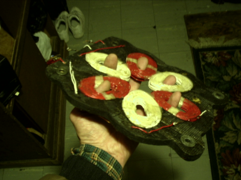

heres a simple little dual rotor alt...7 1/4" sawblade rotors..
ceramic and neo mags..
main mount is made from 2by4s--shelf hangers for stator mount..
couple of block bearings-- plywood stator with cutouts for coils real simple but strong..   wire  size maybe #222
alt is a 6and8 setup JERRY rigged...........

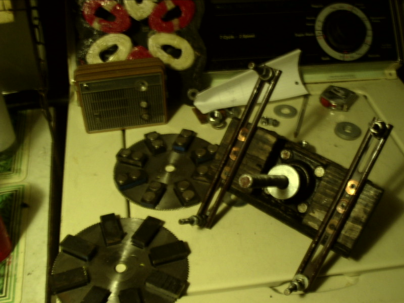

Hi esc.
I built my first dual rotor in 2005. I used the HF ceramics. I actuly got mine at Lowes, same magnet though.
I had the same idea. I didn't want to use expencive parts on my first dual rotor build and conciderd it to be a training exerzise.
I built the normal 12 magnet per disc and 9 coils with one big eception. I used 24 ga. wire.
The small wire worked very well because of 1 very important fact. I wound each coil with 350 turns. Then the biggy, I used a small 6 amp fullwave bridge rectifier on each coil.
Its called "Jerry Rigged" as mentioned by the guys above. 24 ga. sounds very small but when "Jerry Rigged" with 9 coils esentualy wired in perelell its equal to about 14.5 ga. wire.
24 ga. is 404 circular mills X 9 = 3636 circular mills. 14 ga. is 4107 circular mills, 15 ga. is 3257 circular mills.
I salvaged the fullwave bridge rectifiers from old garbage disposal motors from dumpster diving( free is a very good price). These must be the dc pm type motors. About 1/4 of all garbage disposals use these.
Hiker inspiered me to use old saw blades, never again. They were way to hard to machine.
Use some old brake discs they are typicaly free also. I made mine 10"
I used my 4ft "Jerry Blades". PVC blades will work very well.
A pipe blade that has been way over looked here is the PVC foam filled pipe. Its about 5/16" thick and very riged. I have pictures.
Speaking of pictures, I was just looking at my 2005 diary on this genny and most of the pictures in that story are gone but here is the story. This may take a long time to load. I made my picture files to large then and that may be why so many pictures are missing.
      http://www.fieldlines.com/story/2005/1/30/4118/94606
I'm curently building aa new dual disc alt with 14 ceramic HF magets per disc and 11 coils and yes "Jerry Rigged".
The power #s are in that diary.
« Last Edit: November 26, 2008, 08:15:14 PM by Jerry »

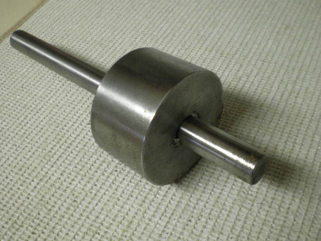

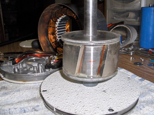

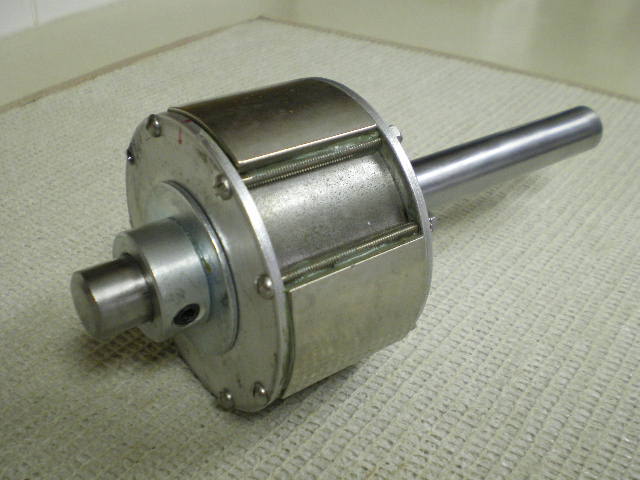

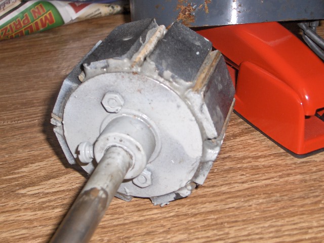

Here are a few more pictures for motor conversions I've done.
These are Lowes ceramics, No cogging but very low output.
Here is a new rotor I built for my 2 faced GM alt conversion. Cogs real bad
Here are some scewed #29s for my Garbogen that doesn't cog much with straight magnets. I saw a 10% decrease in power with these.
Here is the solid steel armature I use on the Garbogen.
Here is the rotor with magnets. The end cap magnet retainers are aluminum and the centering screws a SS so no flux path or lose here.
« Last Edit: November 26, 2008, 09:18:07 PM by Jerry »

Hi Eric.
The low powered ceramic geny was being tested on a large battery bank. That means the voltage rize was small (Heavy load).
If I was in my test truck I may not have been able to write down all the info and at that point if I had to skip something it was the voltage reading.
At 15 mph with a simular size pma with NEOs would make 3 or more times that power.
If your talking about double stacking the ceramics power would only go up margenaly.
The blades are paterned after the Zub-Woofer blades introduced here on the board several years back.
People make those from very thin (1/16" wall) plastic drain pipe. Folks complain about those bending back and hitting the tower.
So I made a very simular blade but with the very strong none flexing foam filled pipe.
This pipe is filled with foam for thermal and structual benefits.
I think it was hiker that came up with the old saw blade as a rotor idea.
We were just searching for something cheap as a rotor. 1 blade was to thin so stacking up several made them thicker.
Problem is they are hard steel and stacked up that way also made for pour flux path.
Brake disc are cheap and easy and have very good flux path charicteristics.
But OH YA they are heavy. OH well free is a very good price.
« Last Edit: November 28, 2008, 09:30:10 PM by Jerry »

Using a single disc with ceramics would be a bad choice. There flux is very weak to begin with.
A single disc would make the magnetic flux circut even weaker (no return path).
Mild steel is the best choice for flux travel. So yes mild steel discs would be great. But don't use just one with ceramics. As a mater of fact I'm building a stator with powdered iron i the coil centers to improve the flux path on my 14-11 ceramic PMACeramics need all the help they can get.
You say your looking for as cheap disc as posable. Free brake disc are prety cheap. And they are local. Heavy though. I think 1/8" disc will work but 1/4" would be better.
I would not use 4 blades on this geny. Its a weak alternator and does not need extra tourque, it needs rpm. 3 blades will make better rpm. Since this is a small blade diameter machine with high rpm potential there will be more gyroscopic (SP?) problems with 4 blades during yawing.
