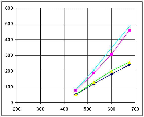

No idea if this will work, I have never posted anything here before, just replied to others.
I promised Jerry that I would look at the various connections and how they behave.
I have used the rotors of an 8 pole 6 coil machine and wound new coils. 3 wound for star and 3 for delta.
Star are wound with 100t of .9mm wire and star are wound with 170t of .71mm
Nominally the resistances are .6 ohm for star and 1.8 ohm for delta so they match the 3:1 requirement.
The 2 windings are in the same gap so there can be no differences there.
I have no bias in this discussion so I shall present results as I find them. I couldn't see how to be fair with a single speed test so I have done a range of speeds.
Both are with a 3 phase rectifier feeding a dc load at a constant 20v.
At the moment I have not looked at the Jerry connection, that will come later.
When I post lots of figures they seem to go all over the place so the results are in the form of a graph.
I have obtained similar results to Jerry in that the output in delta is higher even though the cut in speed is the same. The difference is not that great but it is real.
I will check the resistances more accurately but I doubt that there is much there.
At present I have no intention of commenting or forming any opinions, I shall just give the results as I find them for now.
I have no idea how typical this is and various forms of construction may behave quite differently. I have a feeling that jerry's new machine will show much more difference.
The curves are:-
Blue    input delta
purple   input star
Green    output delta
dk blue  output star

Can I reply to both here.
Efficiencies seem higher than I normally get, but there is not as much loss in delta with this one as when I did the tests with the 12 pole machine. Having only 3 coils may mask errors in spacing with more coils.The coils are mounted on plywood and are not that close to the magnets so there may be more induced loss in the magnets with normal spacings. I have often wondered how conductive neo is.
Also this thing vibrates much more than a complete winding and may affect torque readings.
Measured efficiencies for what they are worth are as follows
Star  96%  91%  84%  76%
Delta 92%  89%  82.7%  76%
The top figures are odd I think the star is low by the shape of the graph.
Voltage is held by a linear dump regulator, batteries are hopeless for testing without a dump regulator to hold volts constant. I now find the dump load works perfectly well without the batteries and I can set any voltage.
The thing is mounted on a dc drive motor with the stator arm restrained by a spring balance to measure the torque.
I have just done some tests with the thing loaded as an ac machine into 3 x 2 ohm star connected resistors. The line voltage at 200 rpm was 8.3 v for star and 8v for delta. This is almost certainly due to the fact that the wire size is a bit more favourable to star, so the fact that star and delta should be the same on ac is not in doubt. It is a rectifier issue and I suspect that jerry connection will show a bigger difference.

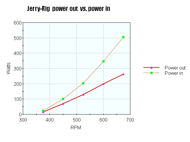

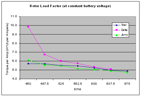

Just a couple of updates for now.
I have found an error in the radius that I measured torque at. I knew the efficiencies were too high. The corrected figures wouldn't show on the graph but I will try and re run the tests when I do the jerry rectifier.
Waveforms    Both star and delta line waveforms are near perfect sine waves.
Star phase voltage and one coil of the delta winding alone show a small in phase (peaky)3rd harmonic. This is small and no doubt why my open circuit volts are equal and why Jerry has a low star voltage. He has an out of phase 3rd that is probably much bigger. I am not sure whether he saw any improvement in line waveform over phase, there should be.
When I close the delta the circulating 3rd harmonic can be felt as a vibration with no load.
« Last Edit: February 27, 2006, 01:49:11 AM by Flux »
  • Posts: 2153
Re: Hi Flux welcome to posting.
« Reply #10 on: February 27, 2006, 06:12:05 AM »
Hi Jerry - I was pondering spending time on this today...  maybe still will although I think Flux has done a better job than I could here.
I dont see the need to build whole alternators  to test this.  If I do it I'll probably build one stator with 6 - or 9 coils in it.  Any 3 adjacent coils could be wired up as their own 3phase section - so 3 could be in Star, 3 could be Delta, 3 Jerry rigged if we wanted to.  Then Id be certain that airgaps and everything were the same and Id not have to be taking it apart/putting it back together so much.
It would be fun to get another such test though - but I think Flux did a very intersting one here and I doubt I could do better than that.  Maybe if I have the right sizes of wire here and all we'll mess with it today though - it would be fun!
« Last Edit: February 27, 2006, 06:12:05 AM by DanB »
Re: Star delta comparison
« Reply #11 on: February 27, 2006, 09:29:49 AM »
Mental blockage over we can continue, I knew there was something seriously wrong with those last figures, little machines like this don't manage those efficiencies.
I have had a 12 pole machine on the rig for months and for that frequency is speed.
I forgot that this is 8 pole so speeds are 50% higher. In the graph multiply figures by 1.5 for speed. Input power curves are drastically wrong.
I have done all three windings now and there is no drastic difference and things swop about at various points so a graph would not be very useful.
In general star is a bit lower out and more efficient.
Delta generally gives most out and is least efficient.
Jerry is a good compromise between the others.

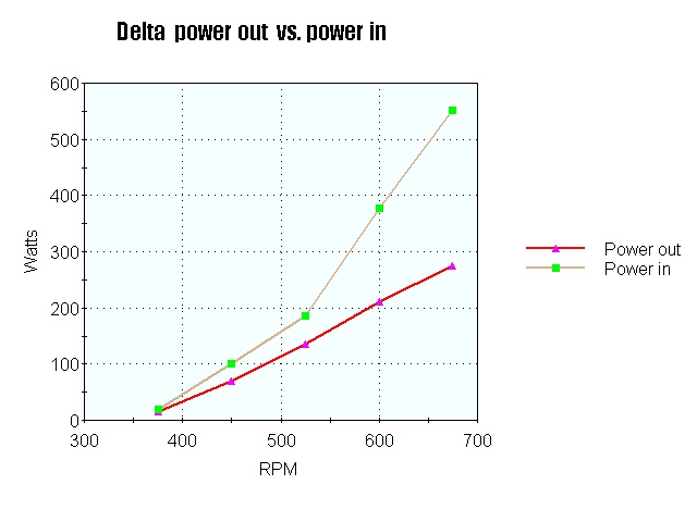

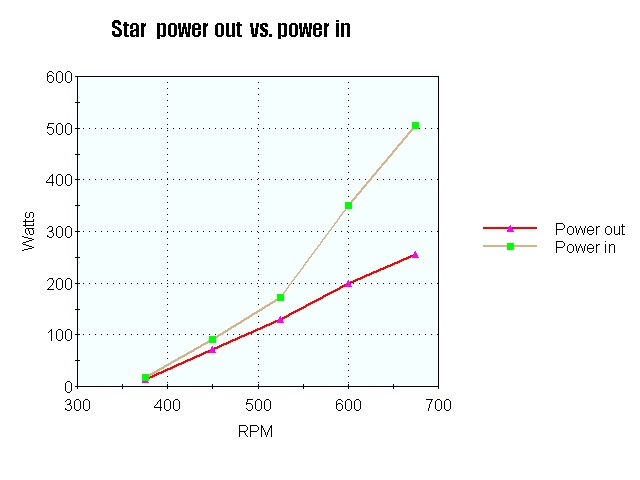

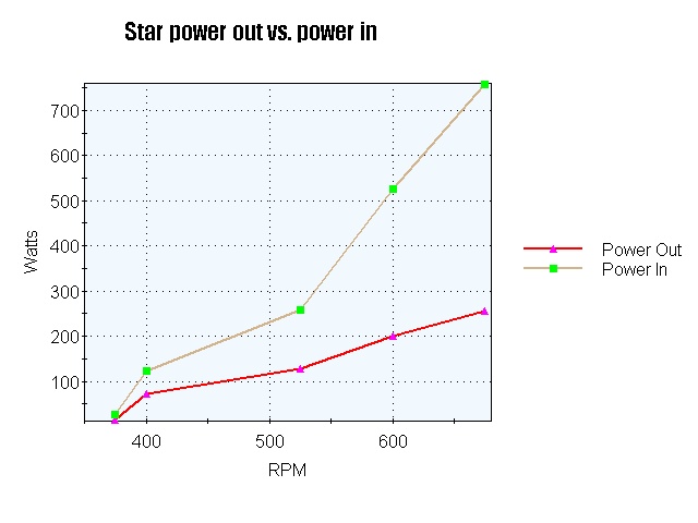

I will try the figures but if they don't make a readable form I shall have to try again. In preview there are so many funny red things about that it gives no idea what will happen.
Here goes.
Star first
RPM    watts out  watts in   efficiency
  1.    14         26.7       54%
  2.    71.8       122.4      58.5%
  3.    129.6      257.1      50.4%
  4.    199.7      526.5      38%
  5.    255.6      757        34%
Delta
  1.    14.9       28.7       52%
  2.    69.8       134.7      52%
  3.    135.7      278.6      48.8%
  4.    211.7      566        37.45
  5.    275.4      826        33.3%
  1.    15.9       34.4      46%
  2.    69.7       134.6     51.7%
  3.    129.5      305.3     42.4%
  4.    199.3      520       38.3
  5.    263        757       34.7%
« Last Edit: February 27, 2006, 09:29:49 AM by Flux »

Nearly worked. For some reason it lost the first figure of the speed readings.
speeds are 375, 400, 525, 600 and 675 rpm.
There you have it for this machine. I wouldn't want to guess what jerry will find with his odd thing, he has a knack of choosing rogue designs that show big differences.

« Reply #25 on: February 28, 2006, 12:47:38 AM »
Sorry I have made another error. When I compared my corrected graph with Willib's there was obviously something wrong.
For the power input calculations there are several factors converting frequency to speed, torque at an odd radius to lb ft etc, and I stick these in the memory of the calculator so that for each reading I multiply the memory figure by lb and freq.
I seem to have done something to corrupt the figure in memory or pressed M+ with something else in it.
The results is that the input figures of the last tests have the wrong torque figure and are high.
I left it over night to see if anyone spotted it. It doesn't affect the comparison in any way but we might as well keep things straight and come clean about mistakes.
Sorry Willib, any chance that you can alter your graphs and re post them with the same name.
I wish it was possible to go back to the original figures and alter them but I can't and they will have to stay to confuse people.
Corrected input figures frequency then power in.
Star    375 17.8    450  91.8   525  171.4    600   351   675  505
Delta   375  19.1   450  101   525  185.7    600   377.5  675  551
Jerry   375  22.9   450  101    525  203      600  346.9   675  505
Even if they jump about it should be possible to sort it this way.

Flux,
I took the liberty to assemble your corrected data into one place and graphed with the data tables. I included an efficiency comparison graph since this is what I'm most interested in. Hope you don't mind. Parallel = Jerry. Interesting stuff.
