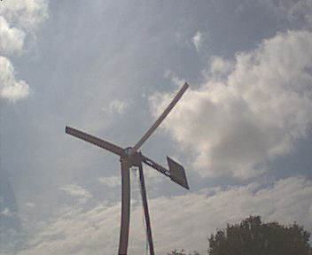

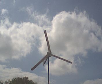

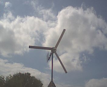

When I'm not spending my time disrupting the smooth flow of dissenting opinions here on OtherPower I actually do get in some wind power related testing and experimenting. Heres the latest unsuccessful skirmish using 4 inch cedar lap siding:
Thats 4 inch cedar lap siding mounted at 23 degrees to the hub with a bit of rounding on the leading edge. No taper and 3 feet per blade and about 6.5 feet total prop diameter.
While it spins in a very light breeze it is another blade setup that lacks top end for charging.
Once again this is actually my buddy Lanes thing. He had been looking at a Bergey 1KW mill [XL.1 I think] and he was curious about its apparent lack of twist. He tossed these on one of my old JerryBlade hubs to see if it worked at all. And, like I mentioned, they work at some level but have low and limited rpm.
Can anyone explain just how Bergey makes those blades work? I have never seen them myself yet but Lane says they have no twist and what looks to be a constant profile.

Glad to know you haven't been entirely sucked into the vortex of board politics.
In a driven rotor (as opposed to a propeller) lack of twist will with make the rotor hard to start with a good top end, or poor at the top end with good starting characteristics.  Or they can split the difference and get so so starting with so so top end, and definitely not as good as a set of twisted blades.
Unless of course it's some variable pitch hub or one of those magic blades that are thin in just the right places so that as wind speed goes up, they deform into a better attitude.
Good luck and especially, keep having fun.

Always love to see a experment. I think the big problem with this blade is the 23 degree angle more than anything. Jerrys blades are now something in the area of half that and they work really well. 23 degree is great for start up but have too much drag to go very fast.
