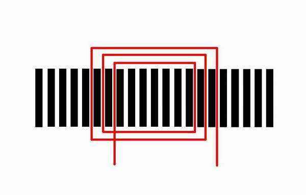

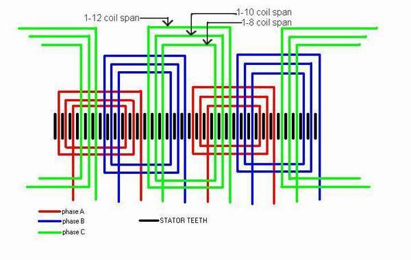

The most common winding being used today ( up to about 10 HP ) is a concentric winding, 4 pole, 36 stator slots, with a total of 6 groups of 3 coils per group, 18 coils in all. This winding having 2 coil groups per phase, produces 2 poles per coil group, and is connected in a consequent pole fashion.
Here is a lay out of the mentioned winding that corresponds to the connection diagram in the last photo.
another diagram showing the winding lay out with phase markings and showing the lamination set.
here is a diagram showing the lamination set layed out flat with one coil group installed
here is a picture of a completed winding i did on the 2 Hp showing the spans of the 12-10-8 winding. Note that only 3 leads have been brought out of this winding as it is designed to give cut in voltage of 14 volts using a 2 Delta connection at 200 rpm.
