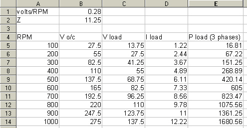

I re-did the testing today, with the drill press set to 280 rpm & 350 rpm. I measured the open circuit voltage, the frequency unloaded, the loaded voltage, the loaded current, and the frequency whilst loaded. I used the frequency measurements to find the true rpm of the drill press, and corrected the no load voltage based on this. I was then able to calculate the internal impedance of the winding. It calculated out to be 11.25 for one case, and 11.3 for the other. Note that this is for one winding, from the common neutral point of the star connection, to one free end.
I then used a spreadsheet to do a maximum power transfer calculation at various RPM's, based on an open circuit voltage of 0.275 volts/RPM, and an internal resistance of 11.25 ohms. This yields the maximum power extractable at that rpm, if one could adjust the load to match it perfectly (3 phase motor driven auto-transformers anyone?)
I think 2 of these alternators on one shaft, geared up 2:1 (automotive toothed belt camshaft drive), would yield 1 KW with a decent breeze. Low wind performance, however, would be abyssmal.

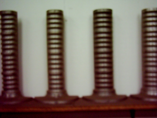

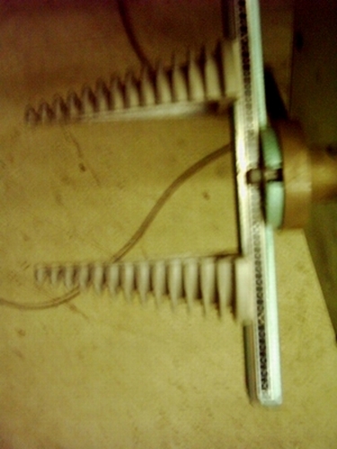

Interesting motor/generator you've got there, what kind of rotor are you using ?
It looks like it has tons of space for windings, much more than most ordinary laminated designs of the same size.
« Last Edit: September 04, 2004, 07:25:59 AM by jacquesm »
commanda
  • Posts: 731
Re: Smart Drive alternator preliminary testing #2
« Reply #8 on: September 04, 2004, 07:53:45 PM »
It's a smart drive motor from a Fisher & Paykel washing machine. Completely unmodified. They're made in New Zealand. Been sold in Australia for years. Only recently starting to appear in the states. They make about 1 watt per rpm. Mine makes 0.48 volts per rpm with star wiring. There's several different versions available, with different wire gauges and number of turns.
