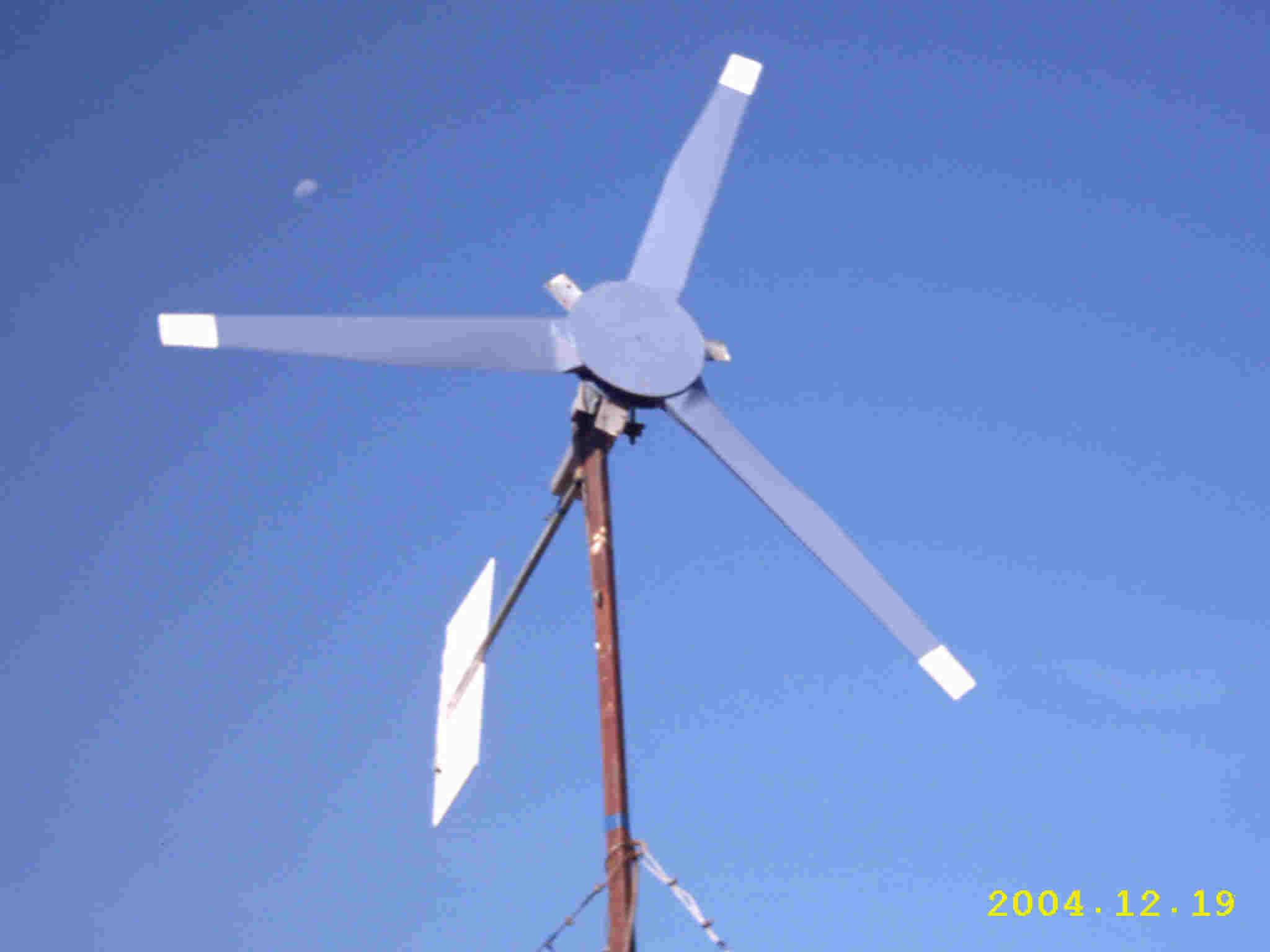

Decided to get serious about making a set of my own wooden blades for a TDM. So plugged in 500rpm 300w into the program and came up with 2.07m diamiter.
Swopping the chain saw for a hand saw but still making full use of the power planer and belt sander, this happened.
Put them up on the test tower 20' in a mild sea breze (its as calm as a lilly pond this morning of course) but did see 5 amps in that mild breze.
They are made from 150 x 38 mm local pine, weigh in at just over 1 kg/blade, the timber was not as wide or thick as the program called for but they start easy. In three days when the wind returns I should see some interesting results.
regards Allan

I have a dial-up a 200mhz pentium and use mozillia. Mozillia saves the day. The picture looks good and I second the gratitude about the load speed.
BTW - the blades look nice as well! I'm still not sure I'm sold on big fat hubs for a few diff. reasons and I don't expect it will bother your overall performance much - Just the startup somewhat.

By hub I mean blade root.

Yes I don't believe the lack of width at root is making much difference, they start well and come up to speed quickly. Did some more static ballancing today with pleasing results.
Can't wait until the strong o/n winds return as the days warm up.

BTW, bravo, nice looking blades. Should help with that power needs bottom line.

I can only add to the accolades about the good looking blade assembly. It looks aerodynamically sound, and mechanically sturdy, and you are already getting encouraging data.  I don't know what the others' problems are in the photo screen appearance, but with plain old Windows 98, the photo pops up fast on my dial-up connection, and fits the CRT screen aspect ratio nicely.                K3CZ
