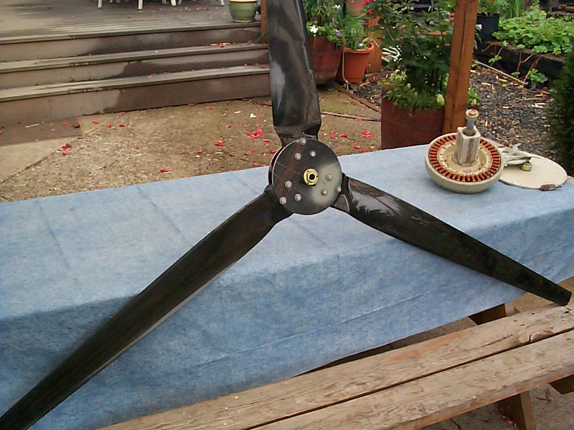

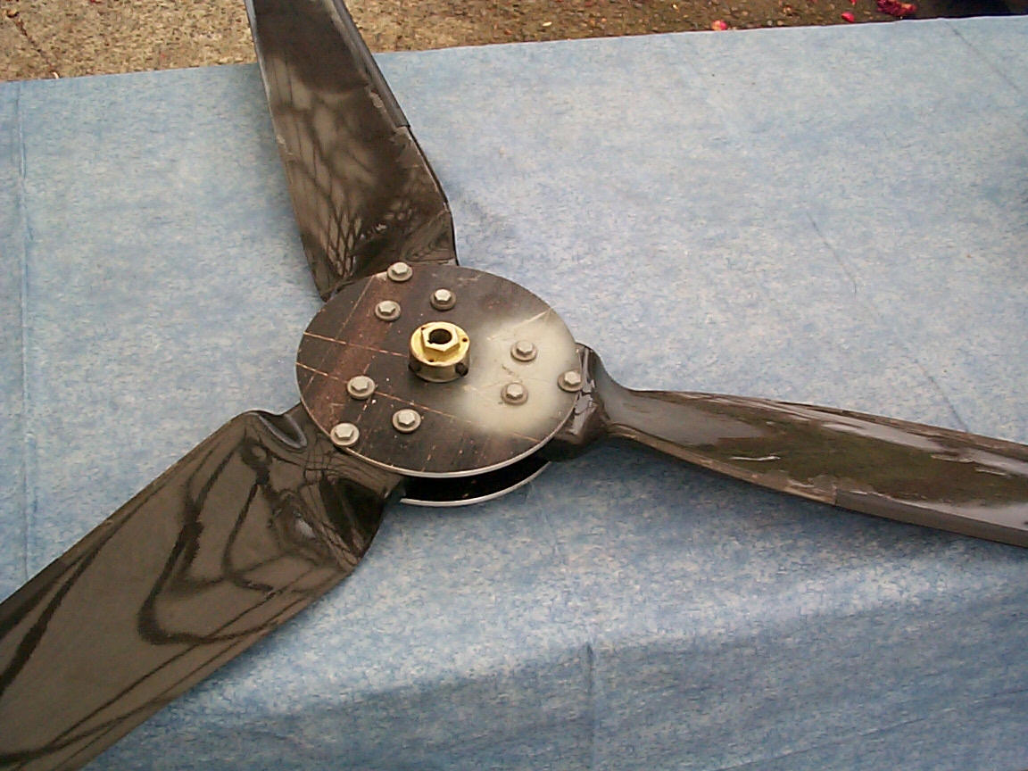

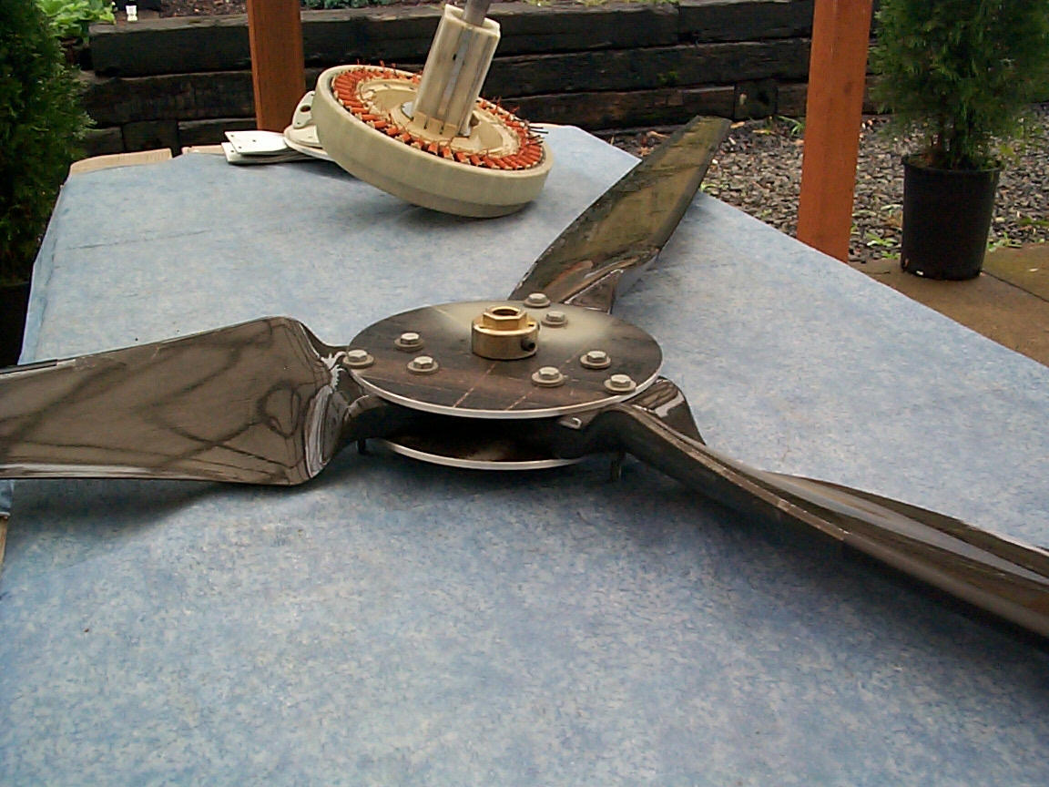

Lakota blade next to F&P.
Lakota blade only.
Lakota and F&P.

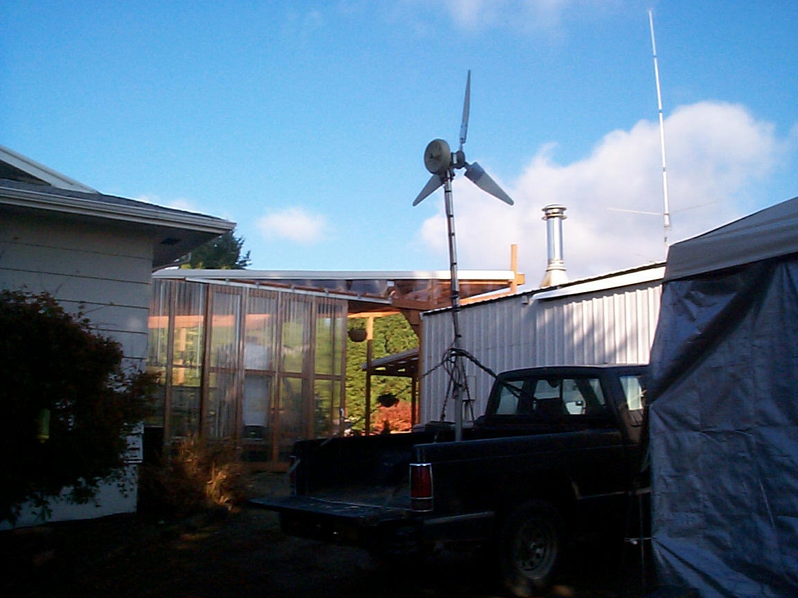

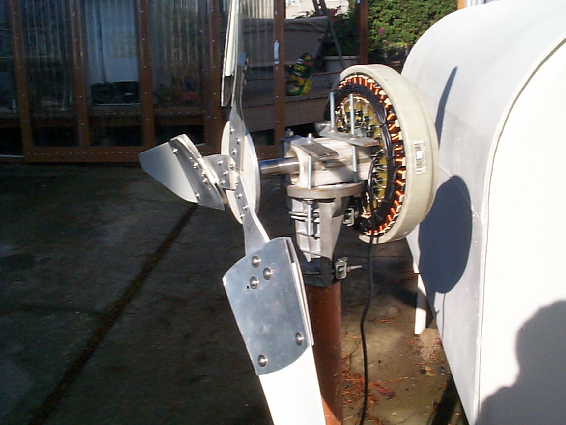

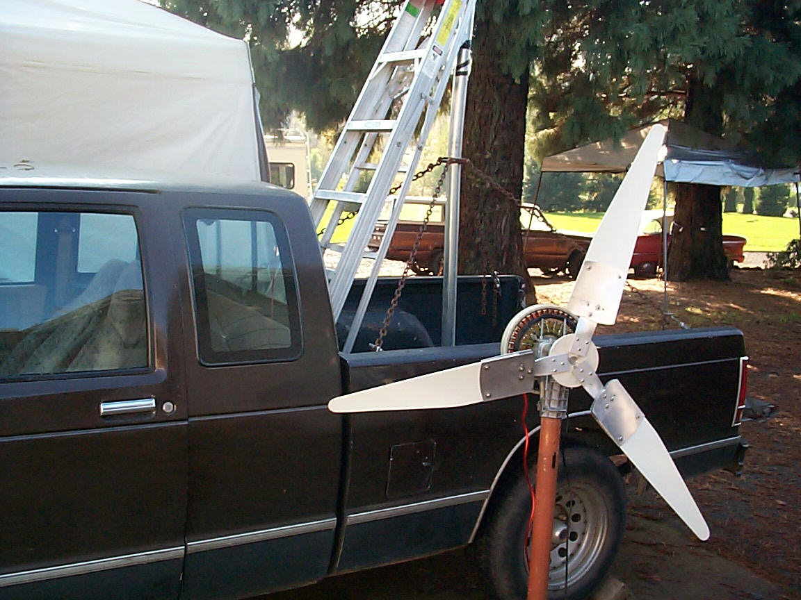

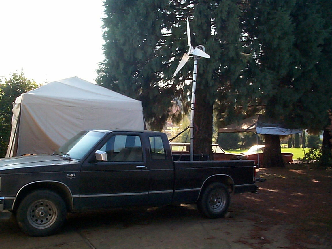

More pix if they work.
PC board all wired up.
Getting ready to fly.
returned after wind test.
« Last Edit: January 01, 2005, 01:56:29 PM by Jerry »
Re: F&P mods.
« Reply #5 on: January 01, 2005, 03:37:36 PM »
what kind of power did you see after your test drive??are those pvc blades?

Re: F&P mods.
« Reply #6 on: January 01, 2005, 06:52:36 PM »
Hi Hiker
The blade are my ABS plastic on extentions. This is a 55" blade.
 5 mph 0 watts
  1. mph 0 watts
  2. mph 127.5 watts
  3. mph 195 watts
  4. mph 360 watts
  5. mph 450 watts
  6. mph 837.5 watts
  7. mph 1022.4 watts
I havn't done the decogging thing yet. I think the Lakotas will do 1000 watts at 30 mph?
Papa frog  and I havn't been on the air for years. I do have SSB and run barefoot.
I might get back on in a few years. To busy with this puter and wind power and life.
                  JK TAS Jerry       (papa frog)
