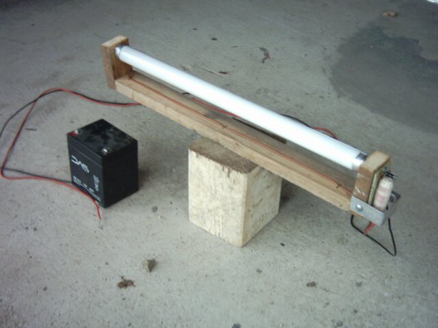

As the next step towards decreasing the cost of lighting installations in my remote-village-solar project, I decided to have a look at the light fittings.
Currently, we're using 8W 12V "trouble lights", which cost AUD$10 each and come fitted in a plastic tube.  These are quite robust, and only draw 350mA, but give a very "blueish" light.  A similar 16W version costs AUD$20.  They look like this:
Since the idea is to come up with a design that the villagers can build for themselves, I did some researching of various circuits and decided that this one was probably the best fit for my use:
http://www.talkingelectronics.com/Projects/
FluorescentInverter/FluorescentInverter.html
Its positive points are:
  • Cheap;
  • Simple;
  • Not necessary to disassemble and rewind E-I transformer cores;
  • Robust;
  • Reasonably efficient.
On the down side:
  • Makes AM radios whistle like teakettles;
  • Probably not as efficient as an E-I core transformer.

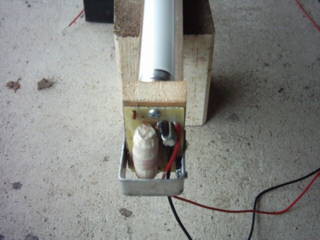

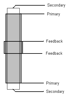

The changes that I made to it were:
  • Use a 50mm (2") section of ferrite for the transformer (it comes in 100mm lengths, this way I get 2 for the price of 1);
  • Wind the secondary (5 layers, 90 turns per layer) first;
  • Wind the primary (1 layer, 52 turns) next;
  • Wind the feedback (12 turns) last, in the opposite direction to the primary;
I've designed a PCB to allow for a simple and robust assembly, and a batten fitting made from 40 x 20mm pine.  I think that the RF interference will be minimised by housing the circuit board in an aluminium box, but I didn't have time to try that yesterday.  The box could then double as a heatsink for the transistor.
Here's the completed light:
A close up of the circuit board.  The strip of aluminium is a heatsink for the transistor, and the transformer is insulated with masking tape:

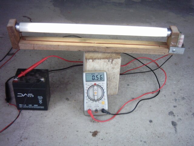

Powered up, and consuming 560mA:
The total cost (including tube) should come in at a very competitive AUD$7.
I'll post the PCB artwork and my changes to the circuit, if anyone is interested.

Essentially (from what I've seen) you get a brighter output by running a fluoro at 2kHz than you do at 50Hz (or 60Hz, in your case).  So you don't need to put as much power through it to get an equivalent light.  By slightly under-rating the tube you also get a longer life out of it.
The life expectancy is very low. Amazingly low in my experience (a month is good).
The decent 11w 12vdc CFLs I have used are MUCH brighter. So much I can't explain it. 7 to 10 times brighter is a guess.  I bet the decent 7w CFLs are about as good as the 11w, but the current draw is soooo close to the 11w, I just use 11w now.
The first couple of them that I bought were very poor quality, and were actually drawing about 600-700mA for an 8W tube.  They also had no heatsink on the transistor, and so burned it out within a couple of days.  A little later I found a source of a much better quality version (for only $2 more) that had heatsinking on the transistor and ran barely-warm as opposed to finger-burning-hot.  So I bought 30 of them.  They're a little less bright, but appear to be lasting well so far.
CFLs are driven quite hard, hence the bright light from a small package.  Some of them (especially the cheaper ones) get quite hot, especially in the base where the inverter circuitry lives.  Heat=wasted energy.  They're also a more focused point-source of light than you get from a long tube (I'm echoing a bit of what the guy on the original site had to say).  I agree that CFLs are very useful and have their place, but for this particular application I think that the longer tubes are the way to go.

There's an error on that diagram, in that C2 should be a 0.1uF polyester or ceramic capacitor.  An electro will work fine too, if you can get one the right size.
If you're using a smaller tube you can retain the same numbers of turns on the transformer, just increase the value of C2 to 0.5uF or so.  This can also be done to run a tube at a reduced power consumption and brightness.
Also, I recommend doing the windings as secondary (450 turns), then primary, then feedback.  Also, I insulate each layer with strips of masking tape running the length of the ferrite rod (ie. not spiralled).  That way it will all neatly fit on a 50mm length of ferrite, and the leads for the primary and secondary are easy to identify:
(It also makes it much easier to mount directly onto a PCB, since the four 0.63mm primary and feedback winding ends are plenty stiff enough to support its weight).

  in article it said to ues different size wire for primary and feedback is thie nessary? or can it all be same size wire?  also do you wind in differnt directions
for all or just the feedback thanks george
« Last Edit: January 31, 2005, 07:01:22 AM by deerslayer660 »
BT Humble
  • Posts: 475
Re: Cheap 12V fluorescent lights
« Reply #26 on: January 31, 2005, 02:32:41 PM »
I used 0.63mm for the primary and feedback coils, and 0.4mm for the secondary.
The primary and feedback need to be wound in opposite directions because they interact, the secondary just needs to have all its turns in the same direction (ie. don't accidentally reverse your winding direction when you start a new layer!)
