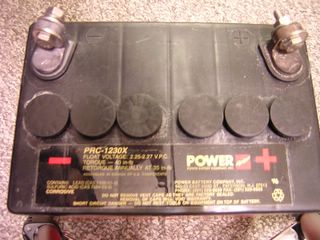

I got this small FLA battery (free), a Power PRC-1230X that was boiled dry. I just added some distilled water to it, and am currently got it on my charger at 10A.
Any wagers as to how this will turn out?
Is it worth what I paid for it?
Should I be doing anything different like higher or lower amps?
I don't currently have a desulphator, a future project I guess.

It appears I have been wasting my time ~6 hours charging and it is at 0.7V open voltage.
Oh well, the only loss was the distilled water, and the small hole I banged into the bathroom floor when I dropped the bloody thing.
I guess I'll hack the Pb lugs off of it and take it back to the recycling depot.

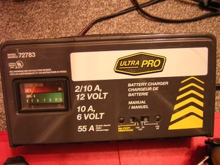

The charger set @ 10A was closely monitored for temperature & gassing, never even seen a bubble or felt any warmth.
My little multimeter doesn't have a ammeter so I don't know how much the battery was actually drawing.

   Your charger doesn't have a built in ammeter?
   Why don't you look into making a capacitor charger? Plenty of help on this board on how to make or buy one, might be a fun experience for you...nothing like the satisfaction of rejuvenating 'junk' back into something useful!

The charger pictured above is the one I was using.
I don't ever remember the needle not being all the way to the left.
My multimeters are both the autoranging mini clamshell radioshack ones VAC VDC CONT Ohms and what I think is a diode checker.
