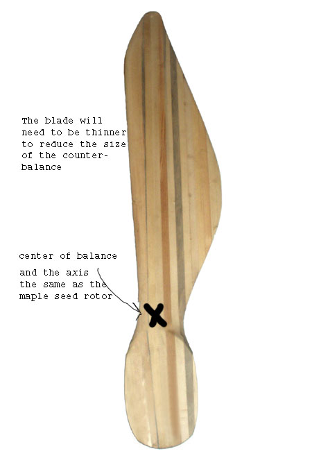

Well here's the first
This one didn't balance well for I think a few different reasons but I never expected to nail it on the first try.
In reply to a few questions from the other post. For ed, it did do about 80 - 100 rpm in 5-7 mph winds and about 300 in 15-ish so that puts it in the tsr 7.5 range. After that it crashed.
nothing to lose, the white counter balances are indeed just stubby blades for three reasons, one - to provide additional lift and hopefully offset some of the one sided torque of the main blade, two - the 120 offset is to give the dynamic balance of a three blade, three - to reduce drag and turbulence by having the counterweights profiled rather than round or square etc.
ted, I'm abandoning the 120 offset counterbalance for now because it has proven to be harder to do than I expected I'll revisit it after I learn how to balance this in a two blade format and I'll likely try to bring them in closer to the hub. see the next generation plan.
truman, I'm about 100% confident that at some point in the future I'll build a three blade rotor with blades like this thing has, It has alot of torque in low wind due to the blade area. It would offend anyone who is worried about high wind performance but not me and I think it would look really cool, lol.
For the next generation I'm going to mimic the maple seed even more and use the single counterweight just like it does till I learn more about this.
Here's a photoshop mutation of the above to give you an idea what it will look like and below is the original 2" norm turbine.

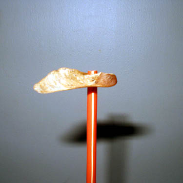

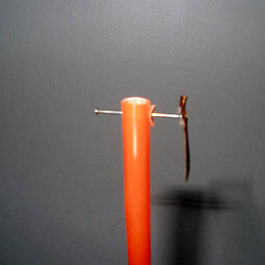

this is what started it all
me blowing on it during photo

« Reply #1 on: February 22, 2005, 09:00:37 PM »
You might be able to cut the counterweight size down by drilling and inserting lead plugs.
I think you're on to something here and it will be great to see where this ends up!

« Reply #2 on: February 22, 2005, 09:34:28 PM »
Don't forget that the center of mass on the big blade may not be on a line through the center of the blade.  Maybe your counterweights should be at 117 and 237 degrees for example.

« Reply #3 on: February 22, 2005, 10:53:29 PM »
that's true rp, when I went to lay out the counterweight locations I realized that I needed a reference point on the main blade and it should be the center of mass so I hung the main blade off the hub and used a 4' carpenters level to locate center down the length. If you closely examine the picture with the balance blades you'll see the centerline of the main blade falls slightly behind the apex of the tip.
Ted, I was just today looking at lead downrigger weights and wondering if they would be good to melt down to do what you were thinking. I have no experience doing this though.

« Reply #6 on: February 23, 2005, 07:26:46 AM »
on the original model the axis is offset more than your wooden enlargement the section with parallel sides is much longer

I just feel like this kinda blade can never be balanced. Sure you can balance it on a nail of hanging from a string, but as soon as it starts to spin the centrifugal forces start taking over making it unbalanced again. You could balance it for a specific RPM but will become unbalanced as RPM becomes faster or slower.
The center of gravity is changing in relation to the RPMs.
As RPM increase, the long part of the blade becomes more affected and pulls harder from the center than the short counterbalance. The Maple seed compensates for this action by changing it's center balance point depending on the speed of the spin.
It may work if you get the counterbalance extended the correct distance from the center.

« Reply #14 on: February 23, 2005, 07:40:46 PM »
woof,
If the mass on both sides is the same it should rotate free of vibration at any speed. I'm going to do some more research on centrifugal and centripedal forces before I do the next one.
