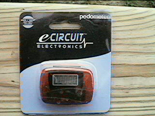

I finally ran across a real $1 digital counter
(a pedometer) only 2 functions ...it counts and
you can reset it.
  It has a button battery that's supposed to last
for 24 months if it counts to 99,999 daily.
  The part I like the best is it stays on continually..
don't have to worry about it shutting off.
Here's what they look like in the package.

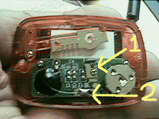

    It's about the easiest yet to wire up to a
magnetic reed switch.
     Take the back cover off ....only 2 screws,
hook a wire from the MRS to (1)and the other wire
to (2), on (1)loosen the screw and slip the bare
ended lead under the contact clip and tighten,
at (2) even if you didn't know how to solder or
lack the tool you could wrap the bare ended other lead about 3 times around that spring wire
that is soldered there that leads up to the
pendulem weight arm.....take a nailfile on the edge of the back cover to run your wires out...
it's just that easy!

  You're welcome...just finished hooking up my
second one...drilled two small holes up near the
top left-hand corner just large enough for the two wires...hooked one onto each place....then a
dab of crazy glue at the holes and I was done...
about 5 minutes of work...course I inadverdantly
destroyed the fine wire spring...all thumbs
it'll never work as a pedometer again...
                 Fun!
               ( :>) Norm.
