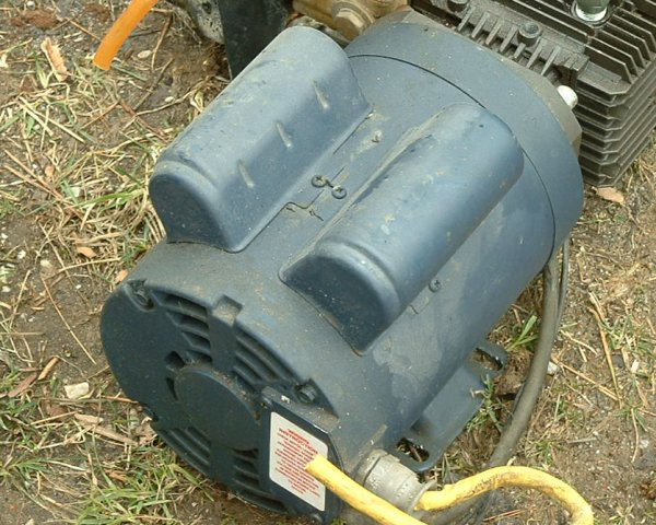

I have been looking everywhere for a suitable motor for conversion. I was about to give up when I found this.
It was in a big old pressure washer. Believe it or not it was at a dump! I won't mention where since I don't want to lose a source of future parts. Here is the nameplate.
I am getting ready to tear into it and see just what I have.
« Last Edit: April 25, 2005, 06:35:07 PM by (unknown) »

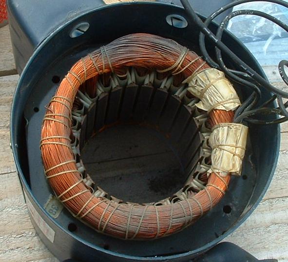

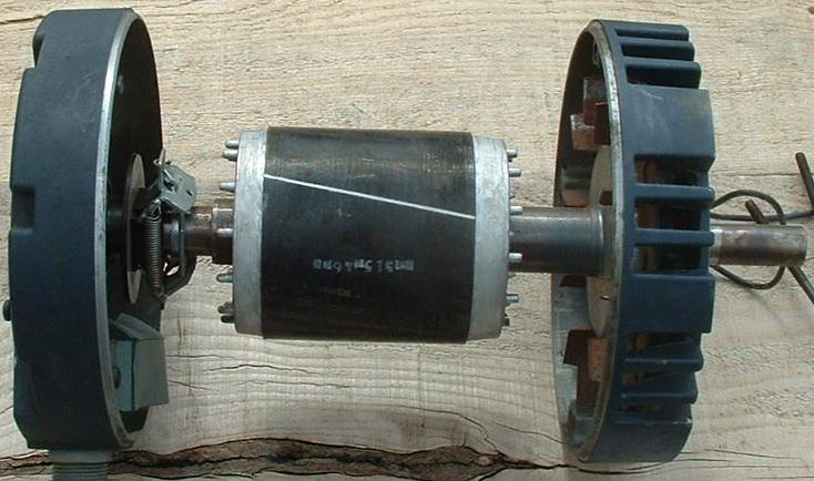

« Reply #7 on: April 26, 2005, 01:28:29 PM »
Some more photos once I tore it apart.
I thought I knew how the windings worked until I took this apart. If I am correct this is a 2 pole motor?
It looks as if I may have to rewind it anyway from the looks of these windings.
Nice bearings and shaft though. It looks like the main part of the shaft is 1" and it is turned down for the bearings.
« Last Edit: April 26, 2005, 01:28:29 PM by Peppyy »
