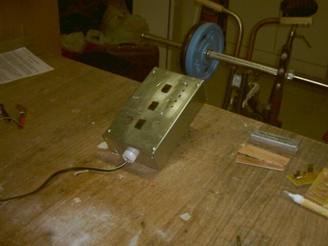

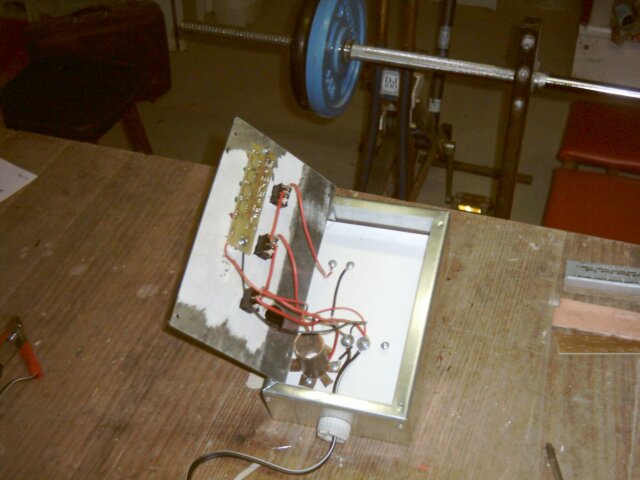

Well, I'm getting geared up to produce the next batch of stuff for our[1] Fijian Rural Electric Light project.
First up, prototype #2 of the Solar Box.  You might remember prototype #1, I've done some work to make it cheaper and simpler to construct.
The major changes are that it now only has a single cigarette lighter socket, and the other 2 switches are for hard-wired loads.  I've also done away with the connector strips, the connections are now made via home-made ring connectors[2] and screws into the baseboard.

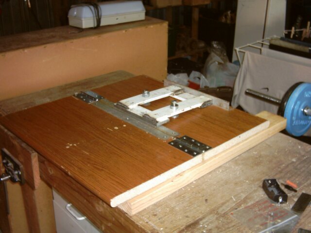

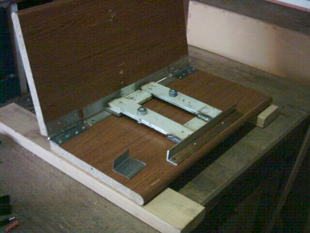

I've also built a sheetmetal folder, sized specifically for constructing the boxes:

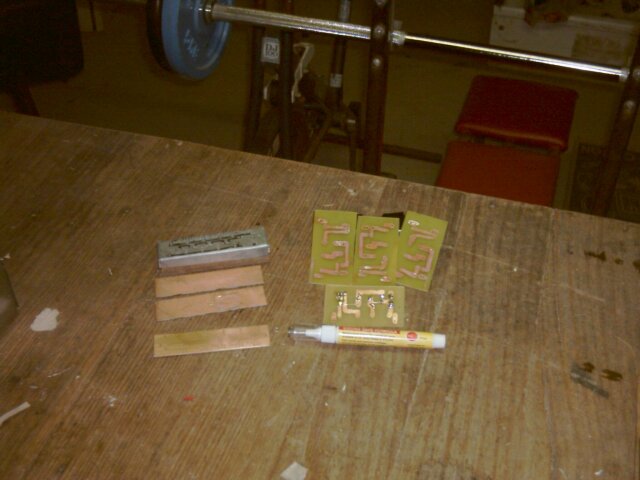

If you're into making PCBs cheaply, I've stopped buying the special $8 lacquer ink pens and started using liquid-paper correction pens instead.  The results are quite good.  I've also given up on ferric chloride etchant, since I discovered that copper chloride is far cheaper and somewhat more environmentally friendly.

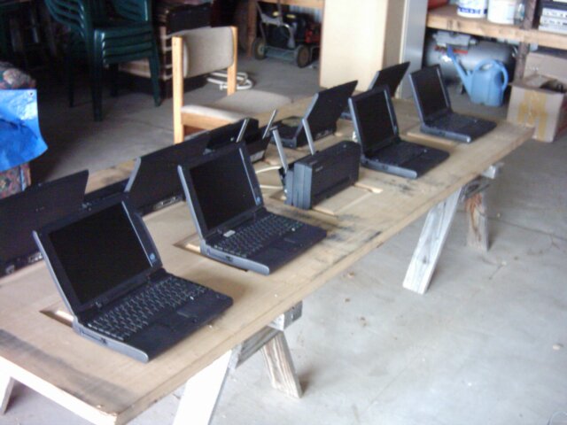

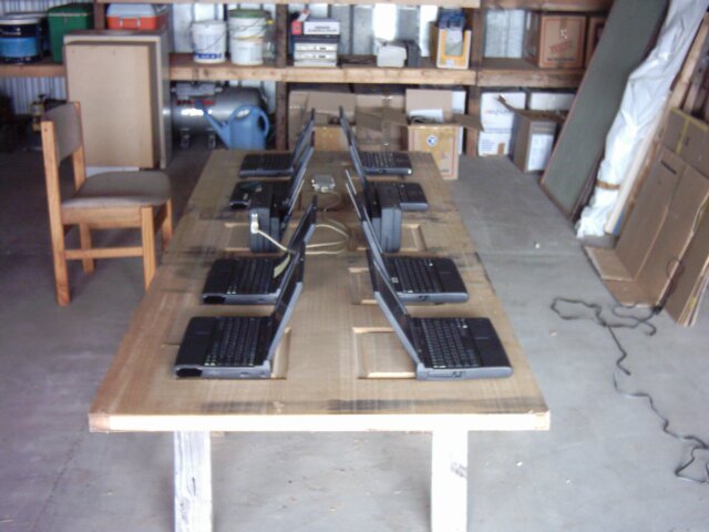

...and finally, here's the computer lab I'm setting up for the school.  The laptops are Acernote Light 370 machines, with a P133 processor and 64MB of ram.  They were cheap[3] because they have no hard drives (easy to replace) or caddies (impoosible to find), so I've set them up to boot from the CD-ROM and load DR-DOS and Breadbox Ensemble into a ramdisk.  It takes about 60 seconds from powering up the machine to being able to do useful work, which I think is quite reasonable.
The printers are HP Deskjet 340s, which need 10.6VDC @ 1500ma.  A simple LM317 voltage regulator should provide that quite comfortably.  The computers specify 18VDC, but work just fine from 12VDC.  Each machine takes about 1500mA to run.  The lab will be hooked up to a 12V/500Ah battery bank, which will be charged by 80W of solar, a 200W wind generator, and a 12A battery charger (for the 4 hours per night that the generator is running).
I've also sourced a couple of automatic 4-way printer switches, which are much simpler to set up that network cabling.

BTH. I have heard the term "Caddie" before but can't recall what it is. Can you enlighten me, please? Thanks. Good luck on forthcoming marriage.

« Reply #2 on: June 05, 2005, 06:03:27 PM »
Jim;
Laptops usually use a "caddie" to hold the hard drive so the generic laptop hard drive fits the specific laptop. Sometimes called a "backpack" too.

« Reply #3 on: June 05, 2005, 06:10:10 PM »
Essentially, it's a little tin box with adaptors that holds the laptop's hard drive.  It lets you quickly remove and swap the drive between machines.  When corporations and governments send their old computers out to auction these days they usually get paranoid and require that the hard drives are destroyed, not just erased.  To do that they usually take the whole drive-and-caddy unit out and throw it in a crusher.
Replacement hard drives are easy to find, but unfortunately the hard drive connector on the motherboard of these machines is a weird mini-centronics thing that I can't find anywhere.  If I could find these plugs I'd convert all the machines to use compact flash cards instead of hard drives, which run faster and use far less power.

« Reply #4 on: June 05, 2005, 08:43:03 PM »
Aha. Now I know what you are referring to.
If your notebooks have USB ports, I'd use the flash drives in those. My dau bought a portable one time. Lo and behold. No USB ports that she needed later. Now everything has USB. My desktop has 9 including one internal port. Wonder why they put it inside?

« Reply #5 on: June 05, 2005, 09:16:45 PM »
Overhead projector markers work well too.

« Reply #7 on: June 05, 2005, 10:32:54 PM »
I'll give them a try.  I tried a permanent marker, but found it difficult to get a thick enough ink trace.

« Reply #8 on: June 05, 2005, 10:35:48 PM »
No USB ports, which is another reason why they were cheap.  And I can't get the DOS drivers to work for the PCMCIA ports either.  Oh well, when I get hold of an external floppy drive for one (hopefully this week) I'm going to make up one for each machine so that the students can save their work.

« Reply #10 on: June 05, 2005, 11:36:47 PM »
BTH, are there serial port drives? I don't know if I have seen any for sure. Just seems like I may have

« Reply #11 on: June 05, 2005, 11:58:41 PM »
You used to be able to buy floppy drives that plugged into a parallel (printer) port, but they had some custom interface hardware built into them.
These laptops have a 26-pin "external floppy drive interface" socket, and if I'm lucky it'll be a pin-to-pin conenction with a standard floppy drive...
