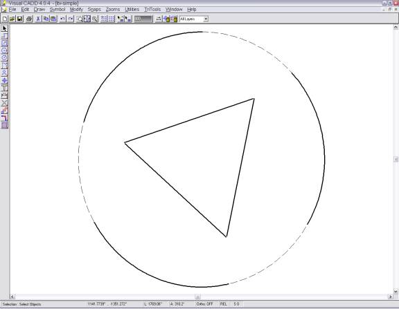

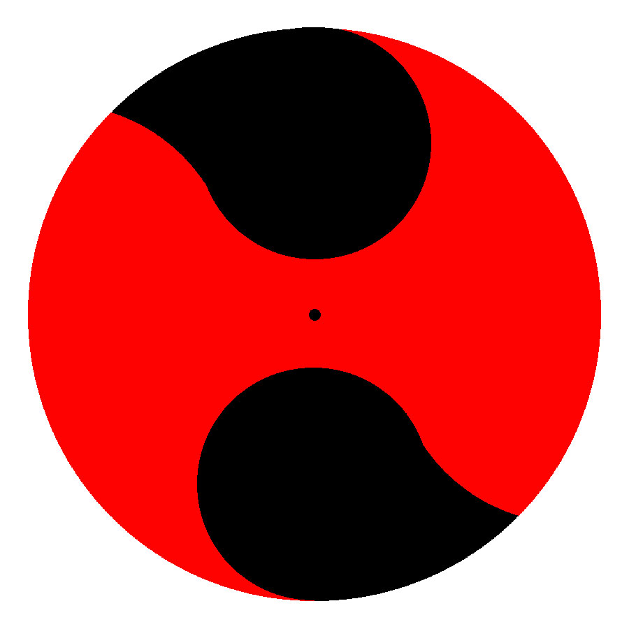

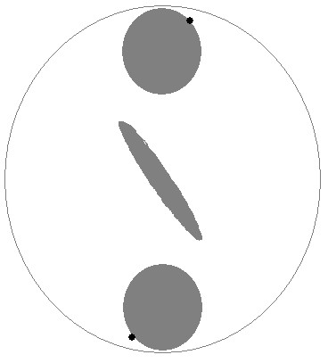

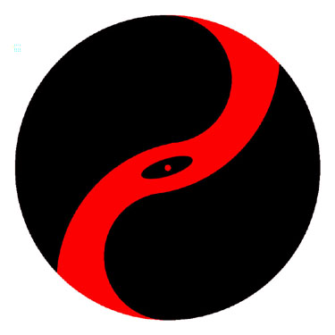

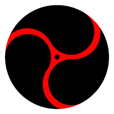

I did these up the day I made the model.
streamlined version
Two blade large cord
Three blade large cord
I think the evolutionary process has begun. I'm just trying to remember deadly simplicity was one of my motivations. I tried the two cylinder without the flaps and it only work in high winds so the flaps stay for sure so I guess whether it's two or three some streamlining is in order.
I will say though that at first my flaps were an inch and a half longer and it worked better after I cut them down so a wide(large)cord may not be the answer. I guess we'll see. At the moment 'I'm thinking the three blader with a narrow cord.
Mike

Good morning to you Mike,
Creating eddies introduces drag (no free ride). Because this drag part in one side of the cylinder (one trip wire) the drag component is unbalanced, creating more startup torque.
Maybe you can lose those flaps!
Including a Lenz separates the cylinders making the rotor diameter bigger increasing torque:
Ray

O jee, me like the streamlined version.
The others look like my old paper models, only the cannels are a bit narrow. Remember I ended up making a Ropatec rotor.
He they look like negative scoop-rotors to, maybe thats positive.

  The first diagram above looks better, I think the more you close off the air flow between the blades the more the pressure will increase as wind speed increases turning the turbine into a solid round cylinder.  This could defeat the power production.  I might be overlooking something but that's the way I see them.
  For a drag machine the 1/2 cylinder produces the highest downwind Cd of around 2.3, unfortunately the upwind side sees a Cd of around 1 so just under half of the power gained is lost to drag on the upwind side. A drag machine extracts its highest power at around a TSR of .33, although, it will continue to produce power up to a TSR of around .7-.8 and after it reaches a TSR of 1 there is no longer any power extraction.  Once you exceed the TSR of 1 your dependant on extracting power primarily from the upwind side as lift although the downwind side will add to that somewhat. The faster its spins the better.  There is alot of energy that can be extracted in the upwind side,  for instance if the machine is in a 15mph wind and the rotor is traveling at a TSR of 1 the upwind blade sees 30mph winds, the downwind see's nothing and is just along for the ride.  The big trick is to get the machine running above 1 and preferably 2 or higher where you can start collecting from both sides as well as front and back.  That's the big advantage the HAWT's have over the VAWT's.  The original idea of the Lenz turbine was to cancel the upwind side drag by using lift allowing the full extraction of the downwind side.  Once I realized there was more power on the upwind side I headed in that direction but only was able to get it to a TSR of around 1.7 so the downwind side still has problems adding much to the extraction.  I wasn't completely satisfied with the results although what I ended up with was a reasonably efficient VAWT with good start up torque.  It still has to be proven in winds above 12mph which is the limit to my home brewed wind tunnel.
  I think mike is on to something and hopefully will surpass the results of my turbine... I agree with mikes statement of keeping it dangerously simple also...
  Great work mike!  I'm following your project with great expectations.   If I wasn't so busy right now I'd be building one to test myself!

I'm going to try a 3 blader with a couple of ideas of my own. I'll let you know how it turns out. Question to any of the folks that calculate things I don't even begin to understand. Based on roto's very first drawing. With 8" total dia., if I use 3" dia tubes, 2 feet long,and the wings are 3" wide and 2' long of course, can anyone come up with a swept area figure or would that be hard to apply in this case. I'm trying to come up with some rough ideas on power output(at say a 10MPH wind) it'd great to get 50-100 watts to start. My plan is to mount it on a ametec PM motor and see what happens.

I think if you want to use a drum effectively just make a Savonius its also the most easiest windmill to make.
Myself was thinking about a combination Darrieus Savonius but then the Savonius placed on one site of the roof ridge electrically kick starting the Darrieus placed on the other side of the ridge.

Morning Ed. I believe your feelings about the solidity of the center are correct. Of the above three images I think only the top one is practical. The lower two were done before I constructed the first model and I have since learned that a shorter flap/cord worked better. I'm considerind what may happen if I added a third cylinder to the top drawing but I'm also afraid it may confuse the airflow through the center. The only thing that is directing the air the right way is the interaction between the two cylinders and I can visualize but not say for sure what will happen with three.
I would also agree but can't say definitively that the center should be left open and if I could with such a small fragile model I'd eliminate the rod through the center as well.
I'm off to try a three cylinder model

ok, this is maybe a crazy idea, but what if the 'lenz' shape in the middle was shaped more flat, and its angle was controlled by a tail, instead of it rotating. then it may be possible to use more cylinders or airfoils, and not have them disturb each other as much?

well if you could post the graphic for the three pillar unit be for you change anything.....
