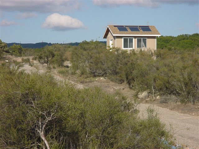

I think I have a pretty decent wind site but I will have to keep size and height to a minimum. I hope to evaluate several small 5'-10' non-commercial HAWT & VAWT turbines here.
As you can see I have a pretty clear Westerly exposure with some propensity for turbulance though.

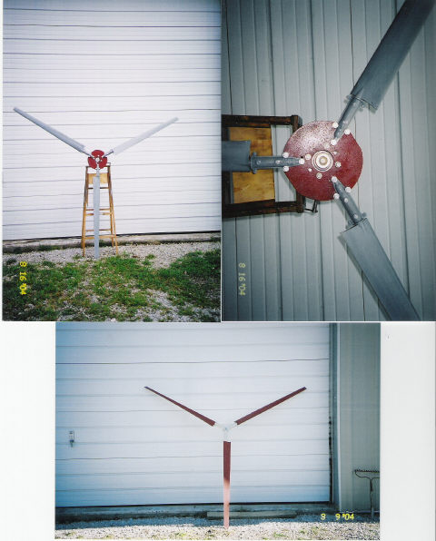

I would like to test a HAWT design using the Art Randolph 8' blades.
In conjunction with a 4th generation reconfigured F&P washing machine motor. Hopefully it will stand up to the severe winter winds.

Nice photos! Thanks for that. Where did you get the idea for the three props from? Are they hollow alum?
« Last Edit: June 22, 2005, 03:07:55 AM by domwild »

Here is more scoop on the blades, they are suggested to produce up to 750 watts hopefully still available at elsieart@ozarkmountains.com
Also see http://www.fieldlines.com/story/2005/4/2/16579/84511
Adrian
