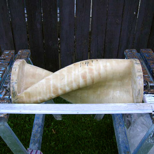

Here's where all my Vawt experiments have taken me. The solid center two cylinder digression back to a savonius but with a twist, literally!
It's a foam core, fiberglass skin with a 3/4" center shaft. Tried it in a straight blade and a helical before the fiberglass went on and the twist was a clear winner. Someday after I hook this up to an alt. I'll build a striaght blade to confirm the diff.
12" diameter x 26" high so I'm still experimenting but I hope this will suffice as a test bed I can add flow augmentation devices to and actually see results.

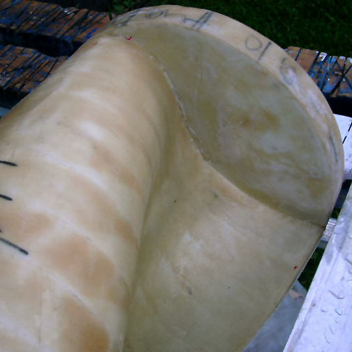

It's clearly not done yet. Needs three more layers of fiberglass, the ends need shaping into a convex dish shape and the center shaft needs to be properly secure before the ends get glassed. So far it weights in somewhere around 8 pounds with the shaft.
Having fun and perhaps actually getting closer the production of a small amount of power.
Mike

  Very Nice Mike!  I'm a bit skeptical about the helical design.  When I was testing some multi wing units I found you get a small "band" of power from the wings that were exposed to the incomming wind.  Although, the torque was continuous as opposed to pulsing you end up with far less than the pulsed torque.
  I like the idea of augmentation or adding a diffuser(s).   This really increases the power of a small turbine and we have them built in to our normal environmemt.  May as well use them.
  How soon before you'll have this one up and ready for testing?  I'm interested in the outcome!

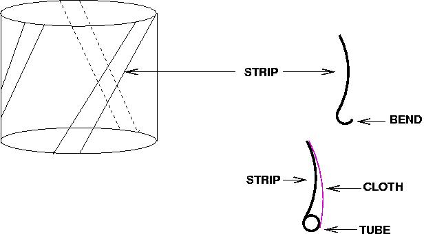

Some time ago I started to think
about making a kind of Gorlov
machine using a metal drum.
A draft for the machine was like this:
Then I made a very small
scaled-down model:
I've also made a model like that
of a PVC tube about 80 cm X 40 cm.
Unfortunately it became quite heavy
and it seems to need quite a storm wind
to start. No pictures of that one yet.

What kind of foam/resin combo did you use to get past the melting of your foam? Someone on this board has told me that if I cast my blades out of expanding foam, and try to glass it, it will melt. Would you suggest any retailers that carry the right materials?

Blue styrofoam made by Dow will resist melting with both vinylester and epoxy resins such as west system. Even the pink stuff will work too but you have to remove the protective film. I suggest you use the blue...
Lowes, home depot has the foam and vinylester resin.
« Last Edit: August 16, 2005, 03:52:00 PM by cdg378 »

I share your concern Ed, I taped the sections together (1 1/2 HD CC extruded polystyrene cut in identical sections and stacked) in a straight format and a helical format. The helical format had a much higher unloaded rpm and a greater range of operation. I'd like to someday try both but the staight was disappointing in comparison, could be the shape.
My greatest concern about the helical design is how it will effect the use of flow augmentor such as the tubercles. I just can't reconcile if they will still work right if they don't in pairs at the same time. The experiments will be fun.

The foam I used Owens Corning's Celfortec 200. It's a high density pink closed cell extruded polystyrene foam and as cdg378 said an epoxy resin will not melt it. I don't know about vinylesters and the pink foam has no protective film on it. I read recently that some RC modelers have been using Minwax Polycrylic clearcoat as resin with good success as it's safe as well. I won't vouch for the strength of the polycrylic but it may make a good "sealer coat" allowing you to finish with a typical polyester resin.
Polyester resins definitely melt polystyrene foam products.
The blue and pink foam have subtle differences mainly with respect to their densities and compressive strengths. Both are closed cell extruded polystyrene so both should work. The key is to find the compressive strength that suits your needs. For my need I could go with a lower strength of 20 psi but for Hawt blades I would get the highest possible. In the pink you can get up to 100 psi for industrial applications but the highest your likely to find in a home center is 25 - 30 psi depending on brand. The Celfortec 200 is 20 psi the Foamular 150 is 15 psi the 250 is 25 on so on.
Have a look here:
http://www.owenscorning.com/around/insulation/products/foamular.asp
I used a polyester resin but do not recomend anyone else use it. I used a primer sealer as a barrier coat but there was still some deformation. I will try the polycrylic for the ends with structural layers of polyester after and post the results in the future.
The safe but expensive bet is an epoxy resin.
Hope that helps.
