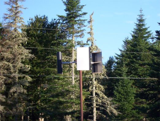

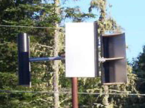

First I built a small prototype of a drag type version that I hoped might have some lift assistance. Here is the pic of that original mill:

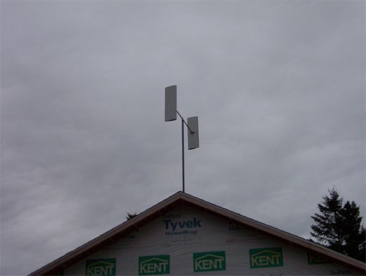

I mounted this mill on the roof of my garage. The rotor was sitting at ~ 28' high.
Unfortunately this mill performed badly. It turned very slowly and it soon became apparent that I would have to try another design. This time I went with a H rotor design. I used the NACA 0018 airfoil and made the blades 36" long and made the rotor diameter 60". Here is the pic of that mill:
This mill worked really well, it selfstarted and turned quite fast. I still have to get some monitering tools like a digital RPM meter so that I can determine the speed of the mill.

Looks like you are having lots of fun with these plans.  Sorry to be a wet sock, but  you are headed down a dangerous path.  I put up a diary suggesting something along these lines but a little bit smaller just last week.  The experts around here quickly set about convincing me that it is too dangerous.  The centrifugal forces on the wings on an H style mill of large size are really amazing.  People have died from flying parts when such experiments have flown to pieces at high speeds.  A Lenz or Savoniuous style VAWT spins a lot slower and thus is much safer.  I've decided to experiment with scaling up the Lenz design that Ed at WindstuffNow is experimenting with.

unless you have alot of time, money, equipment, and an understanding underwriter i wouldnt go the 15 kwatt unit of any design, be it vertical or horizonal.
the stresses and other problems in this class of machine are beyond the scope of most mortals. The damage and destruction can be very significant on a large machine and likely go up with the square of rotor diameter just as power goes up, and with the cube as when the wind speed doubles.

I liked your first model better. I think the reason it didn't work well is your blade setup.
 If you were to take the blades and turn them over so the flat panel is on the inside then you would have a blade that is producing lift towards the inside of the circumference. Both Ed and I seem to think that having the lift moment towards the inside is a better configuration than towards the outside. In fact if you flipped the blades and set the trailing edge 9 degrees to the inside of the circumference then you have a "Lenz Turbine". The 9 degree angle puts the lift moment ahead of the axis and was tested by Ed on his unit.
Try it it should work.

reg , you were on the cutting edge of design and didn't realise it ! flip that baby around like roto suggests and build a pmg for it . when thats done build another twice as big.

Also:  If you make a lenz or savonius a bit bigger than a darrieus-style (half again as high, half agiain as wide, or about 23% bigger both high and wide) it should give you a tad more power than the best darrieus while still turning with the tips moving slower than the wind rather than several times faster.
You need more magnets and a bigger radius in your genny, or a higher ratio in your gearing/belt/whatever, due to the higher torque/lower speed tradeoff.  But IMHO the safety is worth it.  (Also, you've already got a really wide disk at right angles to the wind where you can build a REALLY large-radius axial-flux genny if you feel like it.)
Engineering a Darrius not to resonate, fatigue, and fail - with pieces flying outward at a couple hundred MPH - is HARD.  Several companies with professional engineers have tried and failed.  A savonius is garage-tinkerer rule-of-thumb stuff.
