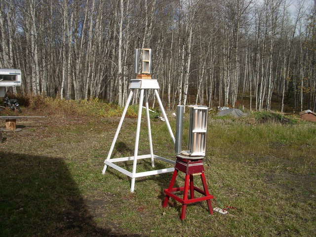

Hi
Been out of the picture for a year as building my house. Keeping up to Ed's great work or trying to. The small one on white little tower is just free running and runs in a slight breeze. The bigger one is not done yet and now have top/bottom plates with generator on bottom. It has 16 magnets and 12 coils. Wired up as 3 phase. Spin by hand get about 2 volts. Having problem keeping the steel plate horiz to coils and have a gap which is too large. Fixing this then hope tie it to top of van for a drive.
Wayne

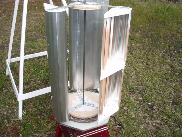

Try running the shaft through the bearing to at least the rotor's height below the genny, then put another bearing there to take the side force.  That's equivalent to putting a bearing at the top, without requiring a structure around the rotor to impede the wind.
Of course you DO need a stiff shaft or it will bend.  So you'll probably need to make your shaft bigger.  (Or substitute a piece of pipe:  essentially all the strength is near the surface anyhow, so why bother with all that weight in the middle?  B-) )
The wind going around the shaft may affect the performance somewhat, but not necessarily in a bad way.  (I recall Ed's early designs had a big cylinder there to speed up the wind as it passed the blades.)  You might get an improvement.  You'll probably get a tiny change to the ideal radii and angles for the blades.

  Nice job Wayne !  I agree with ULR, I think you'll need a stiffer shaft in the larger one to keep it stable or like I did my 3x4 with an H frame and bearing top and bottom.
  What did you use for sheet to form the wings?  What size is the larger one?
  I just finished a 2x2ft thats going to the wind tunnel in a week or so, been playing with it and it seems to do fairly well but not as well as it should.... or as well as the others.  The only thing I changed was the way the trailing edge was made making it cleaner, allowing the air to flow smoothly.  My larger one has a bent end and is very dirty in the air, seems to work quite well that way.  The original one is like yours, just a clean flat trailing edge and works great.   I've had to change the wing angle to get the newest one to perform.  There is a secret waiting to be discovered somewhere in there!

Thanks for your nice comments Ed. Its a start for me from my little ones. This one is 18" dia and 2 feet height. I have a 5 degree angle on each one. Can't see this on pic. I used cheap aluminium flashing for roofs to cover it. Bends easy. The shaft is only 5/16" and is the weak link. I used this because I had some roller bearing laying around looking for a home. Might be too small. Hope to fix it and test on sunday.

Hey Wayne, the last vertical I built was 12 x 26" and I used a 3/4" shaft. The bearings at the base are 6" apart (two of them). It's a strong setup. I worked up to that from shafts that where too small so I would recommend 3/4" shaft. Seems big I know but it doesn't cost much more than 1/2" and it gives it the rigidity you want.

Thinking now of using 3/4" shaft and using two plates 6" apart with bearings. Then no top support which might be better. I went out to auto stores and asked for bearing and got the run around O.D, I.D bearing loading, what type? And on and on. Mike do you have any pics of your support I could see and what bearings should I use.

The shaft is definitely weak IMHO. I would try 3/4" steel pipe. As for the plates you could probably put stiffening "spokes" or ribs onto the plates in a radial pattern. Thick plate (say at least 3/8") would work but they would take too much force to start spinning I bet -- too much inertia.

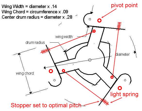

Most of the information I have been able to find comes from http://www.ecoinn.co.nz They state in this file http://www.ecoinn.co.nz/pdf/smartdrive_wind_turbine.pdf that the Cogging force in grams measured at perimeter of rotor for an uncogged stator is 900-950. After the stator has been decogged, it is 450-500.
Based on what your reply was, I would need to build one a bit bigger if I want it to start in lighter breeze - any suggestions for a starting point?
I have rewired mine as an 80SP which is supposed to start generating usable watts a 250-300 RPM - well enough for me, I'm only looking to keep a single 120A wet cell deep cycle charged that has a constant 5.5-6A draw on it. (graphs at the bottom of this file http://www.ecoinn.co.nz/pdf/smartdrive_what_is_it.pdf).
Also, since I'm not really comprehending some of the settings you guys use mentioning, I was going to make my wing adjustable and measure any RPM differences.
I also thought of an idea, since kitno455 mentioned it here(if we could only get rid of the downwind blades - http://www.fieldlines.com/comments/2005/8/18/19637/0978/7#7 ). This modified diagram of yours will describe it better.
As a newbie, I'm probably treading on covered territory, but I'm going to try it.
BTW, I am building to your current design. The above image was the easiest to find and use to describe my idea ;-)

  I've run into a couple oddities on the newer versions.  The control system you have there may take it from good performance to better as the wind pick up.  Originally I thought it would make the wings a bit more dirty by changing the angle.   In reality it changes the angle that the power pulse occurs.  By changing the wing angle closer to the 0 degree mark will actually speed it up.   This is still in its early testing stages but the control system may actually help not hinder as I thought earlier.

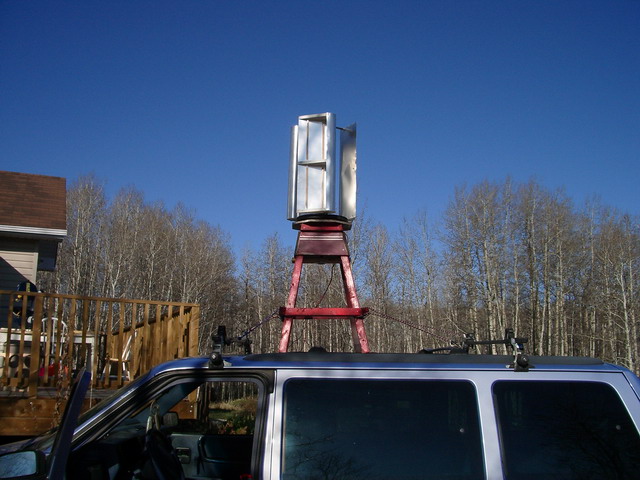

« Reply #21 on: October 31, 2005, 11:46:54 AM »
Hi
I finally got a new 3/4 SS shaft and two bearings at bottom. This seems really good and no wobble and very solid. So on sunday took it for a drive. When I spin by hand the output is about 2-3 volts. As I drove to 5mph the turbine would not turn and seems to lock, and as I drove faster it finally unlocked and spun. Not happy here and maybe the angles are not right. My little one turns in a slight breeze. As for power to charge 12 volt battery this was about 15mph at about 3.5watts. Very sad with this after all the work. The turbine is not spinning fast enough I guess. So have 2 problems now is need low RPM gen and fix the stall problem. Back to drawing board again.
Wayne
