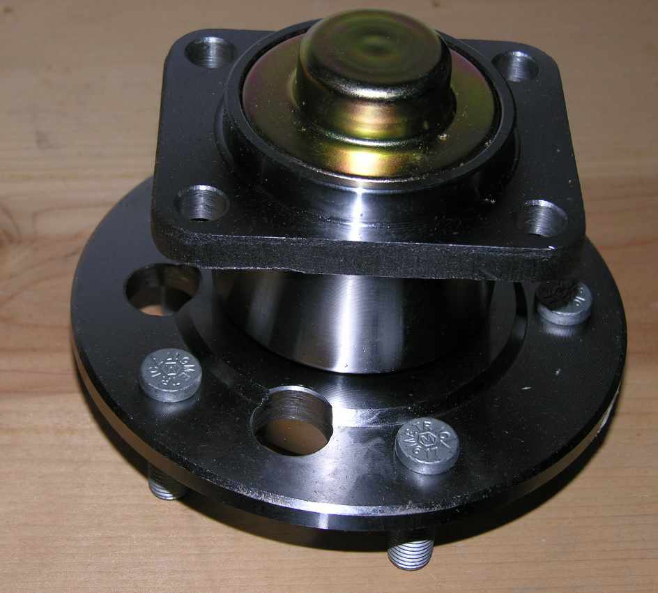

Hi Alan,
What a coincidence.  While you were posting this, I was at AutoZone buying one that looks identicall.  Did you wind up using this type, or did you bow to the pressure of the Audi or Caddilac crew?
A cute girl at the store helped me open a whole mess of boxes looking for one like this that had bolt holes on both "ends" of the bearings.  Since my application is Vertical, I don't think I need to worry about any of it walking anywhere (fingers crossed).
Do you happen to know what type of a car it is from?  We weren't able to cross reference it back to a car from the aftermarket numbers on the box.

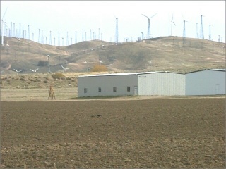

Here is a photo of some windmills sold at a garden nursery here up in our mountains up on the high desert in heights from 8' to 20' on their wood towers. The public rules on esthetics and it is the 20 footers that sold out. IntegEner-W purchased one of the 15 foot towers sans rotor for mounting a different rotor and an energy producing unit on it and it has been located next to an industrial complex at our glider airport here. Even the whole group of them together in the photo is attractive.
You appear to be taking on a much bigger project than what it may seem to you to be and are neglecting some worthwhile ideas. My suggestion at this point is to buy a pocket wind meter like the Kestrel 1000, to be found on eBay, and tell us exactly what you find your "consistent" wind to be. It will give you a much better idea of what height you need and get you better support from others who have "been there".

the first thread was not mine, i just commented on it, so i dont know what car that was. you nead to read my thread pretty carefully though, but i will re-state it here, for posterity:
If you use an auto-derived hub that has a splined hole thru it for the outer CV, you simply MUST put something similar in the hole, with big washers on both ends. these joints are a simple press-fit (though admittedly a tight one), and will come apart under load. VAWT application is likely worse than hawt, due to the mechanical advantage  they have over the bearing.
i used chevy s-10 4x4 front hubs in my experimental mill. it was only up on a short pole for a few days, however, so i cant give long term test results. I have used the same hub on cars for quite a few years, and have had no major problems. the 1990 and up full-size GM 4x4's use IFS, and are usually 6-bolt wheel flange. if i ever build a larger prop, that is what i would use.
allan

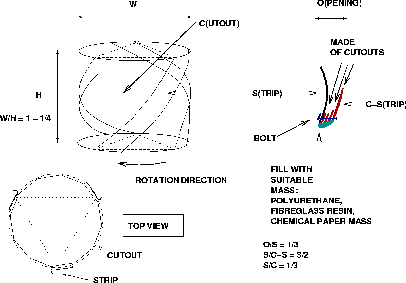

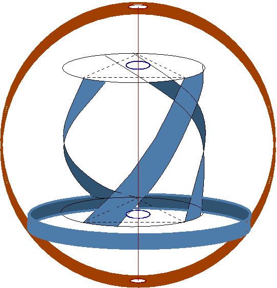

make a 'Lenz2' turbine prototype
and a 'Picoturbine' prototype.
I think that you will
get a reasonable amount
of power from those machines.
In principle the efficiency
of Savonius turbines is
about 30% - 35% if you'll
use a correct shape.
Ed's Lenz2 might be even better.

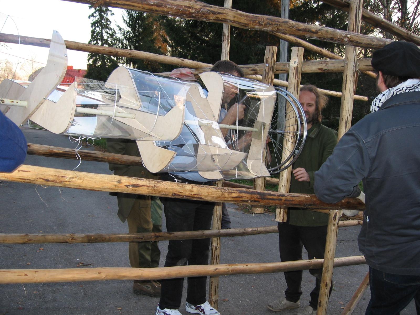

We started to make a prototype
of 'Picoturbine 250' some
time ago, but the project
has not been finished yet.
I've myself planning for
a bit different VAWT,
but a working prototype
hasn't been made,
I've only made of
a plastic tube a model
to check out, how
easy it is to make
the correct shape.

kitno,
It seems I just don't get it yet.
Looking at the hub shown in this post:
hub like the one I bought
If I were to use the bolt holes on one end of the assembly to bolt the thing down to a base of some sort, and use the bolt holes on the other end of the assembly to bolt on some sort of a bottom plate for the VAWT/alternator rotor, then all of the weight of the VAWT would be pushing down on the hub assembly, ostensibly holding it together.
In such a use, you would still expect it to come apart?
thanks,
jp

« Reply #26 on: November 23, 2005, 08:16:26 PM »
yes. think of it this way, not only is gravity pushing down on the bearing, the wind is pushing sideways along the whole of the vawt. that is acting like a big lever, trying to pop the center right out of the joint.
remember, any mill makes power by slowing the wind, the bigger the mill, the more force it has to withstand. these bearings are quite strong, but they require this bolt in tension to hold them together against the kind of forces you will see with anything over a couple feet square. do NOT rely on the press-fit alone.
allan

Thanks to all who have commented so far.
It looks like I'm going to be taking back the hub assembly I bought this week.  They had another one that had bolt holes for both the hub and the spindle, and no center shaft area. Completely sealed.  I'm going to assume it does not suffer from the problem kitno mentioned with the first hub I bought.  Main down side is that it costs $40 more than this one.  No big deal.  Seems a bit heavier duty than what I really would need.
Would still like to find a line on bought-new trailer hub/spindle assemblies.  Other than online (where I can't play touchy feely  with it and decide if I like it) any suggestions on where one might go shopping for something like this?  The auto parts store people just kind of cocked their heads to one side and stood there with a dumb look on their face when I mentioned trailer hubs.
thanks,

« Reply #32 on: November 25, 2005, 03:09:59 PM »
Well, on kitno's advice I took back the first one with the splined center hole. Not knowing of any junk yards in the area with a clerk as cute as "Star" at AutoZone, I decided to get the other one they had there.  This is what the new hub looks like.
Who knew that clerk cuteness would become a relevant engineering criteria.
If anyone knows a reason why this won't work well for a VAWT, please speak now or wait and laugh later when it doesn't work.
thanks,
jp
