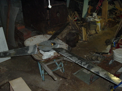

test post picture:

Looks like it worked ok.  Pic size ok, loaded fast etc.  Any particular reason for the camo colored blades?

   Looks like your blades have twist, good. Please tell us about the construction. Looks like they may be glass skinned with a wire trailing edge.

old alum sheet. trying stressed skin on tube for blades. base is 1/2" emt. with 5/8
grade 5 x 8" bolt with head cut off hammered into tube for root of blade.
root is 9" @19 deg. tip is 4" @2 deg.
center plates are 10 ga. 1/4x20 grade 8 fastens blades to plates.
total rotor weight... 21.5# dia. 8.5 ft
will monotior rpm with modified optical tach. 2 3/8 x 1/16 neos on back of hub. w/pickup coil.
wind speed, bicycle anemometer
alt.= dual plate 12 pole 9 coils star. shaped mags from ed, mount from hugh, i'm hopeing for a good mix, time and mother will tell the whole story.

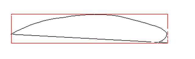

Looks to be a nice profile, I just hope aluminium holds together.

i dou"t if those metal rods will hold up--your blades will end up bending back and hitting the pole--or worse..thats a lot of blade just for on rod to hold ridged..
you could bury those blades in wood , like my angled wooden hub..
