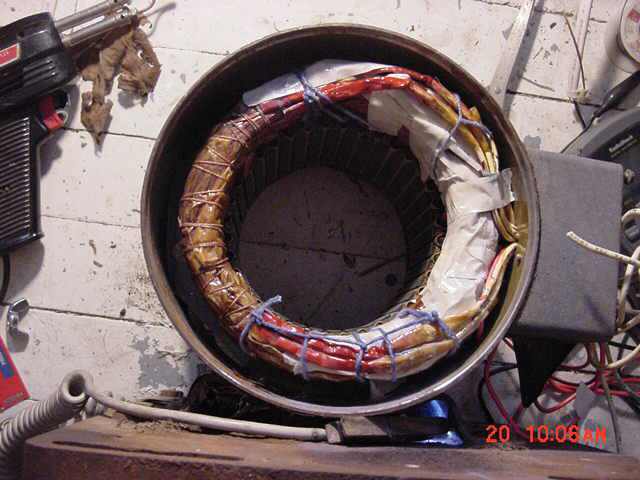

Well this is an update on my 3 hp Baldor conversion. Started this several months ago set aside for the summer(and do to the frustration of trying to get the mags all on there)boy hat was a chore. Four poles 9 mags each for a total of 36(was going to be 40, but I broke one so to keep the poles even I removed one from each pole).
Still have to cleanup resin on armature.

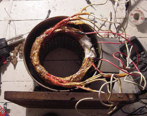

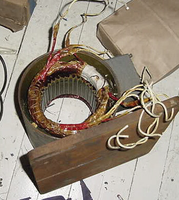

Here is a shot of the stator housing and stator after pulling ends of coils to add 3 wires for a total of 12 as per Zubs instructions, and below shows the 3 new leads(red).
Last shot is the coil ends all tucked back into place and tied,taped, and shellaced back in place. All coils measure 1.3 ohms, they seem to be 2 strands each of some pretty fine wire(not sure what gauge maybe 20). Hope that resistance is OK.

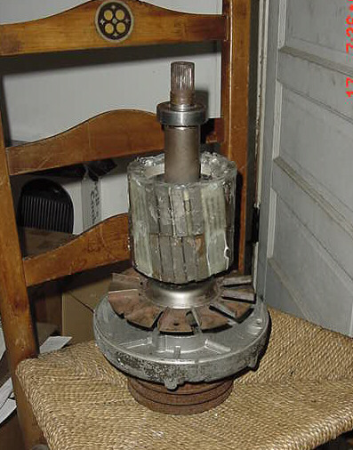

Now all I've left to assemble is to figure out putting the armature back in the stator (without loseing fingeres), I remember the battle I had with the small 1/2 hp that's still flying BTW, and it only had 12 mags. Probably will use some king of a suspended come-a-long to lower the armature and tie the housing to a heavy table saw table. That's plan A anyway haven't thought of Plan B yet. I do hope everything fit's correctly as I don't rellish the thought of taking it apart.
I have a small lathe that I will be using to spin it up with and I will be posting #'s as soon as I get them.
Question: Is it best to get open voltage off one coil (at dirrerent speeds)and then calculate power from coil (using formula on Ed's site)to find out how I want to wire the coils for final setup, and to figure blade size, speed, TSR and so forth. I want this one to start pretty slow (almost always have 6-10 mph wind at ground level here)and peak (furl) at about 30-35 mph. I'm thinking 9-10' dia prop.
Well that's it so far!!

"All coils measure 1.3 ohms, they seem to be 2 strands each of some pretty fine wire(not sure what gauge maybe 20). Hope that resistance is OK."
I don't know what kind of voltage you will be getting out of this conversion, or if you intend to use it at 12 or 24 V; but I suspect the 1.3 Ohms (dc R) will be a significant limiter on how much power you get out of it.  If the original operating voltage was 220VAC single phase you will likely see about 3 Ohms total impedance at around 450 RPM (Dc resistance + Inductive resistance).  So lets assume you are getting 40V DC output at 450 RPM (a guess here on my part, it may be much more or less) and want to charge 12V batteries.  The amount of current you will get will be (40V-12V) / 3 Ohms = 9.33 Amps and 112 Watts.  Not really a big amount for such a large motor.  If you were charging 24V batteries you would get 5.33 Amps and 128 Watts.  The higher the RPM the more impedance you will get.  If you get higher voltage at the 450 RPM I arbitrarily selected the amount of current and power will be higher.  Note my estimations are for single phase, but since you brought out 12 leads, maybe it was a 3 phase motor and you will be using it as a 3 phase alternator.  If so the numbers will be different but the impedance will still be somewhat high to get a significant amount of power.  I may be all wrong on this and it might do better than I suspect with all the magnets you were able to stuff in there - it must have been a buger to do that and hold them in place while you were glueing them.

first thing!  putting in these rotors of larger motors are quite dangerous. they have a lightning speed once the mags get attracted to the stator.
you need extra caution on your unit because of the internal cooling fan. what happens is once it starts to fly in, it will (for a split second) go past rotor/stator alignment, and then snap back to alignment. the extra travel will force the cooling fan fins into the winding cuasing damage.
here is what you can try.
if you have a very heavy workbench (make sure it is loaded up with about 300 pounds of stuff on it, or have a few buddys stand on the bench to give it extra weight. drill a hole in the bench, or block up for the rotorshaft extension that is longer than the frame of the motor. stand the stator frame vertical over the hole or vewrical on the blocking. then use 3 or more of those nylon binding straps they use to hold down loads on trucks. some have a little ratcheting tightener.
use a small boat winch or a ratcheting type chain hoist to lower the rotor into the stator frame. you could somehow chain the pully on the shaft to help lower it. or, you could drill and tap the end of the shaft for a 1/2 inch bolt and screw in a i bolt to attach chain. i also use that hole to hold my props on.
the attraction of the rotor into the stator would i guarantee take off your fingers if they got caught in there. glad you already realized this but had to mention it again.
with your 12 leads you can now connect 1 or 2 star, or 1 or 2 delta. i seem to find most 230/460 volt motors once converted, seem to match up cut in speed pretty good at 2 delta for 12 volt and 1 delta for 24 volt. they do vary a bit.
i think it was ghurd that asked if more than 1 wire in hand was common for factorys to wind motors with. anywheres from 1 to 20 wires in hand is common.

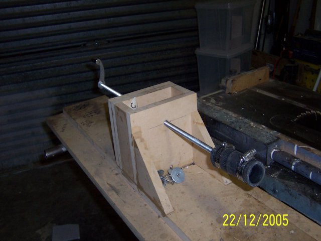

If you are planning on taking it apart more than once its worth making something like this pic works real good only took about an hour to make. Use 2 hose clips on each end and heavy reinforced hosing it stretches a bit but has never let go (yet).
Also a nut sandwiched between the two boards .

I assume that shaft is allthread correct?

Yes allthread ,old fishing reel handle,and a bunch of washers under the hose, two or three bearings on the end would be better though, just screw the motor down with big washers they,ll never come out.

Cool idea, I'm hoping this won't have to come apart for a long time, and for now I'll put it together with the sling and table saw. However when the day comes (and I say when not if) I'll just build that little armature puller of yours, maybe even take the time to make that 'center of shaft' adustable up and down so it can be used on all machines just by adjusting and exchanging hose for different shaft sizes.

As it is you can move it up and down about 3 inches with the flex of the hose.
