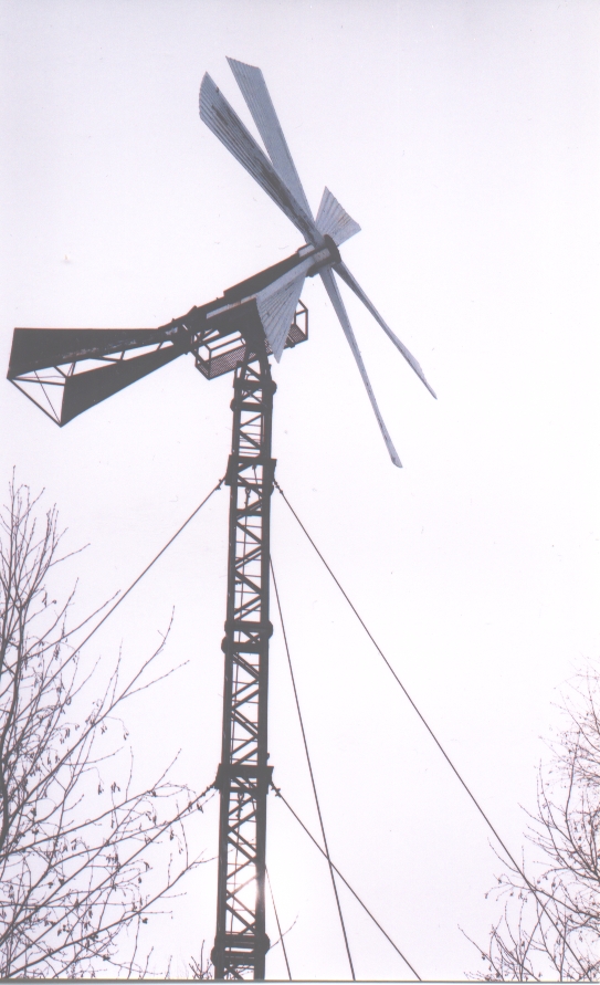

Here is a picture of an original 'Reinikainen machine', which is still working after about 15 years in use.

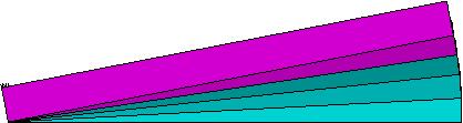

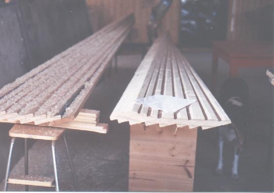

The blades are made by laying wooden boards on the top of each others like a fan and then using tools.

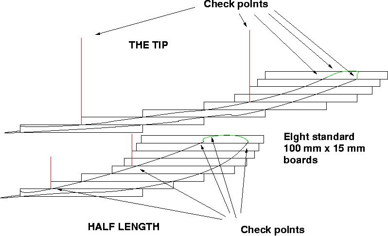

My plan was to use on the tips the K2 airfoil.
Here is a picture how the blades were made in 'Eki's workshop.

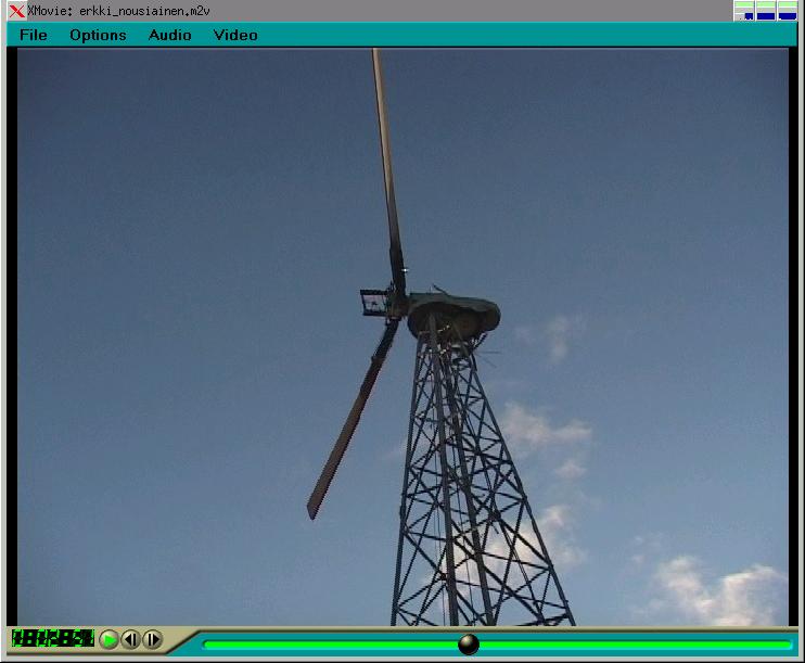

Here the blades are installed on the wind machine, of 'Eki'.
There is no pitch control mechanism used, but some working parts like the counterweights were left there...

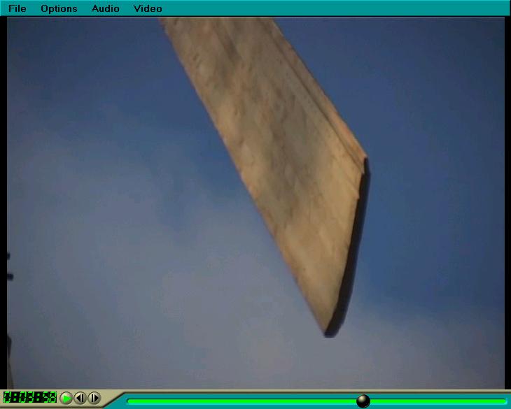

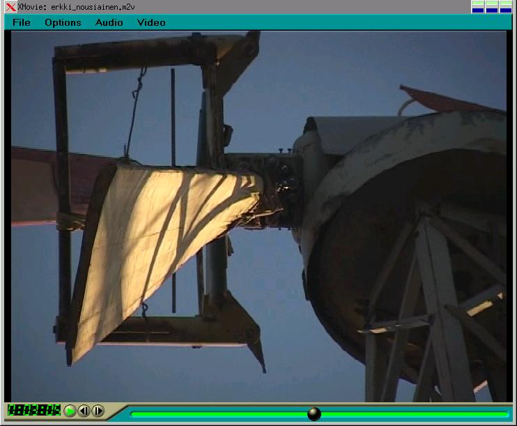

Here is a shot of the blade tip.
Another shot of the tip of a blade showing clearly the K2 airfoil.
The last three pictures are taken from a video tape as made by 'Ossi'. We are working with the video, there is lots of other information about 'Eki's other machinery there.
Unfortunately 'Eki' didn't manage to get the induction generator working. He left the machine turning free during a stormy night in the winter 2004. At that time I was in India. I heard next day by email that the wind rotor was broken.
In my opinion the wind rotor was really successful. It was going quite fast, at least when going 'free'. 60 RPM was quite easy to achieve.
It was broken because of the too fast speed and mainly because the old weights of the discharged pitch control mechanism went loose and started banging 'out and in'.

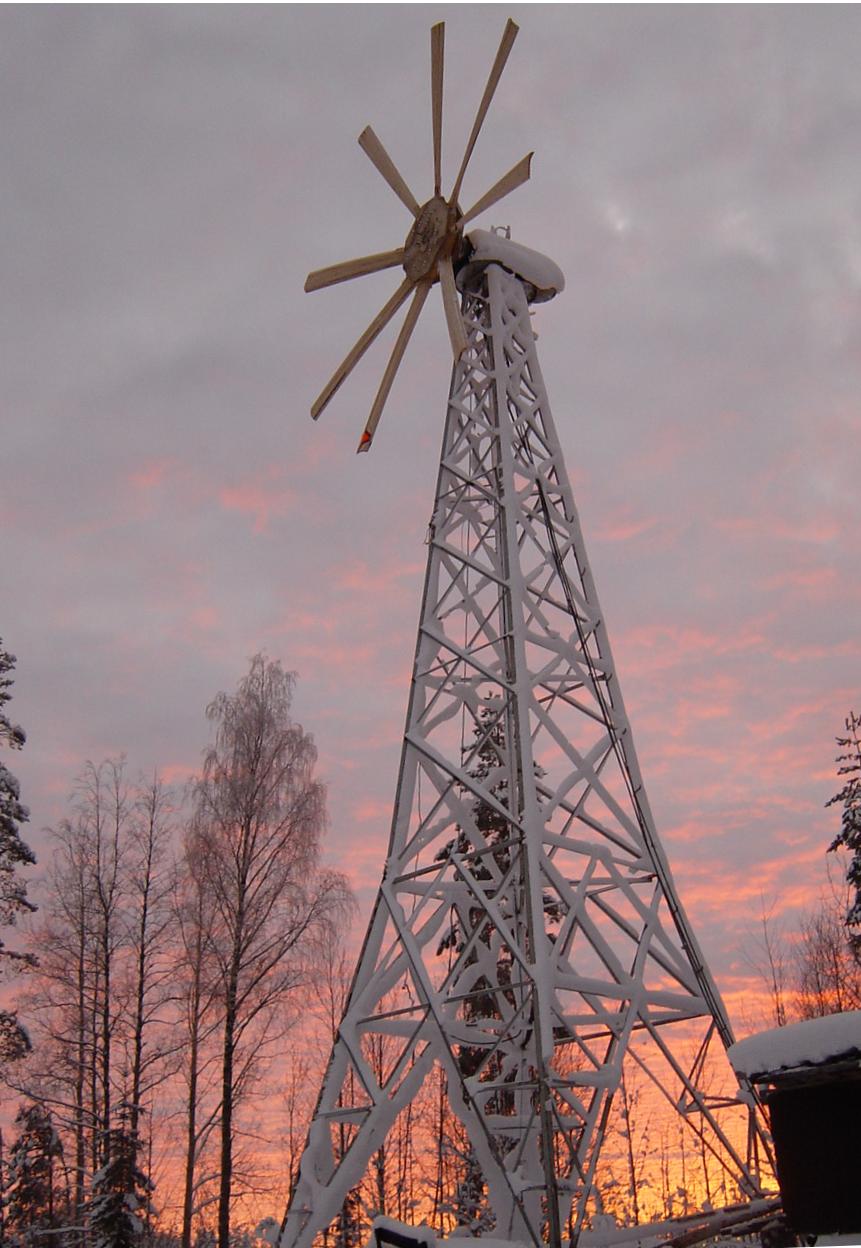

'Eki' lifted the new rotor up yesterday.
The rotor construction is something
quite similar as with the 'Reinikainen'
machine. But the shape of the blades
is quite much like the K2 airfoil.
Waiting for the wind.
« Last Edit: January 08, 2006, 06:28:31 AM by hvirtane »

Great pictures! Is this a wooden tower? Looks like it.
Interesting method of blade construction. They may not be aerodynamically perfect, but, what the heck, they work.
« Last Edit: January 16, 2006, 11:20:05 PM by domwild »
hvirtane
  • Posts: 712
    • About Solar Cooking
Re: Big, unconventional blades
« Reply #5 on: January 17, 2006, 06:07:49 AM »
The tower is made of angle iron.
We are little by little developing
this blade making design.
