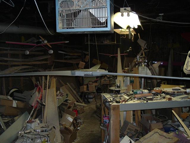

I DID NOT USE THE STRESSED SKIN BLADES .... STARTED TO COME LOOSE WITH BOUT
1 HOUR OF WAGGLE TIME ON THE GROUND.
SOOOOOOOO I carved a set of wood blades, and here is i think a novel way to balance
I think.
With paint!
The light blade only took 1 extra coat.

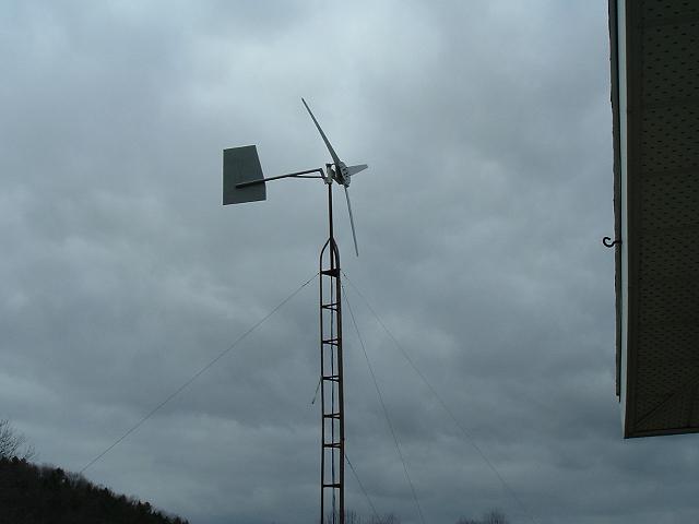

Next shot IT's IN THE AIR.....NOW IF THE WIND WOULD ONLY BLOW! 2 DAYS AND WAITING.

Don't you know? After putting up a new genny, the wind will stay dead for at least a week, hehehe :)

Good but hardly "Novel"
« Reply #2 on: January 08, 2006, 02:41:44 PM »
ubud;
and here is i think a novel way to balance I think.
I don't want to bust yer bubble here, but that method has been in use for a long long time. It is the first way I saw to do it going back at least 4 or 5 years. The mill looks very nice, by the way!

looks beautiful !
very impressive

Looks good UBUD.
Your shop is getting to look like my bedroom.
Hope the winds blow soon for you.

i use a 3ft long level-hang it from the ceiling-check to make sure its level-
then hang a blade from each end--find your lightest blade -then carve off a little from the heavy ones-rehang the blades from each end untill the level  reads level on all blades...simple and accurate..
