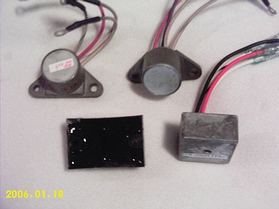

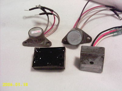

I also have some rectifiers but was going to save for use when I get to a dual rotor.
But, as I have 4 PM motors, I quess I'll use one now, for first one UP.
one is a "tympanium corp" 278000123 2300, square shape center hole.
one 27 H Q-OA, raised numbers on it 511938 with a 2 by one mnt hole.
one 19 I Q-OA, "  " 511938 with 3 by same hole. These are round w/two mnt tabs
Those three are aluminum body, and I am pretty sure for Outboard motors.
also one 369450 1 1397 rec shape plastic body potted bottom, rated at 20Amp, (marks I made a long time ago).
Also one "Diode Rectifier" it has three diodes "ZP IN 5402 9707", I think it was inboard motor.
So I quess I should use one that can be mnted to Heatsink, should all three "In" wire put but on Pos side of gen then? Or could I only use one and as I get more PM gens UP, use the other wires for their Pos. ???

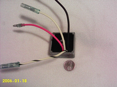

coldspot
  • Posts: 843
Re: Diode, Placement?
« Reply #14 on: January 12, 2006, 12:51:20 PM »
OOP'S-
All three aluminum Rec's have three IN wires and one out wire.
« Last Edit: January 12, 2006, 12:51:20 PM by coldspot »
« Reply #15 on: January 12, 2006, 03:50:56 PM »
The forward voltage should never go past 2V.  Something is very wrong if the forward voltage is past 1.0V per diode.
I personally believe a higher If and Vr result in a lower Vf (loss).
I never saw a 4 pin 'diode', except for monster 3-phase units used in steel mills.  3 pin diodes are usually dual diodes, like half of a bridge rectifier.
Anyway, IMHO, go for the biggest amps first, then over 50Vr.
« Last Edit: January 12, 2006, 03:50:56 PM by ghurd »

coldspot
  • Posts: 843
« Reply #20 on: January 13, 2006, 12:21:56 PM »
The diodes are standard, one in one out
the rec's are from the boating industry, inboards and outboards.
« Last Edit: January 13, 2006, 12:21:56 PM by coldspot »
$0.02

Pic from this morning.
Wouldn't any one of these be much better for the job???
The black one is new as is the square unit.
bolth round ones are used.
This is the one I'd rather use, With a heatsink.
Wire bolth yellows to Pos and just forget about the black one?

"Wire bolth yellows to Pos and just forget about the black one?"  Yes.

I just read a story about a guy getting 17 amps from an Ametek. Looked a little deeper and found a few more people claiming well over 150W. Sorry.
The 15A bridge is going to be marginal.  Keep an eye out for a bigger unit.
