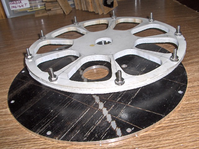

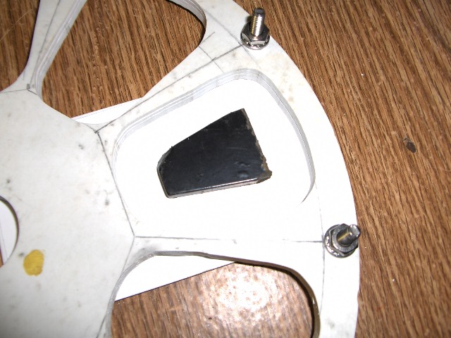

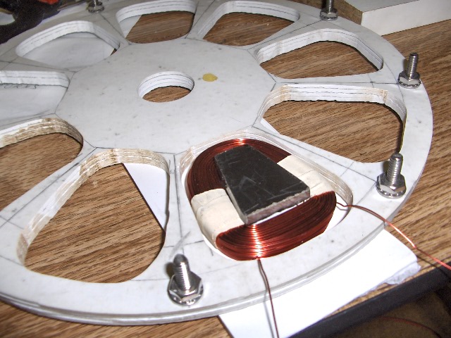

Cut the holes for the coils in the fiberglass stator wafers. The coils will be droped inplace then resen poured in and over.
This nex pix shows the magnet placement referanced to the coils.

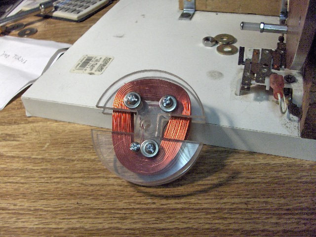

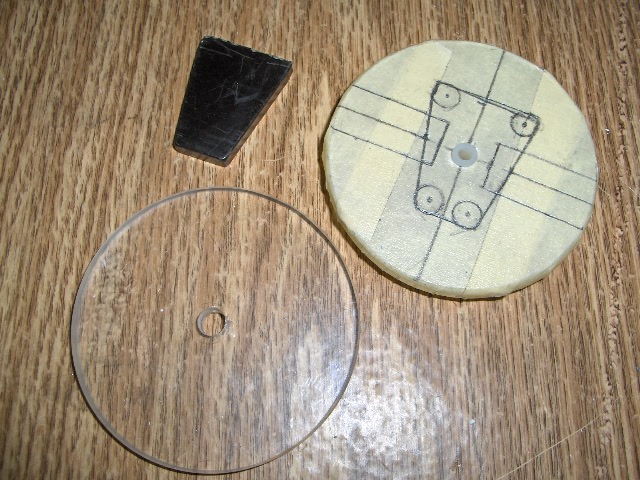

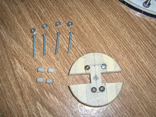

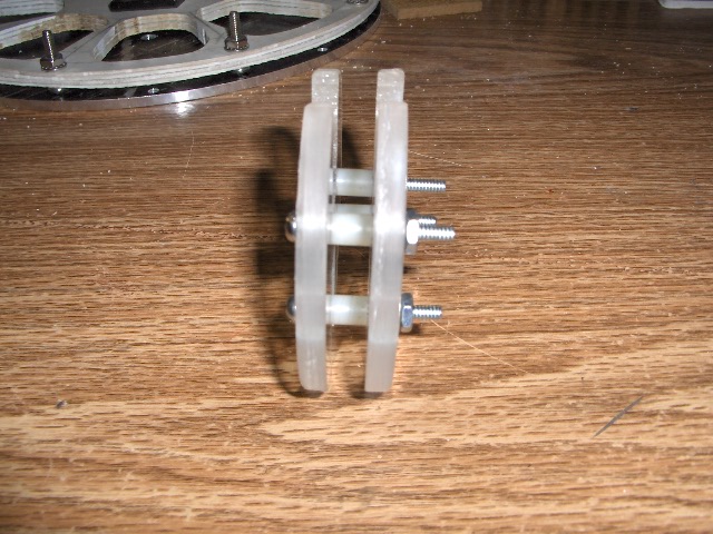

Also had time to work on the coil bobins. I'm using nylon spacers to keep the 2 bobin discs 5/16" apart (coil and stator thickness). I could find these spacers at 5/16" long. They are 1/4" OD with a hole for a #6 screw. I had some 1" long. I chucked them up in the lathe and made a set of 4 just a hair longer than 5/16".
The slightly over thickness will be squeezed out when I compress the stator and coils in the mold.
These small diameter spacers would be a problem for thick wire but I'm using #22ga. wire.
Heres some bobin parts made of plexi under construction.
Ready to assemble.

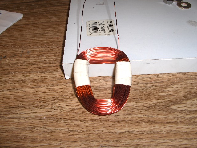

Heres a pix of the coil bobin assembled.

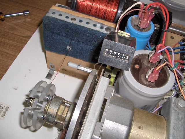

This is the coil winder I built one year ago for the Lowes ceramic dual rotor alt.
The Lowes ceramic where slightly larger then these small NEOs and they were a littel thicker also. I think the coils were around 300 turns each. I'm hopeing for around 200 turns per coil on this unit.
The turns counter realy helps. Wire tension is maintained by they 2 carpeted 2X4s that are pinched together. The winder also has a foot switch for quike start stop.
Thats it for now. I may wind some coils this weekend. I'll report on the turns count.
I'll try to get as many turns as space will allow?

The second post in the story should have read could not find 5/16" spacers. I had to make my own on the lathe.

Hi willib.
No thats the 10"X1/4" aluminum stator support plate.  I'm using 8" discs. Theres pix of the 8" discs in my diary from a few days ago.
I'll be glueing the magnets to the 8" discs in a day or 2. The 10 aluminum disc will be a good heat sink for the rectifiers.

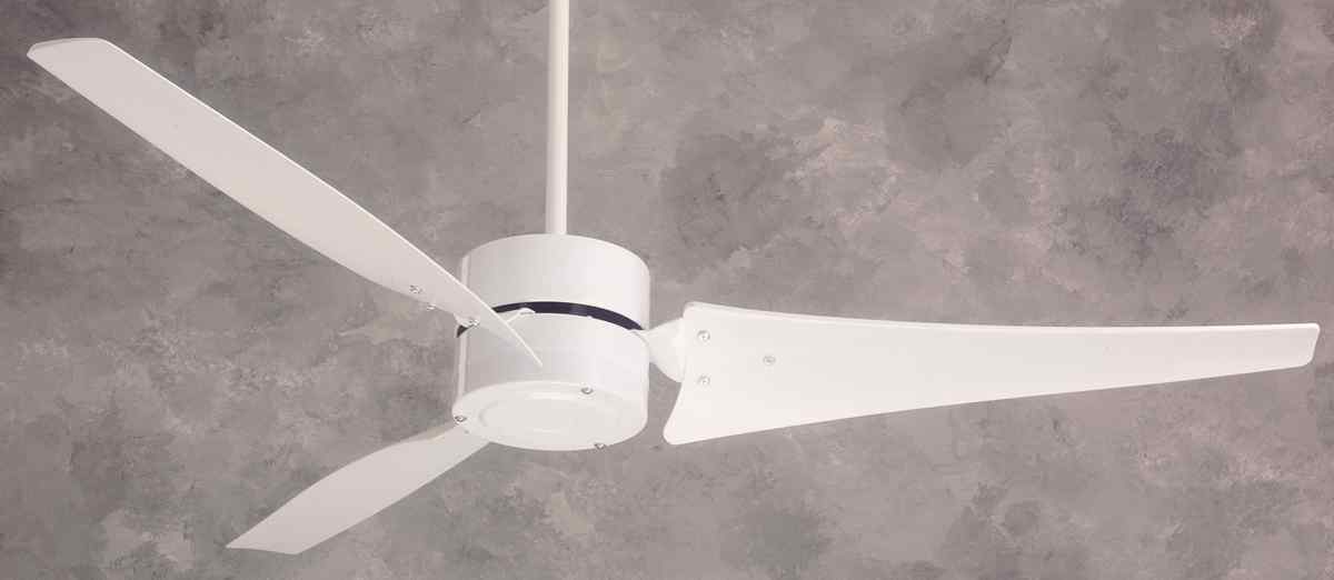

Jerry , check out these blades from home depo .
they are 60 " in dia . what do ya think?
i'm almost positive they are not metal , maybe something else?
large pic of same blade..
http://www.otherpower.com/images/scimages/2965/hf1160ww_1200.jpg

Hi Willibur;
The twist in the blades appear to be backwards for a wind generator.

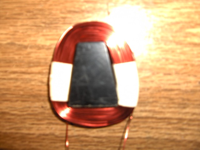

I wound the first coil today. This coil is to check for fit and how many turns fit.
At first I wound 350 turns, whoops to big. I reduced the turns to 250. Fit is good.
Coil out of bobin.
Magnet centered on coil.
This coil measures 2.8 ohms. The equivelant perelell resistance of the 9 coils is .265 ohms.
Now wind the rest of the coils.

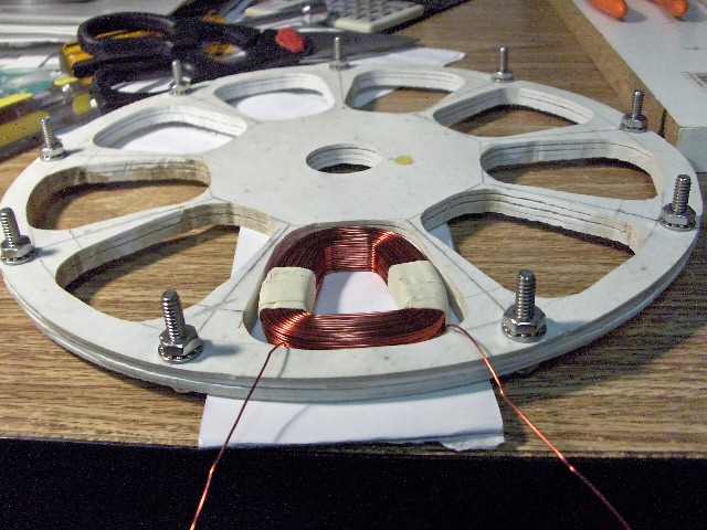

The stator is made of fiberglass sheets. The stuff shower stalls are made of. Its a littel over a 1/16" thick. The unfinished side is smooth and dull. The finished side (the water side) is very shiny but has littel bumps for a thick orange peel type finish.
We had a display project for a customer a couple years ago and I had a nice pile of 2ftX4FT scraps left over.
In this project I've stacked up 4 sheets. This gives a 5/16" thickness.
I glue 2 sheets together with a spray glue we use at the store for carpeting speaker enclosiers. Then I do the same with the other 2 sheets. Now I have 2 seperate double wafers.
I place the coils inplace and run the thin wires between these 2 sets. Then the hole assembly is placed on a board with holes that match the outer 9 mounting holes.
The reson is poured in and another board is screwed on the top compressing the hole thing. The coil wires stick out between the wafers.
This ends up making a very strong stator.
I'll post pix of the hole prosess as I go.

im deprest,my freakin coil winder broke.i was so mad that puppy went in the dumbster im going down lowes and get some parts to make a better one{no wood}how is yours comin along good im sure,by the way,where are you from?im in virginia.well going to lowes now,let me know how your genn.is doing.    para t8
« Last Edit: January 18, 2006, 10:54:26 AM by para t8 »

i got some parts and starting over again,this sucks,but im not giving up,i got a cam.but its not dig.but i can get the pic.on disc download to harddrive and attach them to my comments,at least i think it will work i havent tryed it yet,we'll see.how is your project comin along?went to matnace and got the fibber statar stuff,now i need to cut, i think ill go to matnace for that.things are going slow right now,i don't understand with all the time i got,but it will get done.i need a shop,do you have a shop?        para t8

g,thanks for that post,im working on my coil winder now,and thanks for the info on the cam.ill check it out.i wound one good coil and the winder broke,i put the glue and accelerator on it,that stuff works good,do you use glue?im also working on a 10'footer,thats at my sister's house,lots to do there,i got the mag.wire#14,i think ill be doing it the three faise way,ive seen so many ways to rectify from ac to dc,i think ill use 35to40 amp.but for now ive got other things to do first,again thanks for the help.may the wind be in your blades and the sun in your panels.  para t8
« Last Edit: January 19, 2006, 03:37:34 PM by para t8 »

I don't glue coils in the winder. Anymore. Long story, but my fingerprints have grown back.
It would be a windy day here before a 35A gets smoked in something I made. Like CNN windy!
Right before I totally give up, something works.
