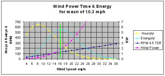

NOAA determined that our mean annual wind speed, a six-year average, is 10.3 mph. Not great wind, but enough to work with. Calculating the Rayleigh time distribution of wind speed for this mean produced some surprises. For example, I should have winds of 8 mph for more of the time, during a year, than any other speed. Interesting. Initially, I thought this meant that I needed a generator that was optimized for this speed. Wrong! I forgot about the V^3 power factor. Calculating the energy distribution for this time distribution shows that my maximum energy peak is at 16 mph. Ah, that sounds better, but this is still far off from the commercial machines that produce rated power at 25 mph or more. Obviously, I need to roll my own.
Another factor that impacts my starting point is that I already have some components I would like to use if I can. I have a set of blades (actually two sets of three blades) that are designed for 42% efficiency at a TSR of 4.5. It's hard to do much better than that. These are constructed of a tubular aluminum spar and formed aluminum skin over ribs using a high L/D (100), under-cambered airfoil (Wortmann FX 60-126). The blades have a constant 13" chord with no twist. The swept area is 201 ft^2, which is 16 ft diameter. I also have a variable pitch hub for these blades for which I intend to use active pitch control. I can already hear the groans in response to using aluminum and variable pitch. The consensus on this site seems to be that aluminum will fail from metal fatigue and variable pitch is too complicated to be practical. I have to wonder if these are the real reasons that they're rejected. In any case, we shall see. This will be a down-wind machine hence, no tail feathers.
Here's a chart showing the Rayleigh time distribution, the energy distribution, the available power from my air rotor and its RPM vs. wind speed.

Hi Samoa!
I like the way you show average energy per hour.
It shows the average wind power at 550 watts, instead of the 150 watts from the average wind speed.
Many people see the average wind speed and give up or design a poor system.
I love the 12V for the small and cheap system!
But with something using pitch control, it could be more dollar efficient to use a minorly larger turbine, and/or a 24/48V system.

Thanks ghurd. Actually, the units for the energy curve are kilowatt-hours per year but your point is still well made.
I debated the system voltage choice a lot. The major trade-off is higher transmission line losses vs. the need for a down converter to handle the 12 volt loads. KISS (more copper) won out in this case.
