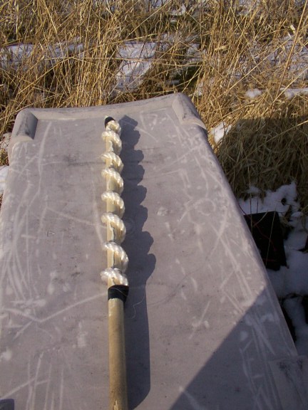

Ether way  I  needed an arguer to get the pine chips in to the fire box or pot .
I spent hours searching the web and could not find anything close to what I needed   or could afford    .
Probably one reason  why you don't here of many home brew corn or wood pellet stoves.
I wanted to stay away from  cutting piecing and welding  can be done but it's a real pain .
   And make it more of a kitchen table  project.
Here is what I have come up with so far.
That's right wood and rope and no it won't burn up as it will never see the fire directly .
The rope is 3 8 inch and the dowel is 3 /4 inch this fits nicely in an 1  1 2 pipe
  I held one end of the rope with a hose clamp an ran a bead of glue the length of the dowel .
Then coiled the rope on it and use another clamp to hold the other end  till the glue dried
Another one I am thinking about is a spring type auger using 1/ 8 inch round steel stock.
Just  wind it on a length of  1 1/ 4 pipe  then stretch it  out .

I'd be interested in how it preforms. I would think with sawdust that you'd either blow it out of the bucket, or it would build up on the bottom. I have access to enough sawdust so I was curious how well it would actually burn.
« Last Edit: February 11, 2006, 05:20:47 PM by pyrocasto »
Re: Auger prototype for corn/ pellet / wood chip
« Reply #2 on: February 11, 2006, 06:00:10 PM »
old f , that auger looks great. that's been the part thats been stumping me for a long time. i'm thinking if you used a steel cable instead of rope it would be ok if it did get a bit hot.
« Last Edit: February 11, 2006, 06:00:10 PM by electrondady1 »

I thought of that to  this was just  a quick an dirty prototype .
 What have you been planning?

If you're looking for a metal auger you might try an auger drill bit. You can get some cheap imported ones for a few bucks at places like Harbor Freight, etc.
« Last Edit: February 13, 2006, 07:53:21 AM by Chagrin »

I have come up with some thing better than rope round stove gasket you can find it in lots of different diameters.
Than use back iron pipe for the shaft it should hold up to a lot of heat. So steal away  : )
Chagrin
What I need will be 3 or 4 foot long and 1 1/ 2 inc to 3 in diameter
Thro they mite work for corn and wood pellets
