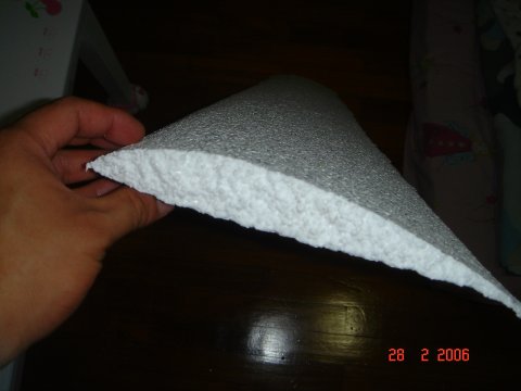

Dear Friends:
I just finished building a CNC foam cutter yesterday and wanted to try to cut a blade using it.  It turned out quite impressive.

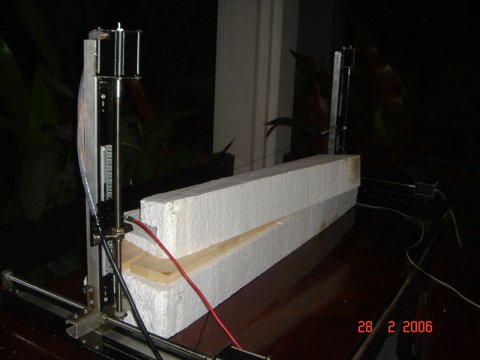

The blade was cut the way it should be except that the surface was very rough.  I think it had something to do with my temperature control on the cutting wire.  Here is a look of my machine:
The software that I am using now is a freeware and it is able to control the CNC machine to cut a twisted and tapered blade.  However the twisting angle is to be the same across the whole length of the blade.
I plan to make a set of 3 blades soon, but still can not figure what blade profile is the best for windgens.
Also I will have to cover the blade with something for reinforcement.  I am thinking of using resin and fiberglass.  I hope it will work out okay.

wow- that is nice. i wonder if it would work better to have a shorter wire, and cut the blades with the primary axis along their length? then you could have twist. you would need a good bit longer screws...

The profile in the picture appears to have undercamber or a concave shape on the bottom of airfoil.  I don't think you can make that with a wire drawn across the length of the blade.

Very nice work on the CNC machine.  Something that you might want to try, I saw someone using a pink foam, seemed to have a smoother edge than the white stuff, smaller air bubbles inside I think. The graduated-twist tapered problem, is the reason that I decided not to make one of these (that and it looked hard), though you could acheive a fairly accurate graduated-twist tapered design for a blade with one of thoes machines if you cut out many thin sections from the foam and glued them together.  That would only require only a small amount of sanding if you did the sections close enough together.

I wonder if you could attach something to the ends of your styrene  and give it a few degrees of counter twist before you cut it.  When you release it after the cut would it return to normal with a reverse twist?

I have been thinking about how to make different twisting angles accross the whole length.  One of the possibility is to make baldes into smaller segments and glue them together later on.  I think I will try this method first.

Oh , cool machine BTW,
does each side of the machine move independenly?
you are having a problem keeping the wire taught to make the twist?
here is a suggestion ,use gravity,
a weight on one side to keep the wire taught , with a bearing .
« Last Edit: February 28, 2006, 11:48:17 PM by willib »

The machine has 4 motors and they all move independently.  The wire is tie on a spring which keep it tight and straight at all time.
This machine is very easy to build.  If you are interested, take a look at www.8linx.com/cnc.  I basically copy the design from there.
