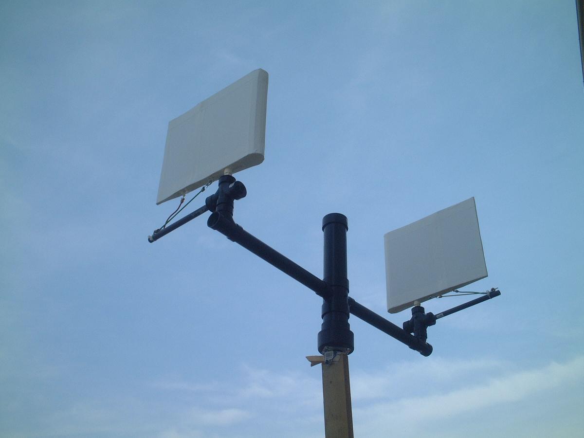

« Reply #16 on: March 25, 2006, 03:11:44 PM »
Here is a photo of Ffoeg2 the second version of a vawt with the principles that give motion to sailboats applied to a vawt.
There has been no wind for a couple of days here so no use taking any video.
All the improvements I listed in the post above have been fully implemented except #3 and 4, however I have left room to extend the boom the sail / hinge is mounted on so I can finish #3 and #4 later.
Regards
Geoff
« Last Edit: March 25, 2006, 03:11:44 PM by ffoegw »

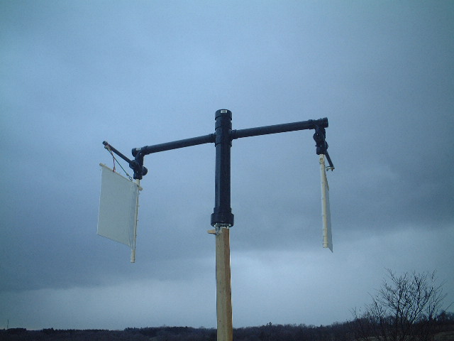

« Reply #18 on: March 31, 2006, 09:02:58 AM »
We really didn't get much wind so I decided to rebuild the sails again.
This time I made rigid airfoil shaped sails / blades after reading some of your comments and also reading up on aerodynamics.
Also #3 and #4 has been implemented however, I am back to a non gravity sail on top of spoke configuration just to see what happens.
The Ffoeg VAWT now looks like something out of Star Wars.
Supposed to be a thunderstorm this evening. with some wind?
Here is the latest photo and hope for some video later:
Regards
Geoff
« Last Edit: March 31, 2006, 09:02:58 AM by ffoegw »
Re: Photo of the Ffoeg2 mini vawt rebuild.
« Reply #19 on: March 31, 2006, 03:13:42 PM »
Geoff
  Im guessing but I think your having trouble with low wind startup.You mentioned in a earlier post that has the blades sped up the centrifical force would throw the blades out.If thats happening I cant see you getting more than 1tsr and the airfoil wouldnt help much unless the blades where fixed.
  Thats a cute little airfoil you made and is there a way you can curve it to the rotation and test?

vawtman,
Don't understand what you mean by this:
"is there a way you can curve it to the rotation and test"
Sounds interesting though.
The vawt above broke before I could take some video. The bolt which holds the caster bearings to the 2x4 came loose and it started to wobble and snapped a 1/2 ' pvc connector. Because it was connected to the spoke I had to cut of the end, splice and rebuild everything up to the sail/blade.
Any other idea's for giving me a more stable mount for the hub which I can still move around?
The vawt is presently mounted on a fence post less than 10ft from the bottom of a 3 storey building. I would like to take it out to some nearby open fields and strap it to a fence post, thats why the need for portability.
I have since fixed the vawt and tightened the bolt on the bearings.
Now have some video which I am going to post right after this.
I did move the hinge more towards the center of the sail/blade so that centrifugal force shouldn't have such a large effect. I think however this effect could be something which keeps the vawt within safety limits during very heavy winds.
Also put the sails under the spoke again. Think this gives it more stability having weight below the bearing. Would like to try an over and under the spoke sail arrangement also. Maybe later.
There does not seem to be any problem starting in low winds, in fact I am surprised how little it takes to get some rotation however, I have never put a load on it yet.
This seems to be an imrovement gained by the airfoils.
I think the radius could be increased giving the airfoil a little more time and space to get some wind glued to the sails.
I think the tsr will go a little over 1 without a load however it would become more difficult as the speed and centrifugal forces increase. I think this is a good, safe thing.
The top and bottom connection seems to be a prudent thing to do just for safety and peace of mind reasons. I will keep that in mind when I supersize.
Thanks for keeping your eye on this stuff.
Geoff
« Reply #22 on: April 01, 2006, 05:24:03 PM »
Hi Geoff
  My comment to curve the airfoil to the rotation of the turbine is just what I said.Instead of having your airfoil straight, curve it to your rotor diameter.
  Ill reply to your other questions in a bit if these pics go through.
« Last Edit: April 01, 2006, 05:24:03 PM by vawtman »
ffoegw
  • Posts: 104
« Reply #23 on: April 01, 2006, 08:14:42 PM »
vawtman,
I think that is a great idea!
Just like on conventional airplanes the underside of the airfoil is cambered to give more lift even when the angle of attack is 0.
It would be like cambering the inside edge on the vawt airfoil which now because of centrifugal forces offsetting the airfoil would continue to provide lift even a the greater rpms.
Think I'll have to try it.
thanks
Geoff
« Last Edit: April 01, 2006, 08:14:42 PM by ffoegw »
« Reply #24 on: April 01, 2006, 09:07:04 PM »
Geoff
  I struggled with low wind startup and slow speeds in low winds until I thought of this airfoil design.Sometimes it seems to be spinning with no wind.It also seems the taller the blade the more rpms in low winds.
« Last Edit: April 01, 2006, 09:07:04 PM by vawtman »

ffoegw
  • Posts: 104
« Reply #26 on: April 02, 2006, 09:13:18 AM »
Vawtman,
That was my next door neighbours suggestion.
To make the blades taller and perhaps less wide.
Geoff
« Last Edit: April 02, 2006, 09:13:18 AM by ffoegw »
